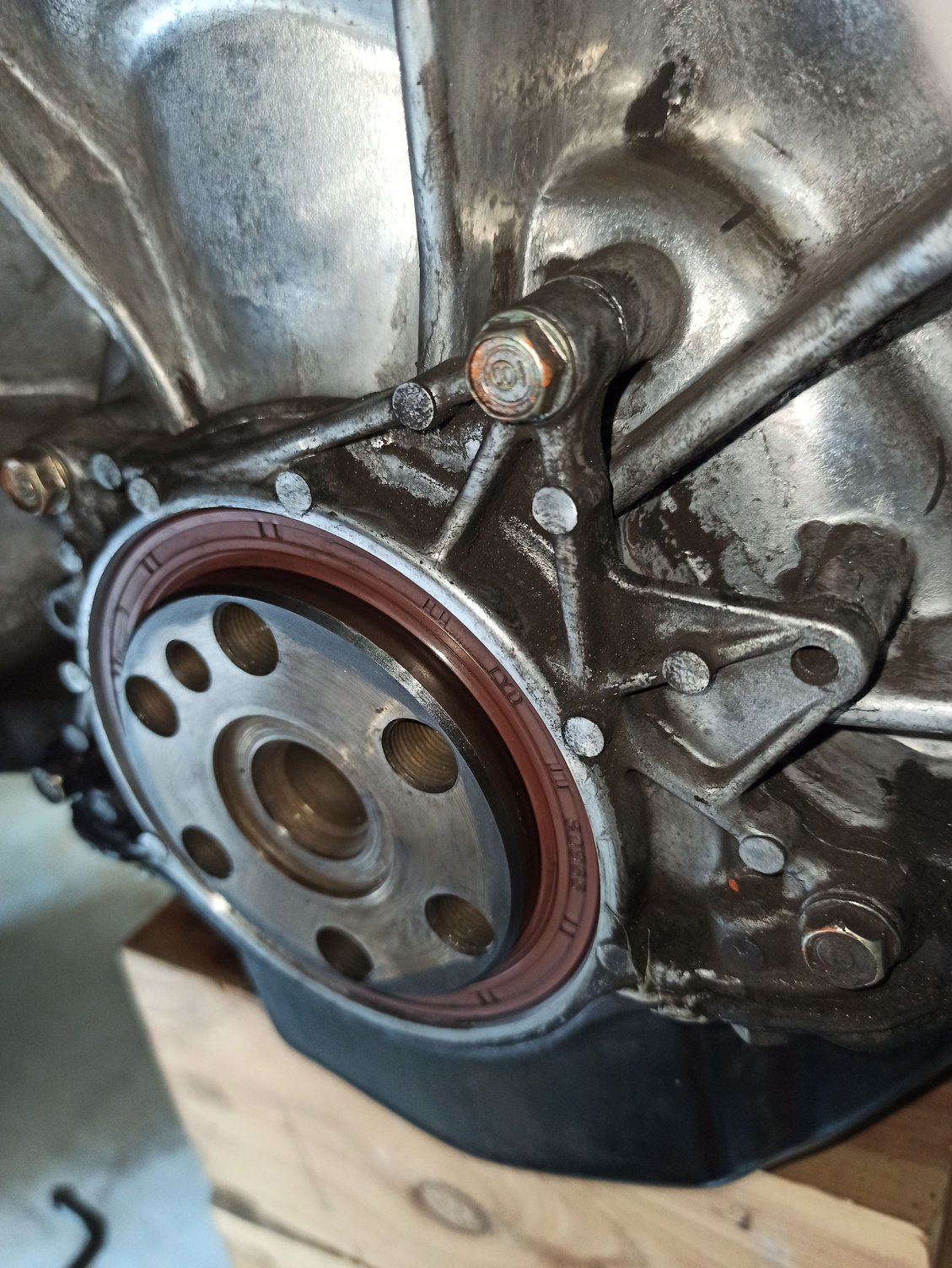

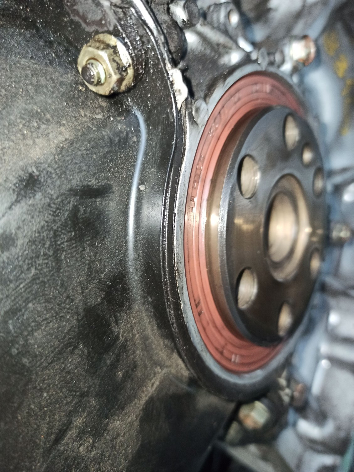

So in the process of removing my rear main seal I accidentally slightly mod the inside of the where the seal seal sits and when installing the new seal with a dead blow hammer it is now crooked with part of it further in and the rest of it flush how bad is this? I'll try and get a photo but it will be hard to show

keep pushing and adjusting depth to an even level
you are simply finding out why people pay to other people to do the job.

The side that's further in
The side that's basically flush

So Ive got it close to even by gently hitting the side that's flush further in with the deadblow and a 1/4 extension, so as long as it's even it's okay despite being fairly far in?

reinstall flywheel, clutch, trans, drive for a while and if you don't loose trans fluid, should be ok.
If you loose fluid, then no.
unless yer a professional that do many of them a week, hard to tell what is ok or not, non?
that is the life of a DIY'selfer
you won't know until you need to redo the job...
