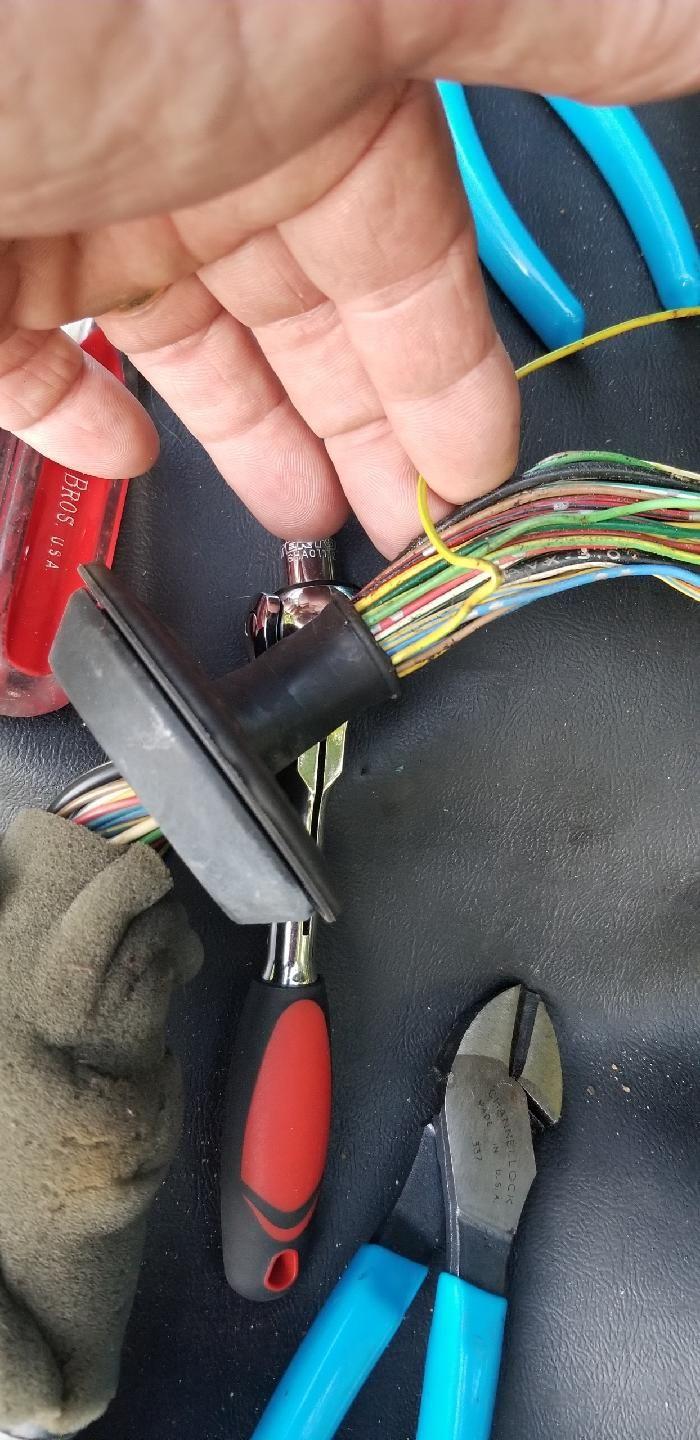

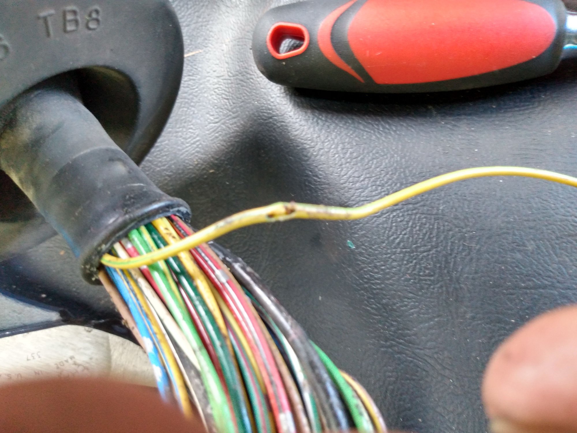

re: 2005 D17A2 Code P301 [solved]
Old Oct 12, 2021
Richard150's Avatar
Joined: Sep 2021
Posts: 20
From: Boston,MA
Richard150 is an unknown quantity at this point
There's the broken signal wire not even close to a connection. The harness takes a hard right out of the firewall and that's where the break was. Had to trim an inch off to get to good copper, but she purr's like a kitten now!
Looks almost exactly like what happened on my son's 98 Civic 😮😮😮 ... The only difference is the wire showed no signs of bending and was broken in the middle of a straight run, so I surmised it had simply broken from internal friction... It had been driving me nuts ("Tabarnac!" ), so many small wires to sift through and no idea where the break could be... I just couldn't see it and was going to quit, then my son who at that time had never had a wrench in his hands, casually glances over my shoulder, immediately singles out an orange wire with the slightest patch of exposed copper and simply says "Hey, Papa, check ça!" 😆 ...

Re: 2005 D17A2 Code P301 [solved]
Much respect to those who can troubleshoot electrical problems. Nice work!
And is that a Tekton swivel ratchet in the pics? I have all three sizes of it myself. Great tools for DIYers.
YES! Just replaced all sets and ratchets with Tekton.
