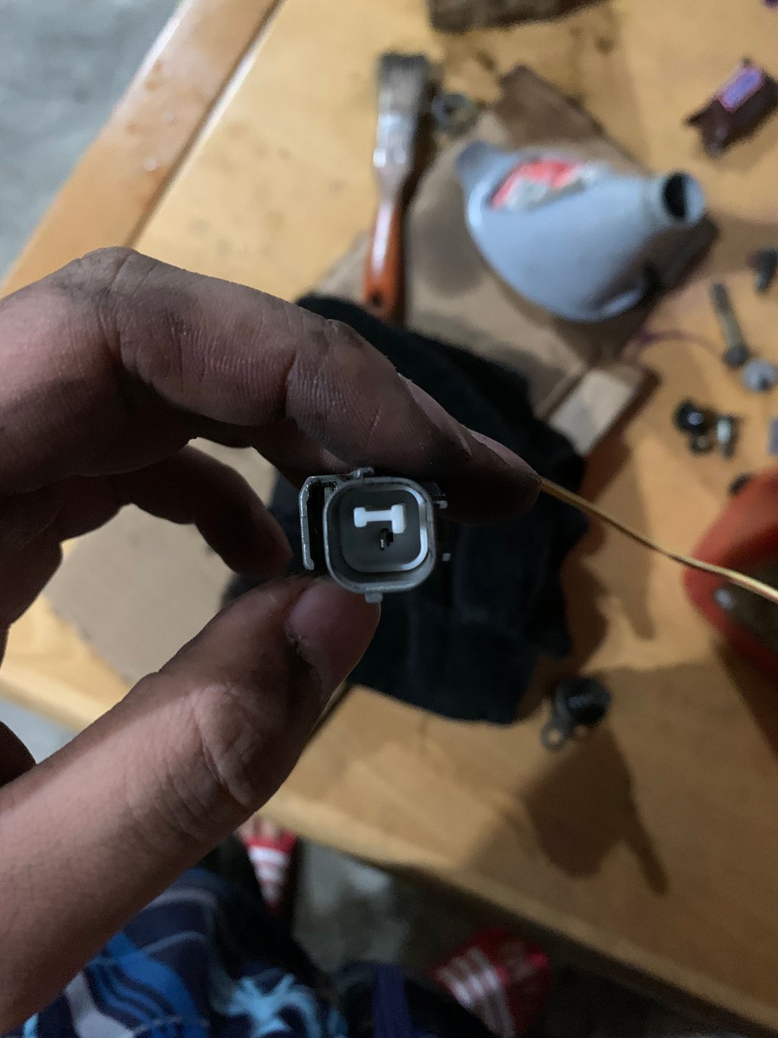

Identify this plug(05 ex civic sedan)
Old Oct 14, 2021
Frostysinco's Avatar
Joined: Dec 2020
Posts: 92
Frostysinco is an unknown quantity at this point
The connection was on the back of the intake.
Thank you in advance

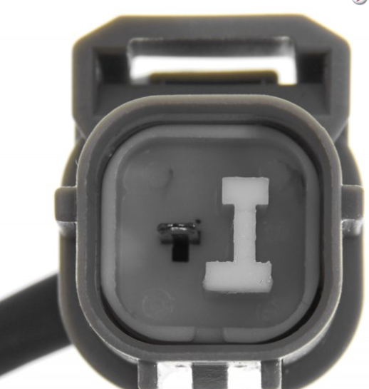

Re: Identify this plug(05 ex civic sedan)
I believe that's for the VTEC solenoid, would be back side of head on the passenger side. You should have a fault code if left unplugged.
I don’t have a code and I looked that up and that’s not it it’s one attached to the harness in the back of the intake.

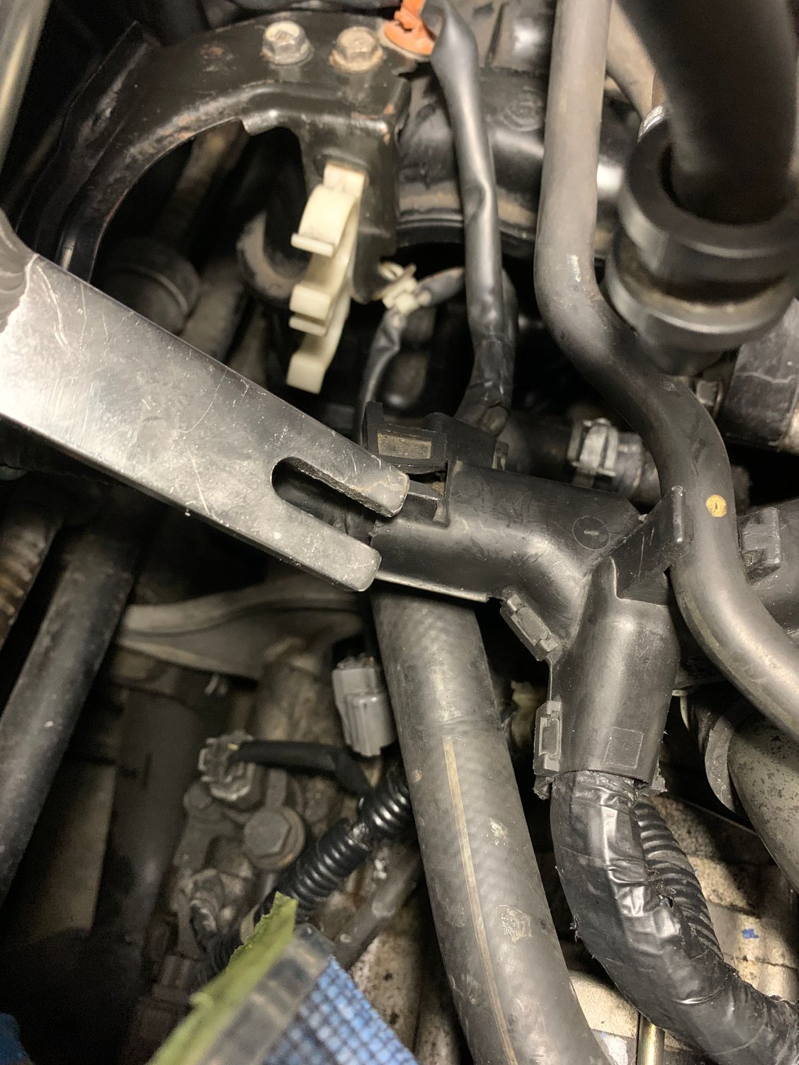

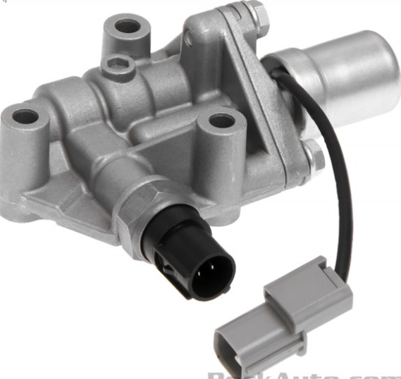

Post more pictures of where it is then. Below is a pic of the spool valve assembly. Two connectors, black one is an oil pressure switch, the gray one is for the VTEC solenoid. Gray connector looks exactly like the picture you posted. If unplugged I guess you wouldn't get a fault until it tries to engage VTEC.
do you know if it has anything to do with why it cranks starts then dies?
That's right around where I would expect to find the VTEC solenoid connector.
If unplugged the engine should still run. Possibly limp mode or just no VTEC and a MIL. Would not cause it to start then die.
okay I don’t have a vtec solenoid there and not sure if I even have a vtec engine, there is three screw holes there tho like there used to be something there.
