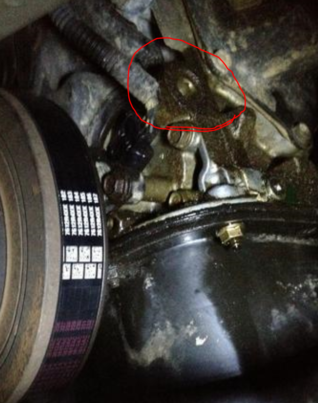

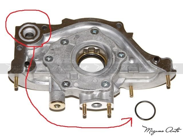

How many miles does your Civic have? Unless it's 400k+, you're likely not going to need piston rings and rod bearings replaced. If it were me I'd be fixing the oil leak and letting the rest go.
If it's the oil pump seal it would be leaking from the area circled in red in the below pic. It would then run down the block and look like an oil pan leak. You can clean this area really well then monitor. Some people put flour down to help pinpoint. You can see that area is a shinier color from the leaking oil, the oil pan gasket is also shiny with oil from the above leak.
Here is where the oil seal is. This is looking at the oil pump from the engine side. The red circled above is this same area.

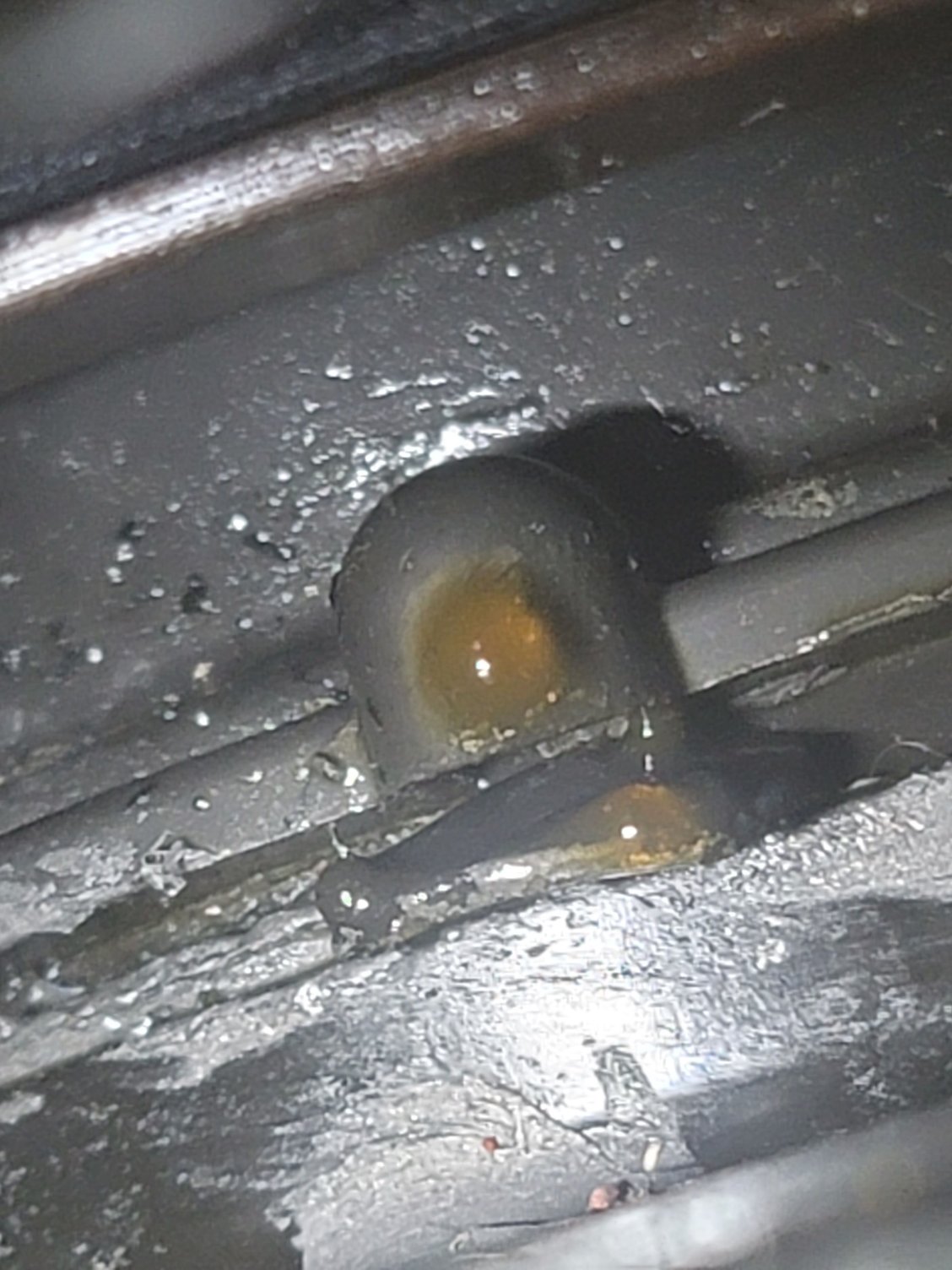

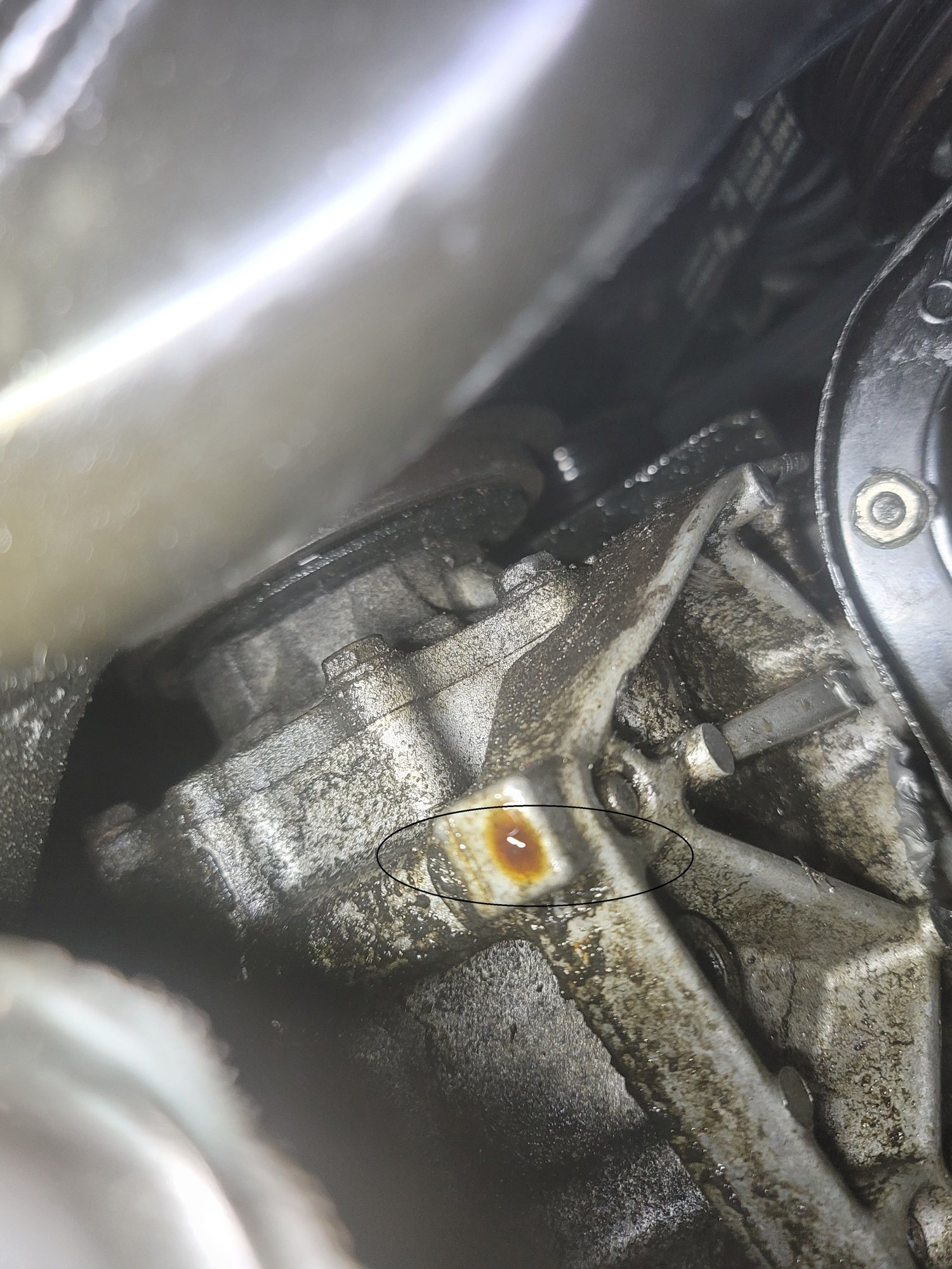

Thanks again for the help and advice. Ok, here are the facts:
1) I put new oil in and put uv dye in too (that is why the oil in the pcs has a yellow tint).
2) I looked all around the oil pan and there is no oil with UV dye. So that is fixed.
3) I only saw it in two places. first photo is crank shaft. the second one has me stumped.
any advice / insight is welcomed!

Re: Civic 02LX SOHC Automatic Oil leak
I can understand that to repair this properly, having the engine block out and flipped upside down with nothing in the way would be WAY easier. However, that's a hell of a lot of work for one threaded hole.
If the hole isn't on a corner, i think you could get away with smearing a SMALL amount of RTV in the area that won't be clamped down because of the broken bolt/stud. If you put too much on, it could make the gasket surface too uneven and allow for leaks. I believe the clamping force of the surrounding fasteners along with properly applied RTV sealant in that one area might just be ok.
However, now that you've done some drilling you'll have to ensure that the sealing surfaces are still flat. Make sure there aren't any burrs or roughness that will allow for oil leakage.
