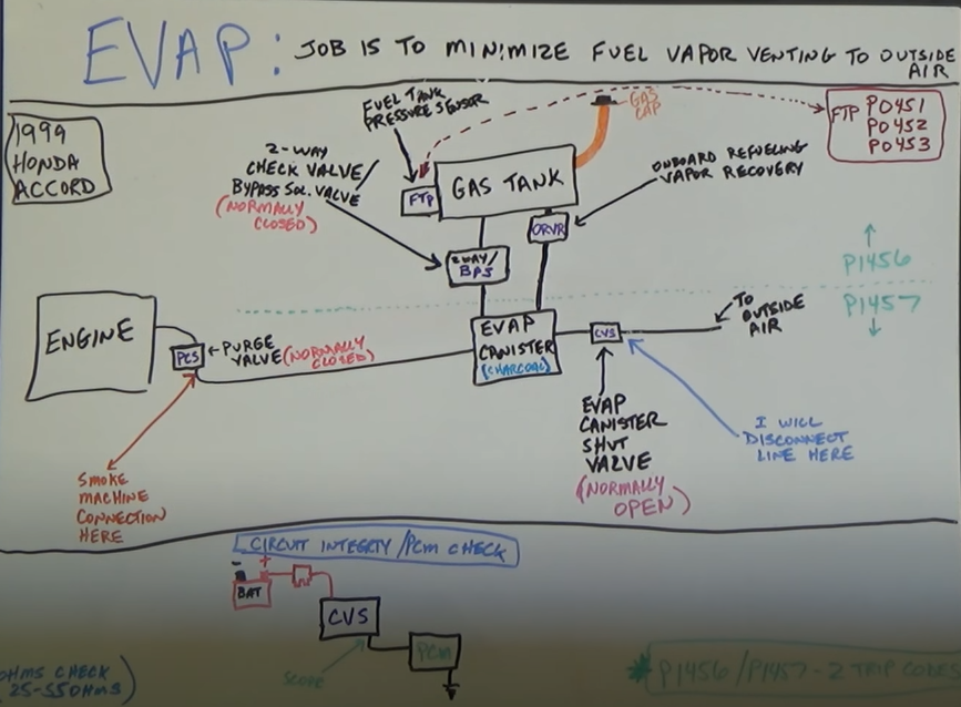

re: Is p1457 realistically ever the the fuel cap?
It's not the fuel cap. Here's a good pic trying to show where in the system each fault would point to (stolen from the Youtube video link below). This is based on an Accord but the system is similar in design. A popular cause of the fault is the canister shut valve (CSV), usually on rust belt Civics though.
Thanks but unfortunately I replaced that already and cleared the code like I mentioned above and the issue remains. I called it the two-way vent though.

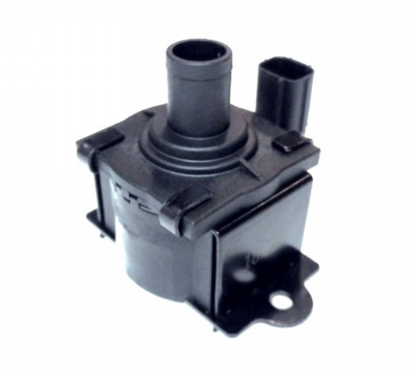

Did it look like this? Because it sounds like you replaced the 2-way bypass solenoid valve.
Yes that is the part. Sorry i'm getting confused by the names. Changed that and went to recheck this afternoon; all the hoses around the canister and everything else feels and looks sound. I used a Dorman 911-762 or canister vent solenoid but it had good reviews. I might shell out some extra money for a genuine part but I doubt it will matter.

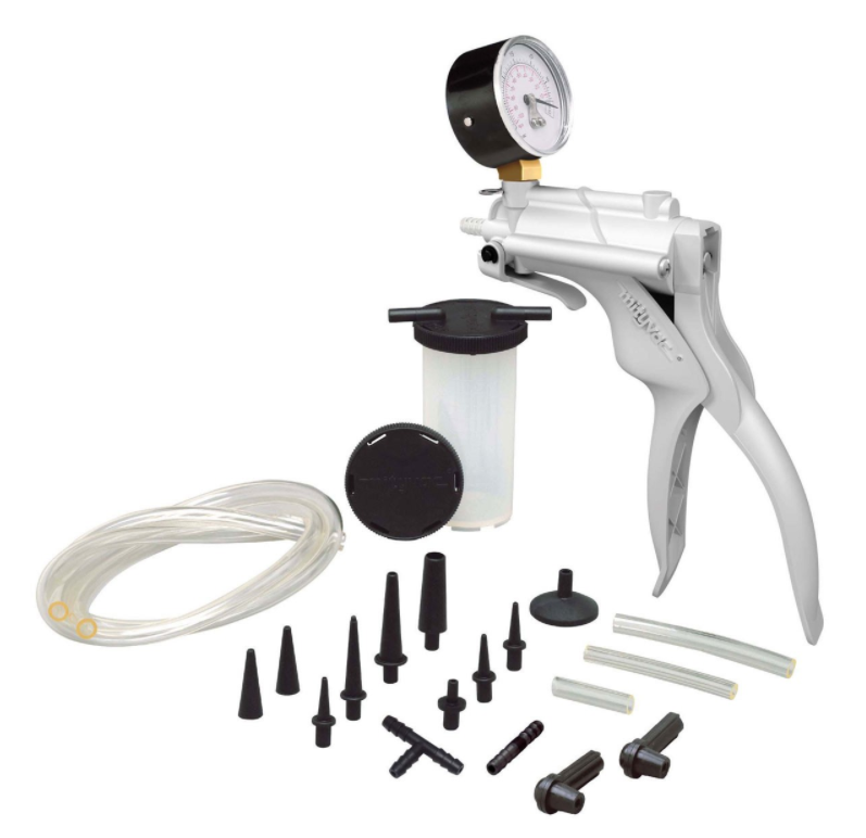

I would not recommend just replacing parts without troubleshooting first. If you have a hand vacuum pump/gauge there is some easy testing you can do. Another possibility is the EVAP purge valve up on the intake manifold. The last P1457 I troubleshot I found this valve was chocked full of mud. Once cleaned I found the valve was stuck open causing a leak.

Probably just a coincidence I would guess. If you change your mind and want to troubleshoot let us know. Using a vacuum pump and a multimeter you can get pretty far.

Re: Is p1457 realistically ever the the fuel cap?
I can't remember what has to be removed to get to it, I think just the air box where the air filter is. The purge valve should have two hoses and one connector. One hose leads to the throttle body/intake manifold and the other goes to the firewall and eventually back to the canister.
One of the first troubleshooting steps is to check that valve. It is normally closed so if you get to it, take the hose off that leads to the canister then try to suck air through the valve. You should not be able to. This is easier and not as gross if using a vacuum pump/gauge. As I stated previously this was the cause of the last P1457 I looked at. The valve was stuck open meaning the evap system was leaking through it.

Found the part. Its not difficult to get to I think it only requires me to remove the air cleaner element. The part is showing at this
link link
. I will let you know how it goes.
I changed the Cannister Purge Valve this weekend. Air filter screws were difficult but other than that it was a fairly easy replacement. Drove for 100 miles and no code. Took it to get the car smogged today. Special thanks to BrotatoChip!
