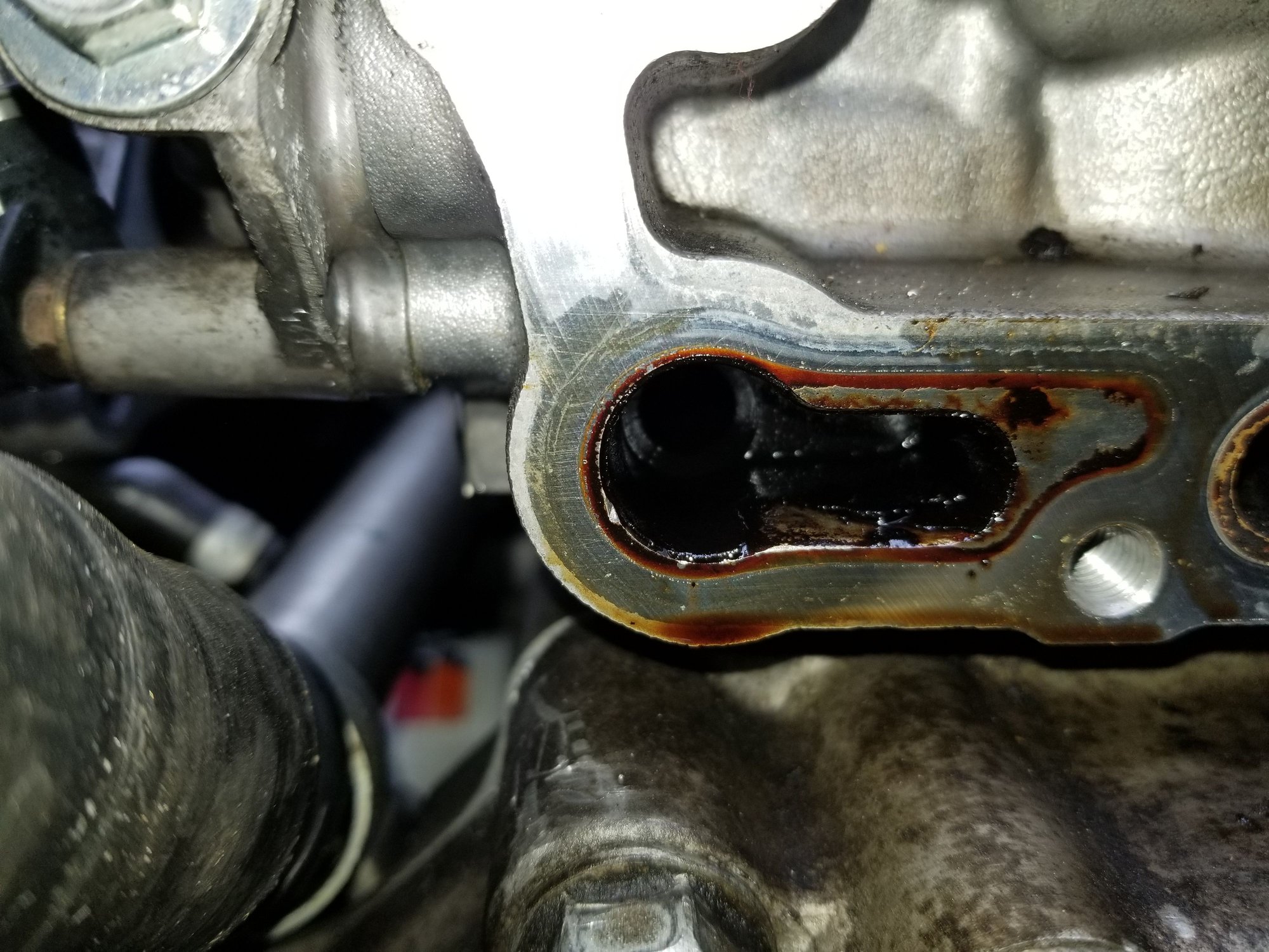

Just discovered this while I was tearing the engine down. It the EGR intake port on the Head. The engine came with a EGR but my old engine didn't have one. I replaced the Water Outlet with one that has no EGR. There was oil there and I cleaned it out. The intake ports are all dry. I dont have any experience with EGRs on this motor so I am wondering if this is normal or a problem.

Rep Power: 224
Re: Can I reuse a pretty much new Head Gasket (I know it sounds)
Some have EGR and some do not, I don't think we ever truly figured out which do. You did the correct thing though, swap the non-EGR parts onto the replacement engine.
Yeah I'm just concerned with that oil in there. Not sure if it belongs there or not and can't seem to find any info on it. I'm wondering if it's coming from the VTech solenoid, but it's not active so I dont know.

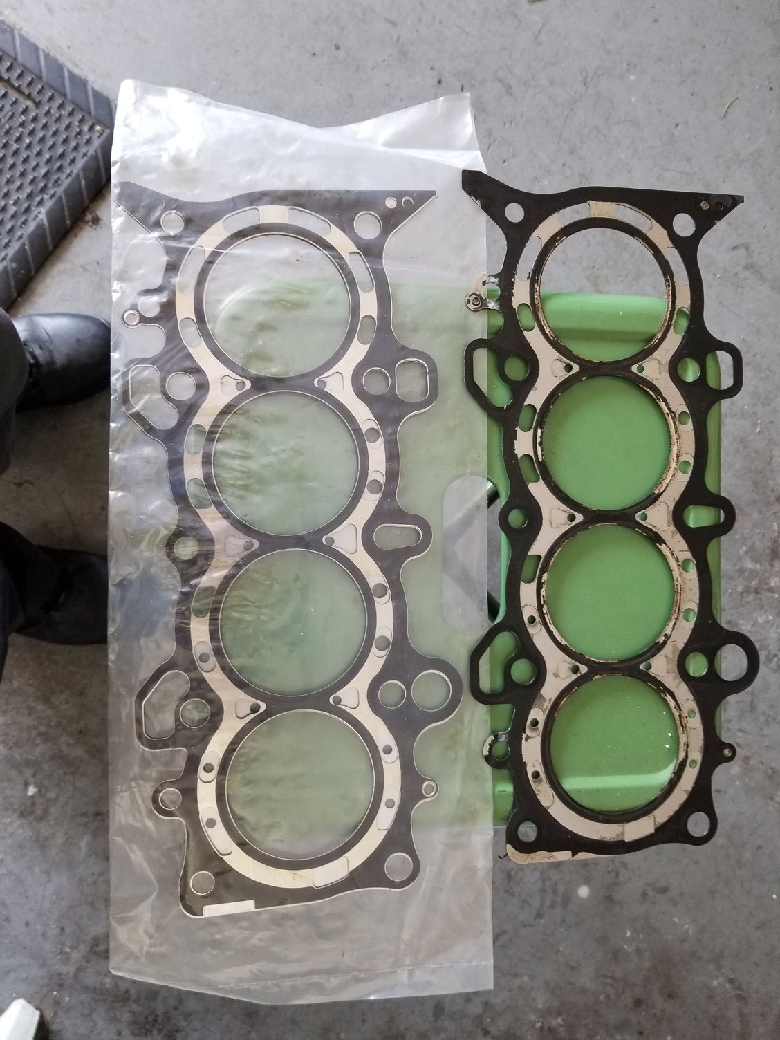

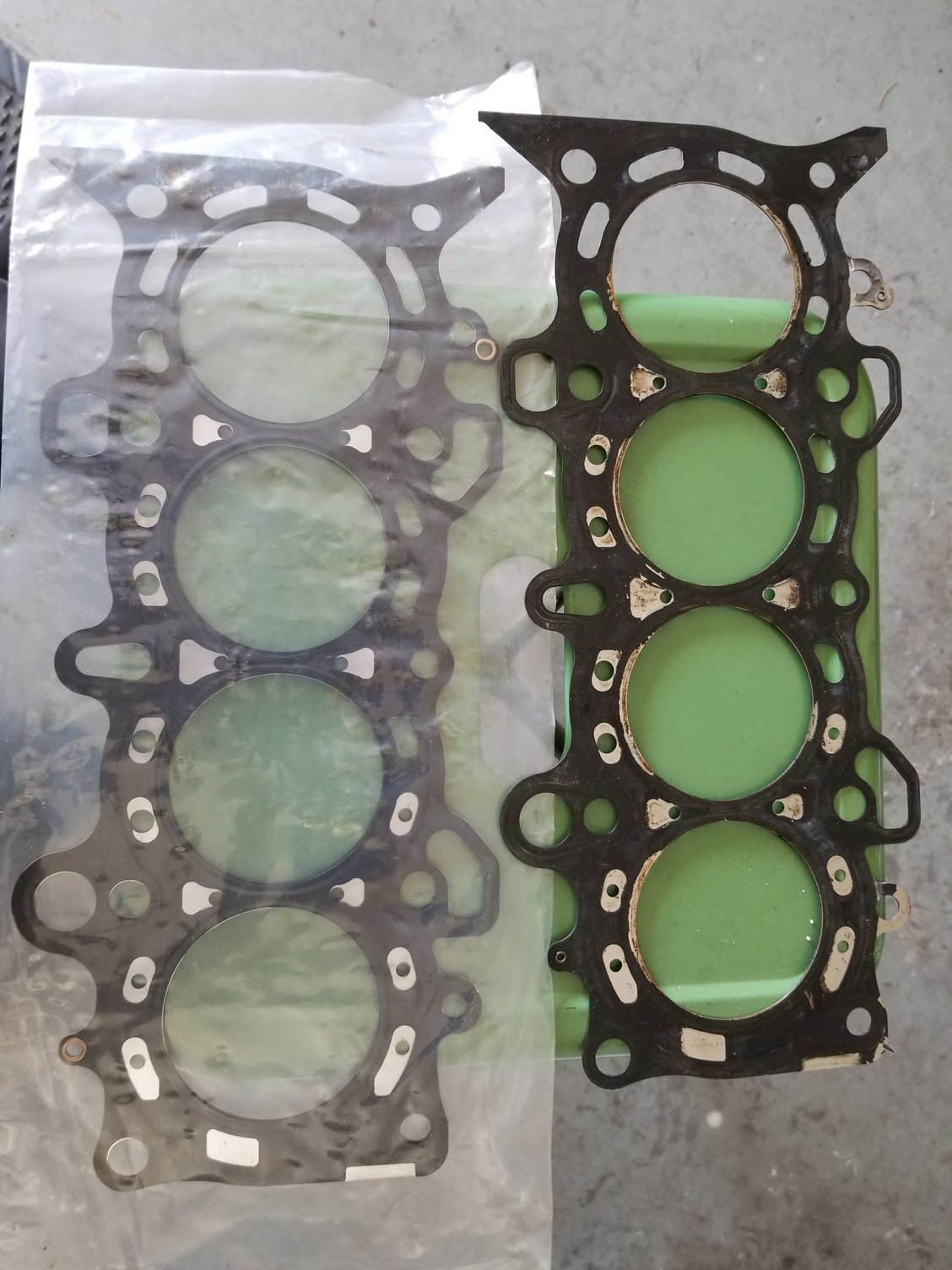

So definitely a bad HG. I decided to not reuse the Honda HG from the other motor. However I had this Vincos one from a gasket set I had lying around and it looks identical to the Honda one at you can see. It weighs .03 grams more, I think because those rivets on the outside are a tad bigger. The coating appears to be the same thickness also. So I think I am gonna give it a go. My luck's got to change at some point, yeah? Lol!
