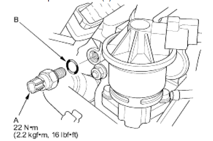

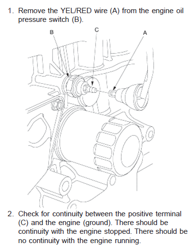

I honestly don't even remember seeing the pressure sensor where a parts catalog is showing it, been a while since I've worked on a D17, but it does give a few steps on testing it. It says it should have continuity when the engine isn't running, normally closed. Don't understand why the D17A wouldn't have it.

Cool, thank you for your help. I guess I could try grounding that pin with a test light and seeing if the code comes back. I'm not sure why the JDM engines don't have the pressure switch but none of them do that I know of, they just have a plug in the hole instead. My JDM K24A is the same way. Maybe US emissions regulations require verifying the functionality of the system or something, not sure.

Thank you for your help. The VTEC solenoid pressure switch must be normally closed because when I ground that pin on the ECU it doesn't set that code. Next time I am at the junkyard I will grab a pressure switch and wire it in since I will eventually need it to keep the USDM ECU happy. I'm glad I found that ECU because the 04-05 Civic 5 speed VTEC is not at all easy to find in junkyards, at least where I live.
