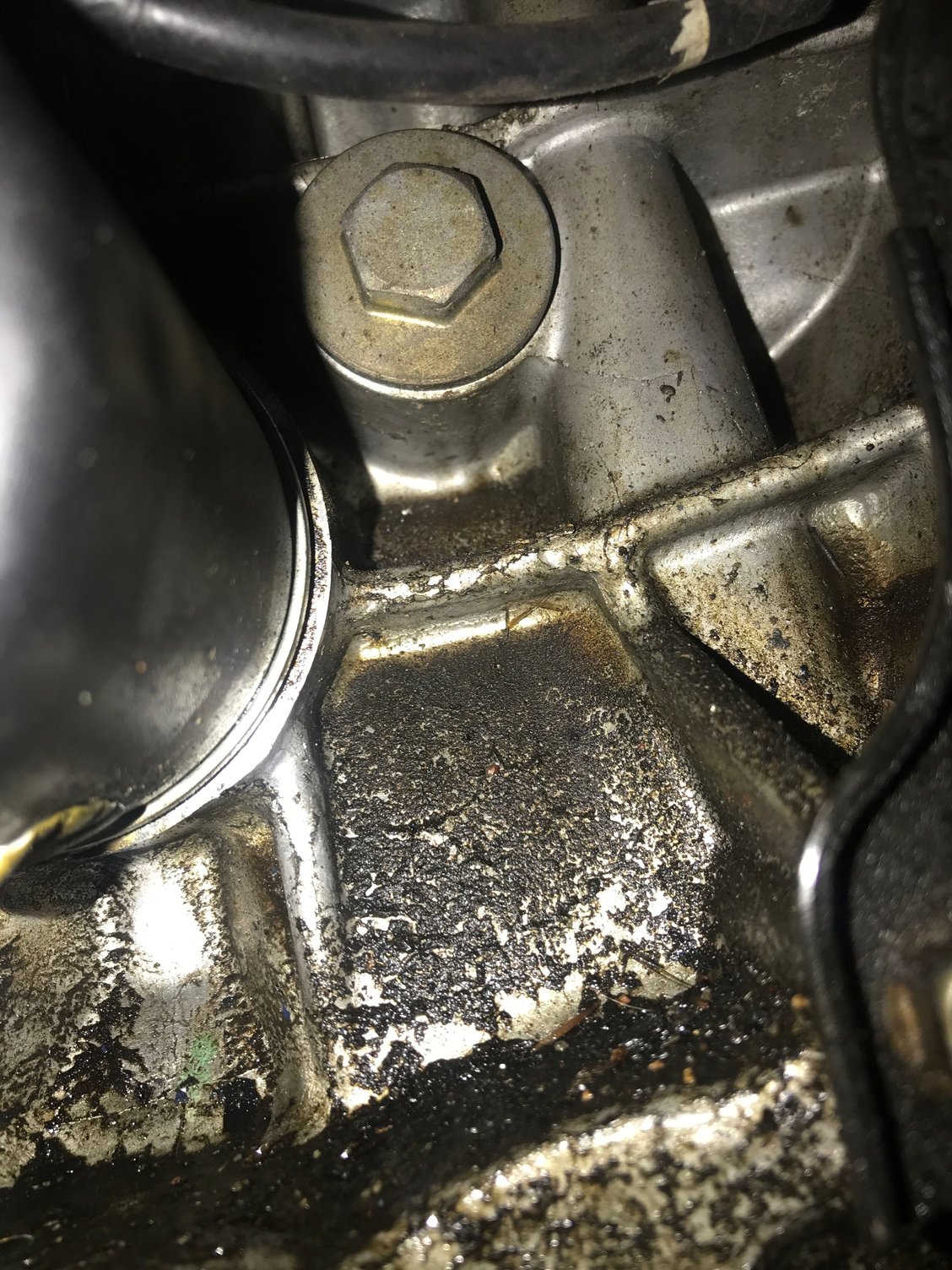

Hey guys! Well as the proud owner of an ‘05 SOHC Civic I have reached my knowledge limit on what could be my problem so, here I return to the fountain of knowledge. At 227,554 miles just did a valve lash adjustment trying to quiet a horrible valve train knock/tick alleviated some of the problems but it’s still there also did an oil change as it was due. Now with all of 10 minutes of run time my oil light is coming on. So am I looking an oil pump replacement, valve job, or engine replacement? Attached video for engine sound and pics for observed oil leak. Any and all suggestions, ridicule, and harassment will be greatly appreciated

check if oil levels still acceptable.
if low, remove filter and make sure it have only one seal

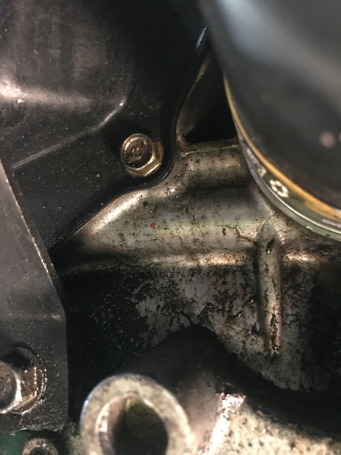

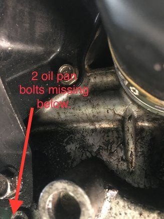

Thanks @sdaidoji. Well after taking your suggestion, no 2nd seal but, I am missing 2 oil pan bolts located right where I am assuming the oil pump exits at so hopefully this solves that problem. Now on to the most confusing and unbelievable fix for the mysterious knock/tick. Anybody wanna take a wild a$$ guess? Answer reveal this evening. 🤔😂

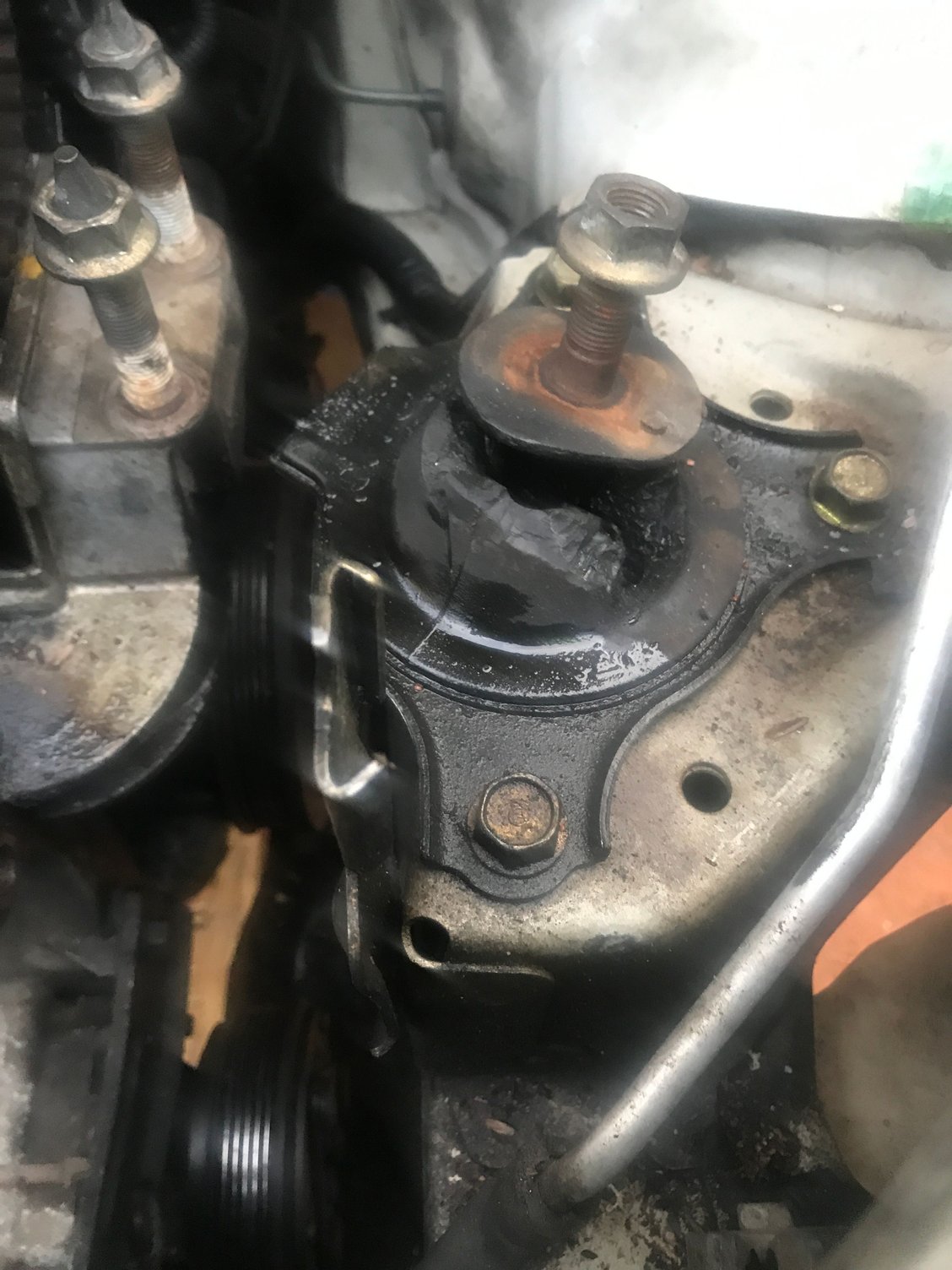

@sdaidoji I have discovered another major malfunction. Which is why I have been doing all this work myself instead of taking my car back to this “good” mechanic.

yeouch!
yep, mounts do that from time to time

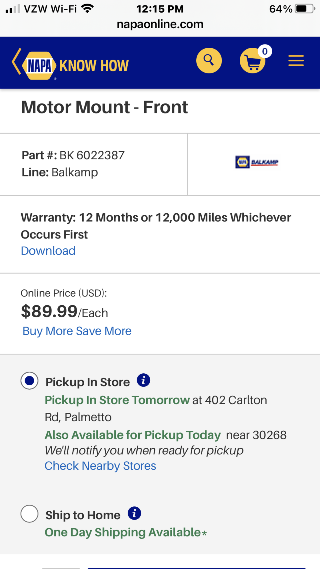

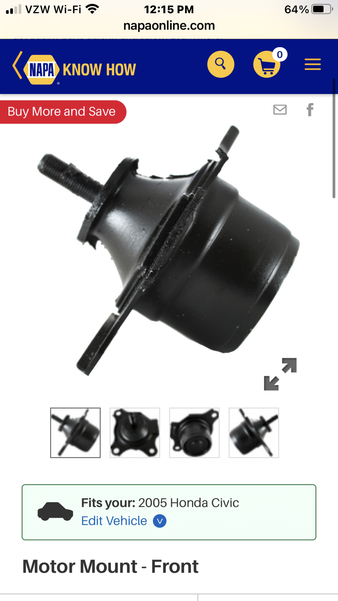

Ok having to scramble a bit, anyone have thoughts/opinions on using a balkamp motor mount instead of the toukai oe one?

Never heard of that brand, what are your other options?

0 options gotta get it back on the road today.
