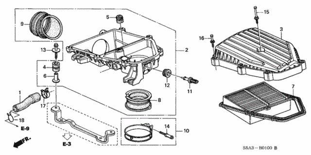

Also, it's pretty easy to replace the filter housing. Two bolts holding it down on the front side of the filter box, the hose clamp for the breather tube, the hose clamp for the rubber hose connecting to the resonator box, and the hose clamp connecting the filter box to the throttle body. The bigger resonator box that sits forward of it has like.. 4 bolts holding it down. Hardest part is reaching that throttle body hose clamp. Here's a parts diagram for reference

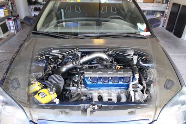

big facts on that intake tube like colin said though. Short ram intake or cold air intake. Short ram takes suction around the same area as stock, cold air routes piping to the bumper forward of the wheelwell to take a suction there. Given you live in Seattle, I'd go with a short ram over cold air intake because of rain. It does make the engine sound a hair louder, I should add.
here's what that mine looked like (don't mind the photoshop job I did with the hood. lol). Makes other things easier access in the engine bay if you DIY your car maintenance. The filter I had was also a washable dry filter (some aftermarket intakes you have to oil the filter).
Wow, thanks for that diagram. I don't think I want to try replacing the housing as I will likely mess things up even worse, but it's nice to know for reference. And maybe I can find some of those bolts that are now all rusted.
The intake tube looks cool also and I might have done it were I more mechanically inclined and experienced and my Civic not so old. I am amazed by how clean and nice your engine bay looks. After a few years of parking outdoors in Chicago and NYC, my entire engine bay is covered in a light coating of rust.
