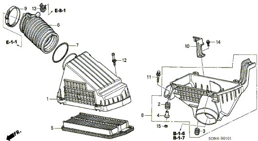

i took out the resonator too, and left the stock air inlet. in the resonator's place i made a tube with two 90degree bends that connects the airbox with the airinlet. no loss of torque, suckingin air from behind the headlight, not super loud at WOT like w/o resonaotor, but it is growlier, i like it. it feels the same as stock.
without the resontaor box it may give you a great sound a good flow to the filter at high revs but its still sucking in hot air. also, i felt a flat throttle response from it and since it doesnt give much more air velocity, low=end torque suffers. my pipe kinda gets rid of that.
i had a talk with boilermaker on his integra airbox adapt to his civic and looking at my mom's 7thgen Accord V6 it looks like it may fit also, but it is really big. it uses the same screen-type filter as our civics, but is bigger and the air inlet is like almost twice the size of the civics. plus, the air inlet is facing downward so that could be beneficial. i would have to adapt the larger TB openign on the aribox to the smaller oneon our civics and solve the problem of the up-ward facing TB. and since the accord's engine faces the other way compared to ours, ill have to do that too.
heres a pic of the stock 7thgen Accord V6 airbox.
