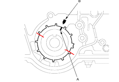

Find where the crank is now, slap the crank timing belt pulley on if you removed it. Also, remove the spark plugs if you haven't already. Line up the mark on the pulley with whichever red line it is closest to (pic below). It doesn't matter if you rotate it clockwise or counter-clockwise, turn it either way to whichever line is closest. Doing this will put all pistons at about half way and ensures they won't hit valves. Still, rotate the crank slowly. If you feel resistance do not force it, it should turn fairly easy. Next set the camshaft at TDC, you can again rotate whichever direction you please. With the cam at TDC now set the crank as well. When you do this you want to rotate whichever direction is closer. If you have the crank lined up with the red line on the left then rotate clockwise, if it's on the right rotate counter-clockwise.
The "never rotate clockwise" thing is only relevant when the timing belt is on. If you rotate clockwise then it can cause the timing belt to jump teeth on one of the pulleys.
