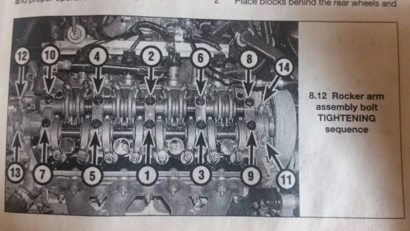

8mm bolts 14 ft-lb
6mm bolts 8.7 ft-lb
Draw all down slow and even, 2 turns at a time, so nothing gets bent
Probably oil the bolt threads and stuff like that.....
Use sealant under the outermost caps that will be exposed to the outside--per the shop manual.
Sequence...start in the center, work your way outwards, crisscrossing as you go outward (pretty much the same type of sequence as any other large item like a cylinder head LOL)

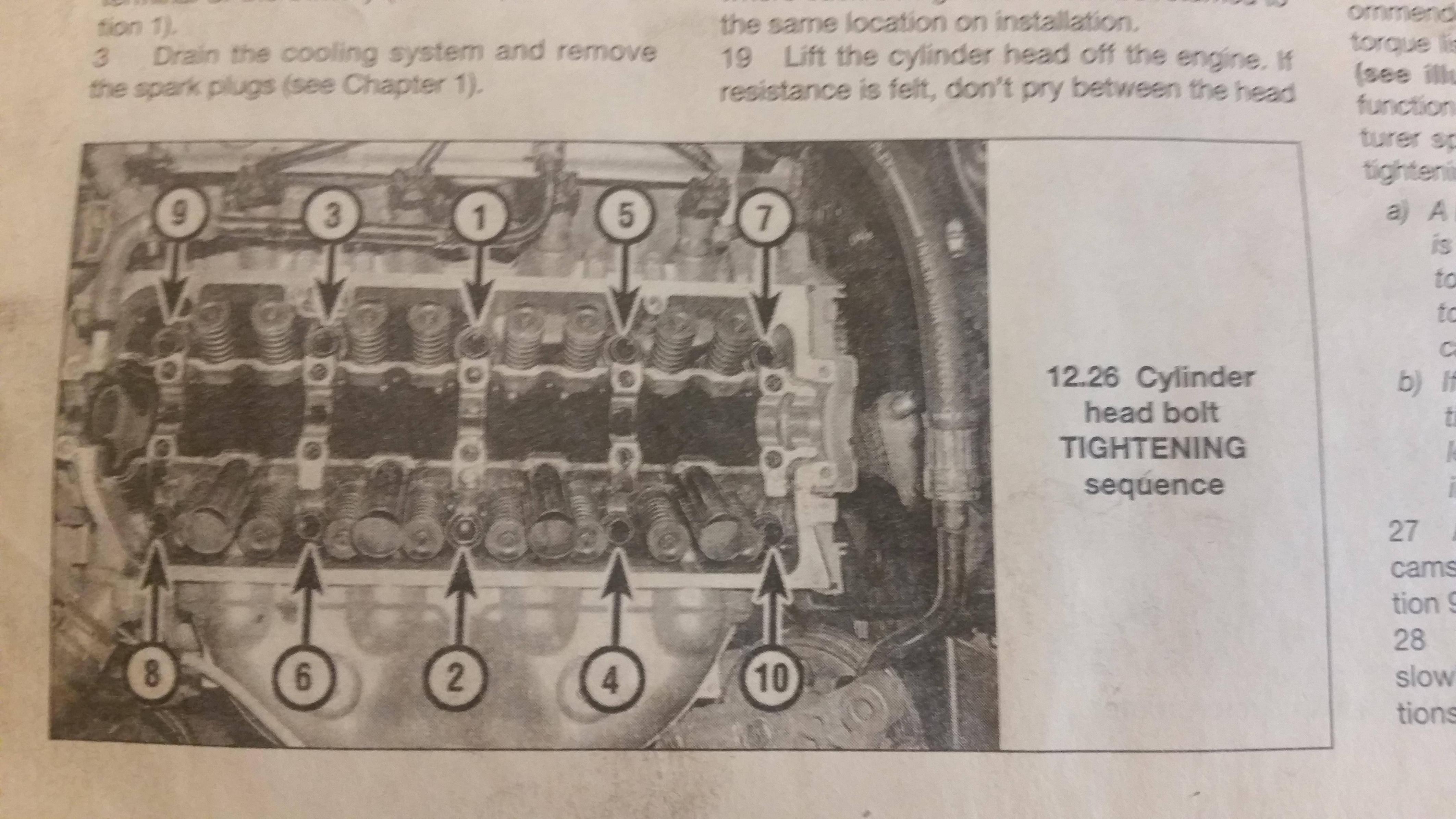

head bolts - 3 steps, 14, 36, 49

6mm bolts: 104 in-lbs (8.67 ft-lbs)
8mm bolts: 14 ft-lbs (168 in-lbs)
edit: seems like he beat me by mere seconds.. lol. Had to go to my car and grab my manual

8mm bolts 14 ft-lb
6mm bolts 8.7 ft-lb

head bolts - 3 steps, 14, 36, 49 ft-lb
This random google pic is probably close enough

edit 2: pic from the manual, if you prefer that over random google pic.
same pattern. If you really wanna be a stickler for details, the random google pic is flipped front to back than the manual, but it really makes zero difference which you do.

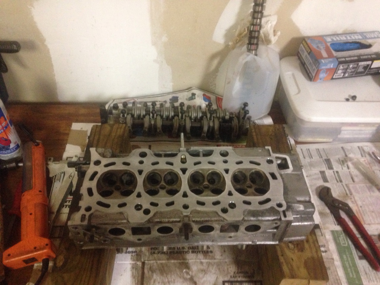

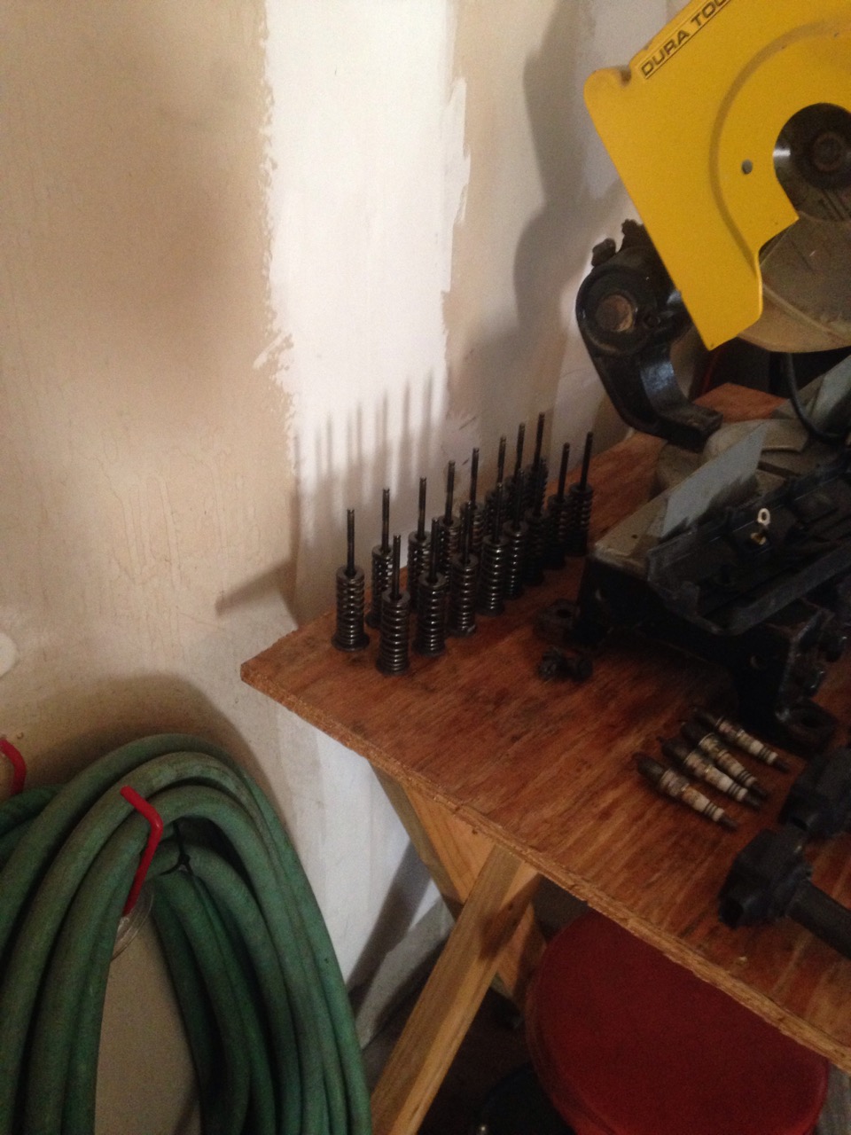

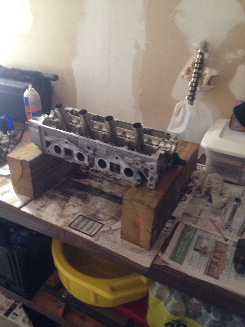

little update.. thanks for all the help ezone...
head had no warpage using straightedge even .03m feeler gauge wouldnt pass thru..
I still sanded it down with 120 grit , on a block of granite i got to even out imperfections... old scholl style baby...
valve job i will reseat them with valve grinding compound that tool and a drill.. off course i would check for leaks with gasoline...
waiting on valves cheapos i bought will see , they should hold up for beat down..
I regret not doing the d17a2 swap, .. it would have cost me more, and more time till i figured out all details.. though it looked pretty simple..
but i figured maybe i will throw some nitrus to play around on the road.. cheap add of power.. no more than 50 shot. in the future..
here are some pics..

Re: 2005 honda civic cam torque procedure
This head needs a glass smooth finish to seal correctly.
15-30RA (roughness average).
This ain't the place for old school. The factory MLS head gasket can't seal scratches and imperfections the way a composite head gasket used to be able to. The belt sander finish that worked fine on cast iron heads only causes problems here.
All you really needed to do was wipe it down with some brake cleaner.
Maybe scrape the black stuff with a single edge razor blade.
Throw some wet 2000 grit on the marble slab and grind a little more?
