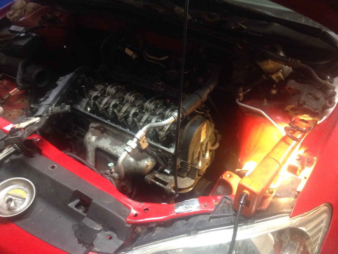

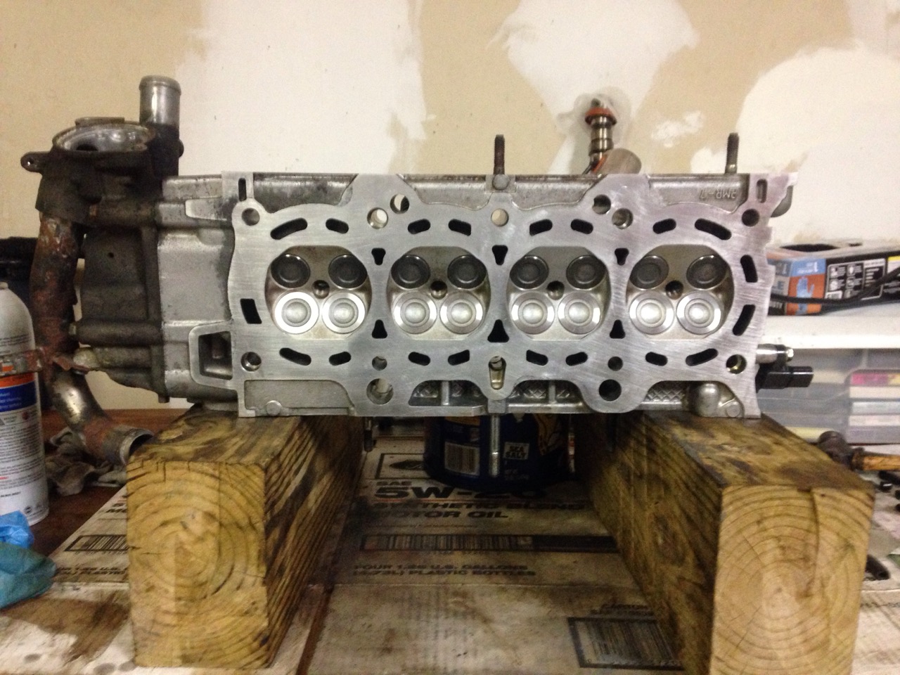

some updates.. i lapped the valves, and putting the head back together..
no leaks from valves.
I also painted and cleaned the rust from the water passage pipe..
kinda getting everything together to slap it together..
few thing:
it bothers me my dream crashed of driving this car to 500,000 without openning of engine, all due to bolt of cam gear coming off after 2 years after my timing belt... freak accident and i torqued it.. torque stic was off less then 1% i just checked it. I am gonna use locktite red this time...
I am thinking bying a 50 shot nitrus to play around since i have good new head..
I am gonna get second vehicle first .. so i wont be hussling like this.
some pics

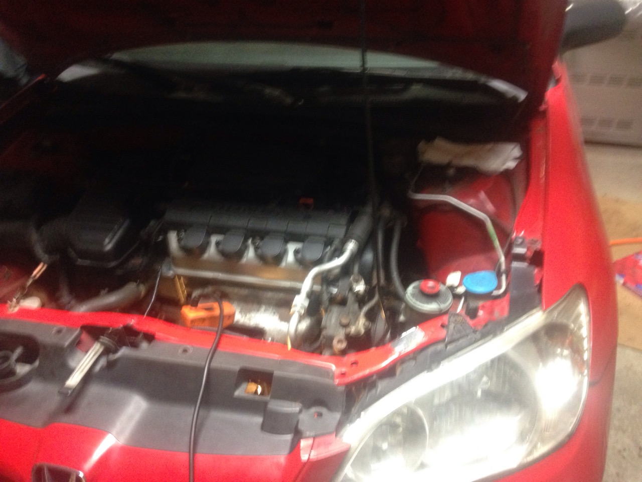

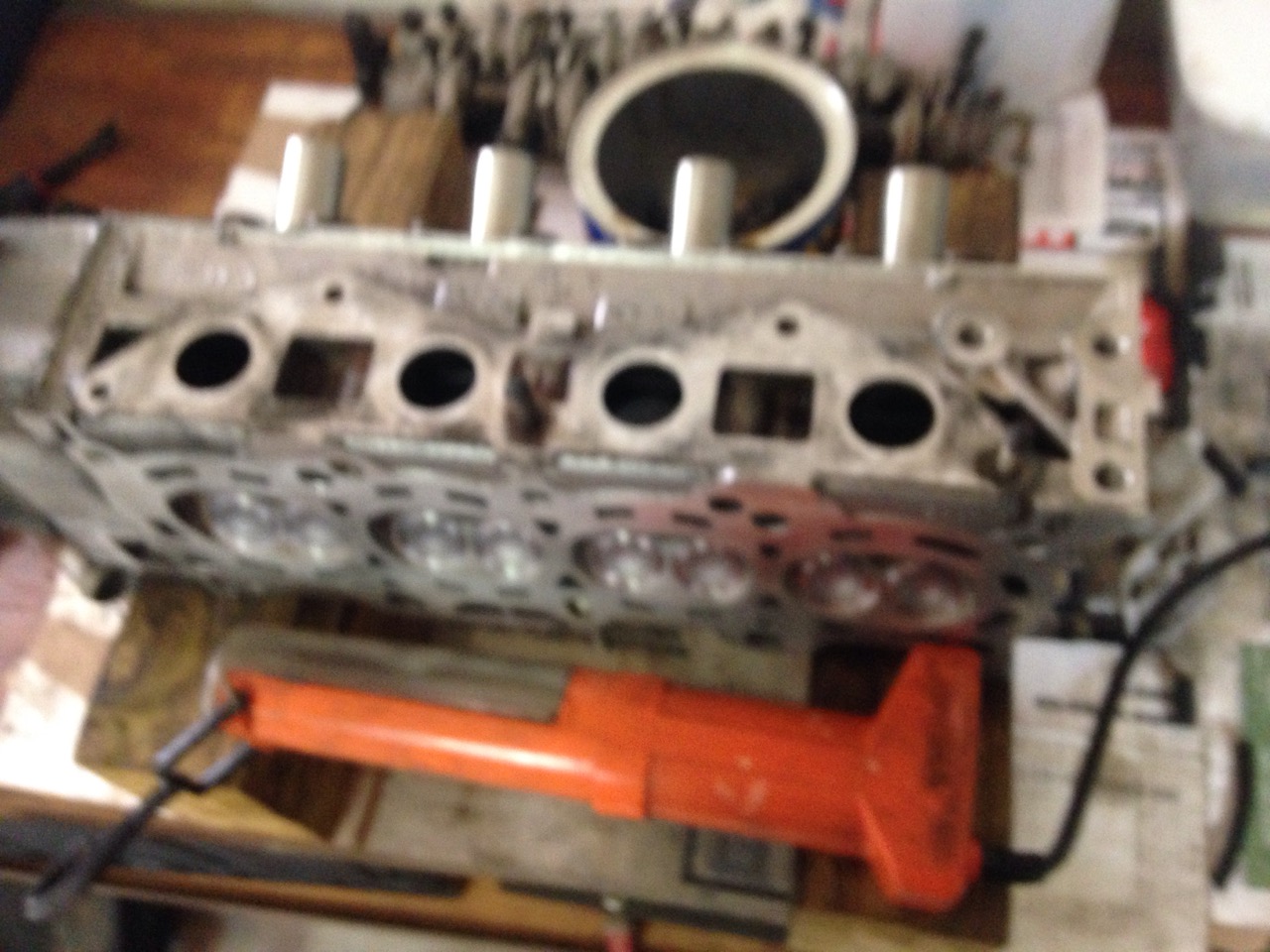

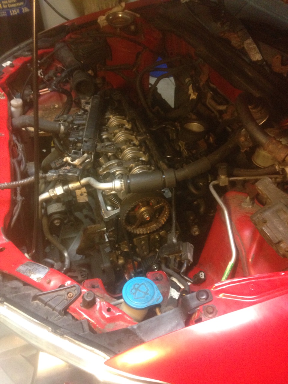

Old Apr 7, 2016
  #33
dsm482's Avatar
Joined: Mar 2016
Posts: 376
Rep Power: 128
dsm482 has a spectacular aura aboutdsm482 has a spectacular aura about
Re: 2005 honda civic cam torque procedure
Finnaly i got it running today, i had issue with the exhaust spring bolt,,, got it fixed.. drove the car... runs well.. was little louder on tappets when i fired it up. then as the parts settled in it became normal.., its just like new.
I did adjust the valve lash when I installed the new valves, at the lower minimum of the OEM specification..
I also rellaped the valves myself using a drill..
I measured the head with straight edge, didnt have warpage ... i couldnt even get the smaller gauges in. But i still sanded it down on a granite piece i have with 120 grit, then 1000 grit to give it glass finish.. thanks EZONE for reminding the Surface needs to be 30RA.
these are old scholl methods but they do work if you know how..
I was plannning on driving it and maybe i will check lash again , after they break in and readjust .

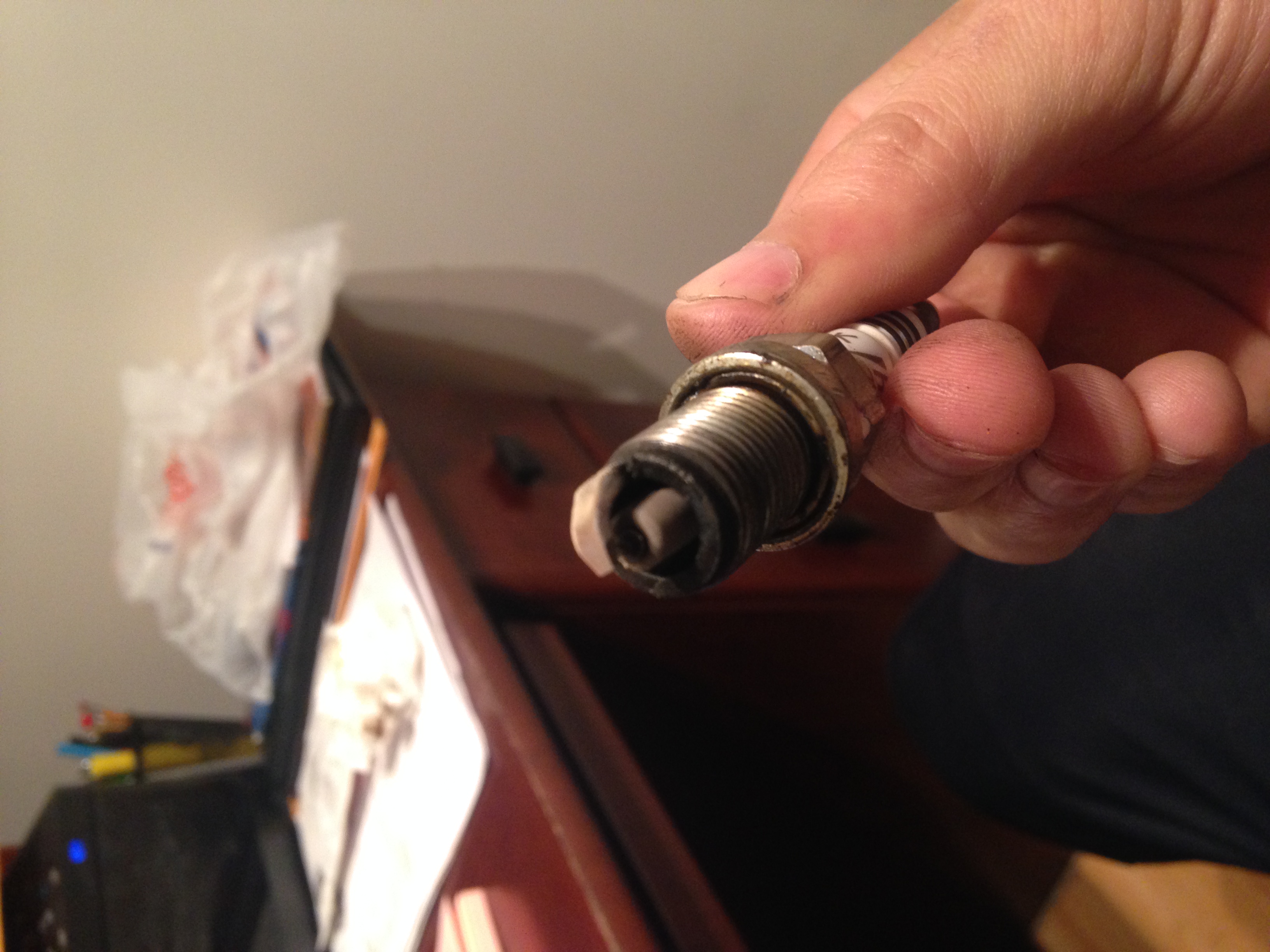

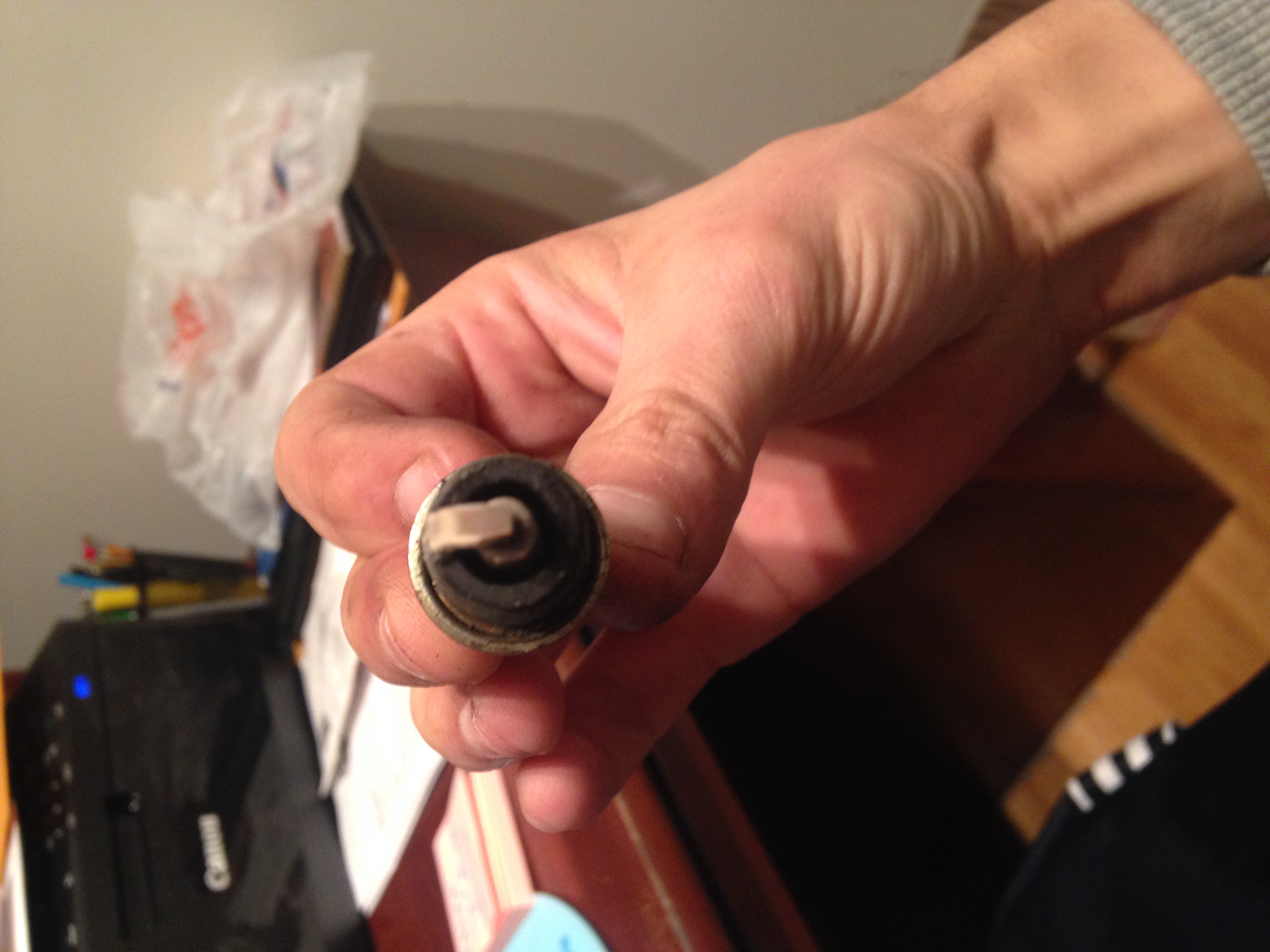

how can i establish , here is a pic of spark plug.. note i replaced this at 220k with new.. so they got 50k on spark plugs.. i noticed little black on the plug looks like burnning oil.

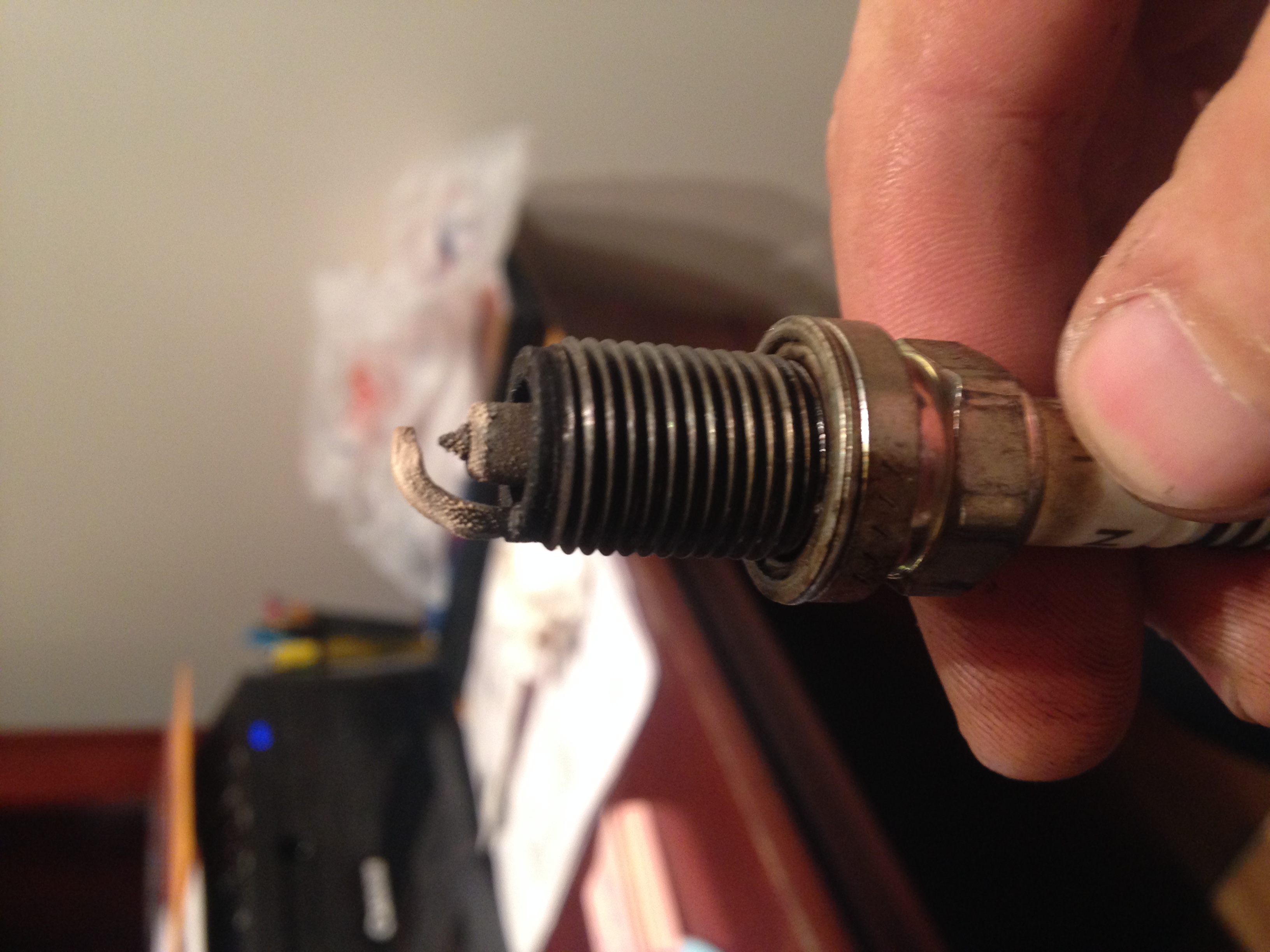

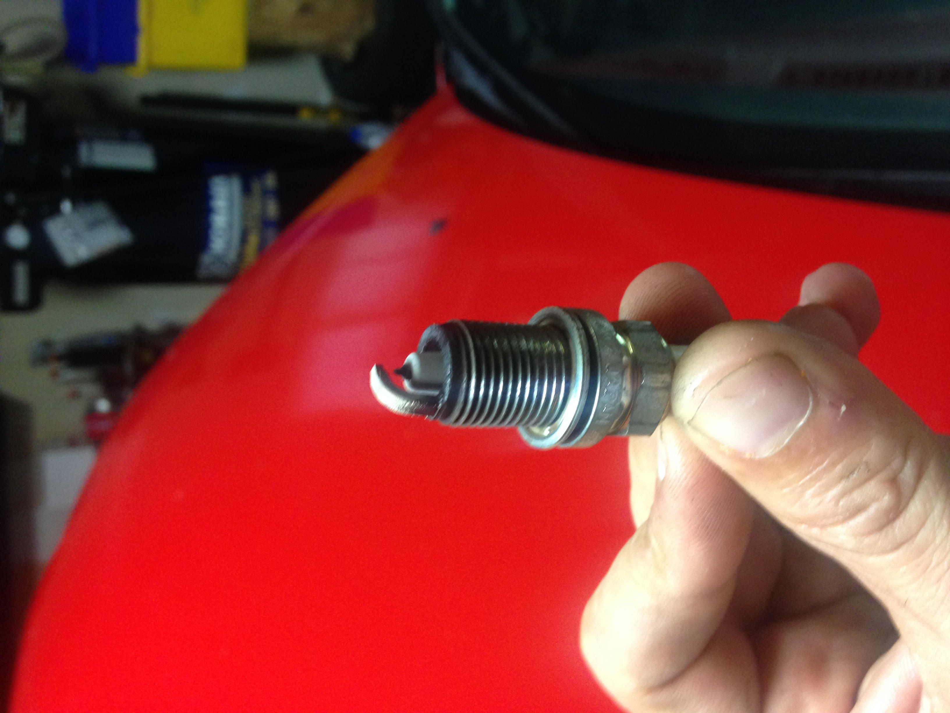

here they are, only on bottom ring i noticed little dark.. same plug few pics and angles..

3rd pic shows some speckles and crust (ash)
its the same plug i just took closer up..
whats that tell me , plugs are old.. I was hoping to see black plugs...
I would have to see how much it burns.. before valves bent, no burn oil at all ever... first time i notice my oil down.. no oil leaks, i replaced everything from previous jobs.. not even a drip of oil in oil leak.
Old May 15, 2016
Black and dripping with oil would indicate one helluva rapid oil loss, the kind where you'd expect mosquito fogger amounts of smoke and misfire after the plug fouls out.
The ash deposits typically result from slow, long term oil burning. There doesn't look to be enough there to cause firing problems yet.
Is that the only plug showing signs of a problem, or do they all look this way?
Originally Posted by dsm482
and these oil control rings, i noticed u mention in other post u loosen them up or something happens to them.. so technically i could be getting oil past my rings even though am sealing with top ring...?
Oil control rings do exactly the job the name implies.
Conversely, compression rings do a **** poor job of controlling oil.
(not considering 275k of wear here)
Oil rings tend to stick when carbon deposits build up in their piston groove.
After they stick in the groove they can't scrape oil off the cylinder walls very well.
Excess oil remaining on the walls as the piston makes its down stroke can be 'pushed up' by the compression rings on the next up stoke.
Guess where it goes after that....
