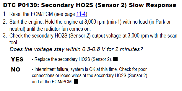

Here's the entire troubleshooting for that fault, I know it isn't very helpful.

The troubleshooting for that code mentions measuring the sensor output voltage with the engine warm and at 3k rpm. What was yours reading?
