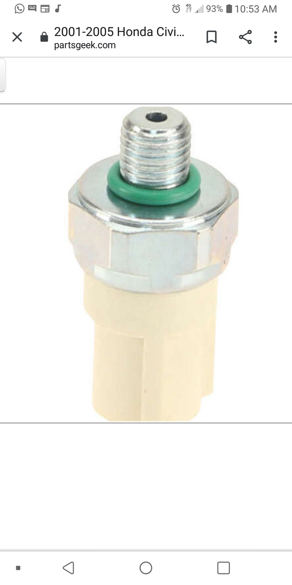

So here I'm having this never-ending leaking from my D17A2 vtec solenoid switch, the picture below will show exactly what I'm talking about. I bought oring from the dealer and use RTV but it only stop for a day or two and start leaking again. I sure its not the gasket that between the vtec and the head or the one at the top. I took picture before i wipe the oil away and it shows the oil leaking from that switch at the side and spray on the coolant hose that runs just beside it. Any ideas what next to do? I dont want to buy a whole vtec solenoid to stop this leaking.

If someone overtightened that switch, the aluminum might be cracked

its the sensor itself the white plastic part that attached to the part that screw in the vtec solenoid was leakking.i changed it and no more leaking.
