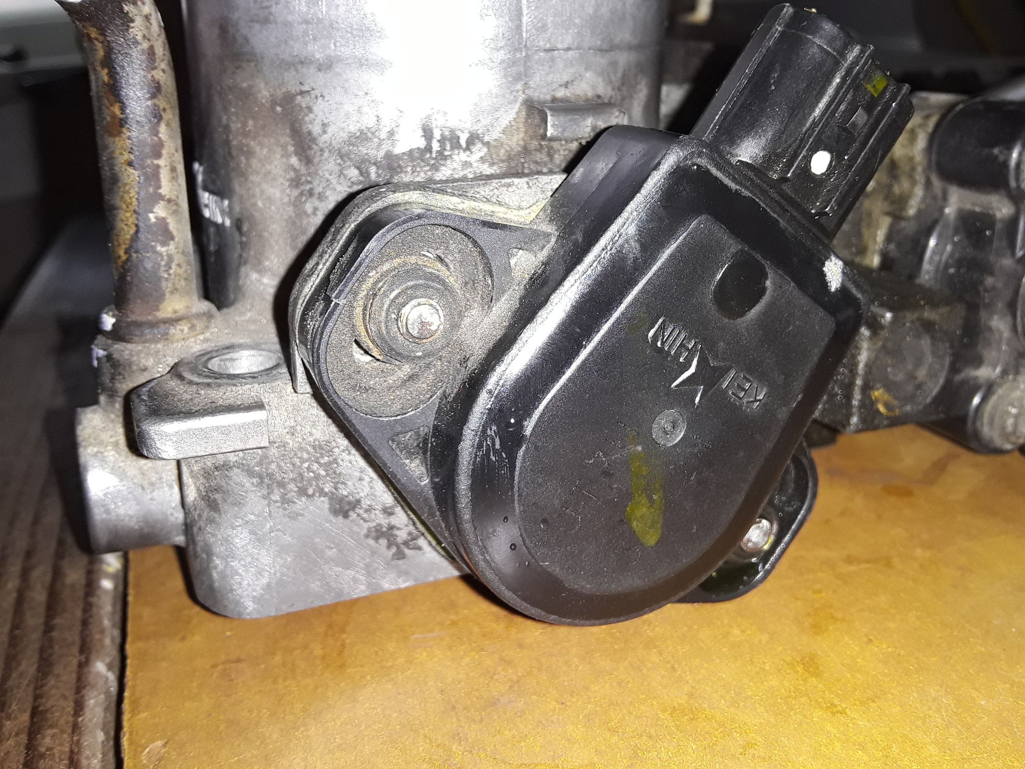

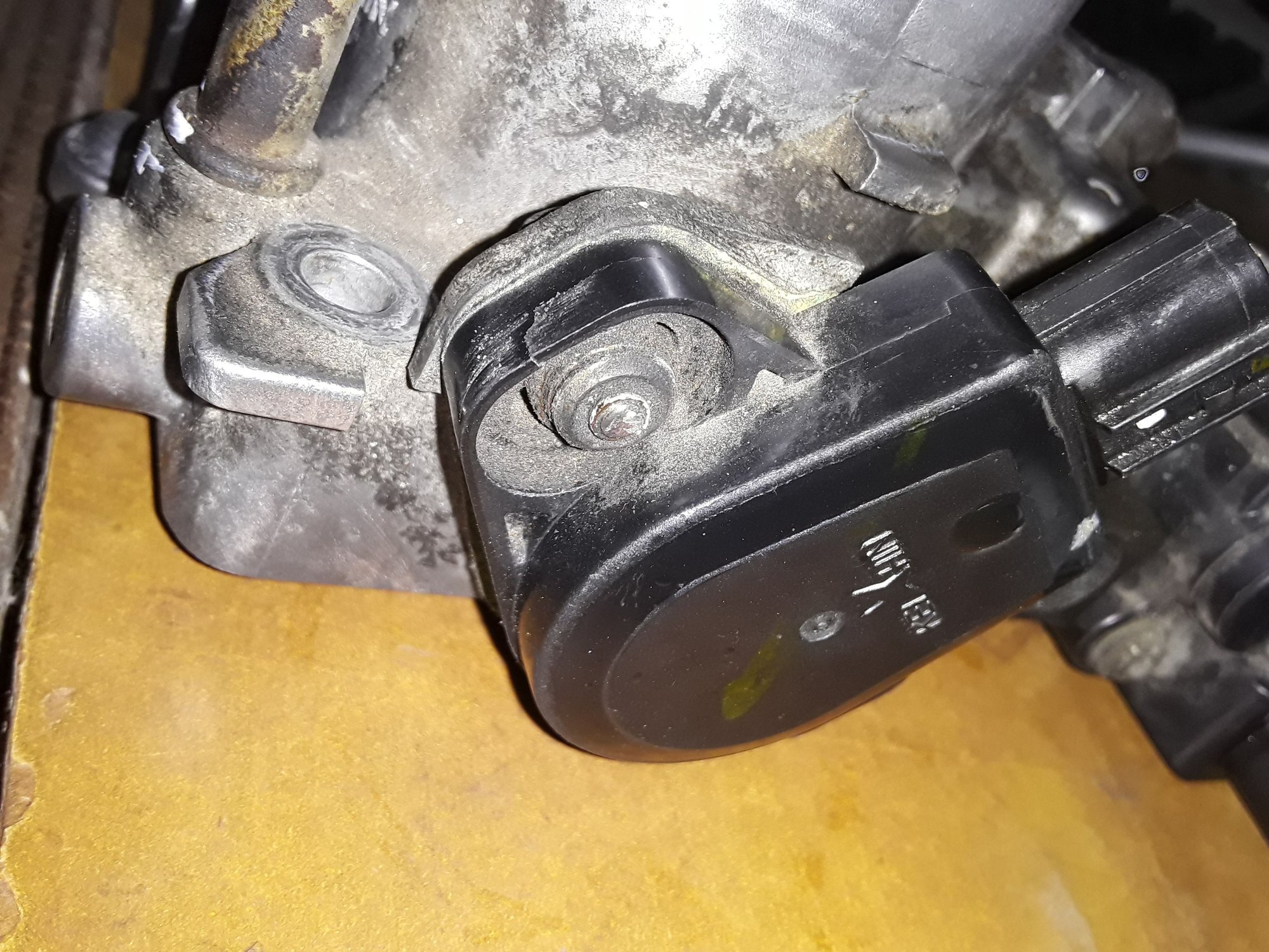

Idk what these are or how to get them off.

map sensor on a 7thgen is on the intake manifold, sensor portion points downward. What you're showing us is the throttle position sensor and it's riveted to the throttle body
edit: picture of MAP sensor
