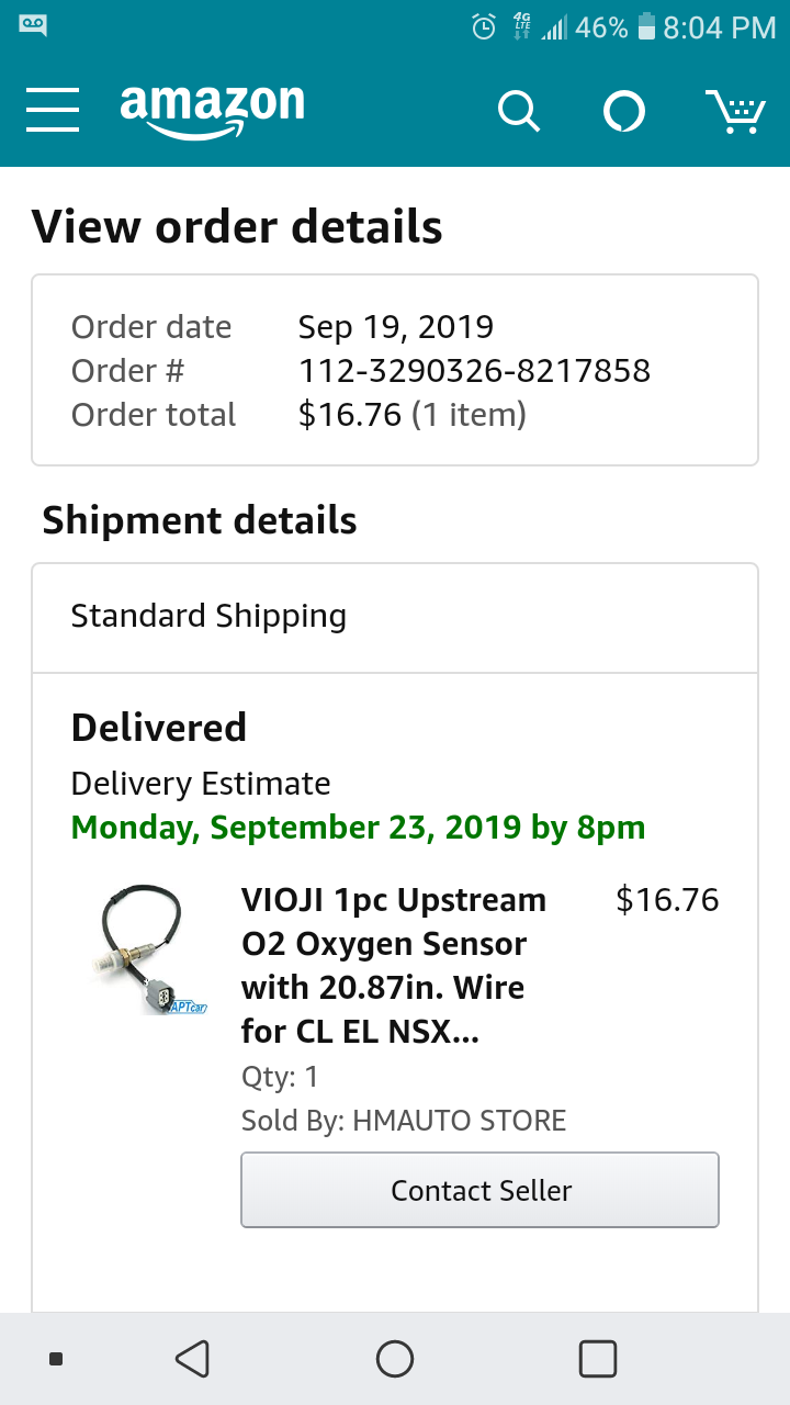

Hello,
I am new here and I am having a problem with my 2005 Honda Civic EX. Right now it will not accelerate above 200 rpms in first gear and it will also not rev above 200 rpms in Neutral. Everyone keeps telilng it is my CAT and even though a friend of mine found a shop that would only charge 200 for parts and labor. 200 bucks is 200 bucks. I googled the problem and it mentions the throttle body sensor and other sensors I have already replaced including the upstream 02 sensor. The check engine light is on and the only code it is throwing is still showing is for the upstream 02 sensor which as I just stated I have already replaced. I am just if maybe it could be the throttle body sensor or even the camshaft sensor as a co-worker of mine suggests. Any assistance will be greatly appreciated.
Have a good day

Did you use an OE sensor? Was the ECU reset after it was installed?

If you remove the front 02 sensor does that improve acceleration?

No it was not. I was afraid to drive it around the block until the engine reached operating temperature.

No why would I remove a new 02 Sensor?

OE as in NTK or Denso brand. Not a cheap universal one they try to sell you at the parts store for $60.
The ECU needs to be reset by disconnecting the battery so it can clear the code and go through its routine again.
Okay that could a the problem. The car has been sitting for a a while and eventually the battery was dead over a week. After i had O'Reilly's recharge the battery and I started the car again the check engine light was still on and the car still would not rev or accelerate over 200 rpms

If you used the wrong/junk O2 sensor it won't matter how many times you reset it.

Even though I got the 02 Sensor on amazon I made sure it could be used for a 05 Honda Civic EX

Was it an NTK or Denso?
I don't care what Amazon or the parts people said would fit in the hole. Honda's are very picky about O2 sensors. Do you have a link or part number?
It was the up stream sensor which is actually an Air Fuel Ratio sensor correct? The second sensor is and oxygen sensor and does a different job. They are not interchangeable.
I got what my co-workers brother who works for the local Honda dealership maintainence told me I could get.

Part number?
Link?

This one

And yes the new part matched the old part that was taken out exactly

Not the correct one. Cheap Chinese junk.
Buy a Denso or NTK brand. It will cost a pretty penny.

When your rent is 1300 bucks and your car payment is 300 bucks you go the cheapest route with guidence from a Honda maintenance guy
