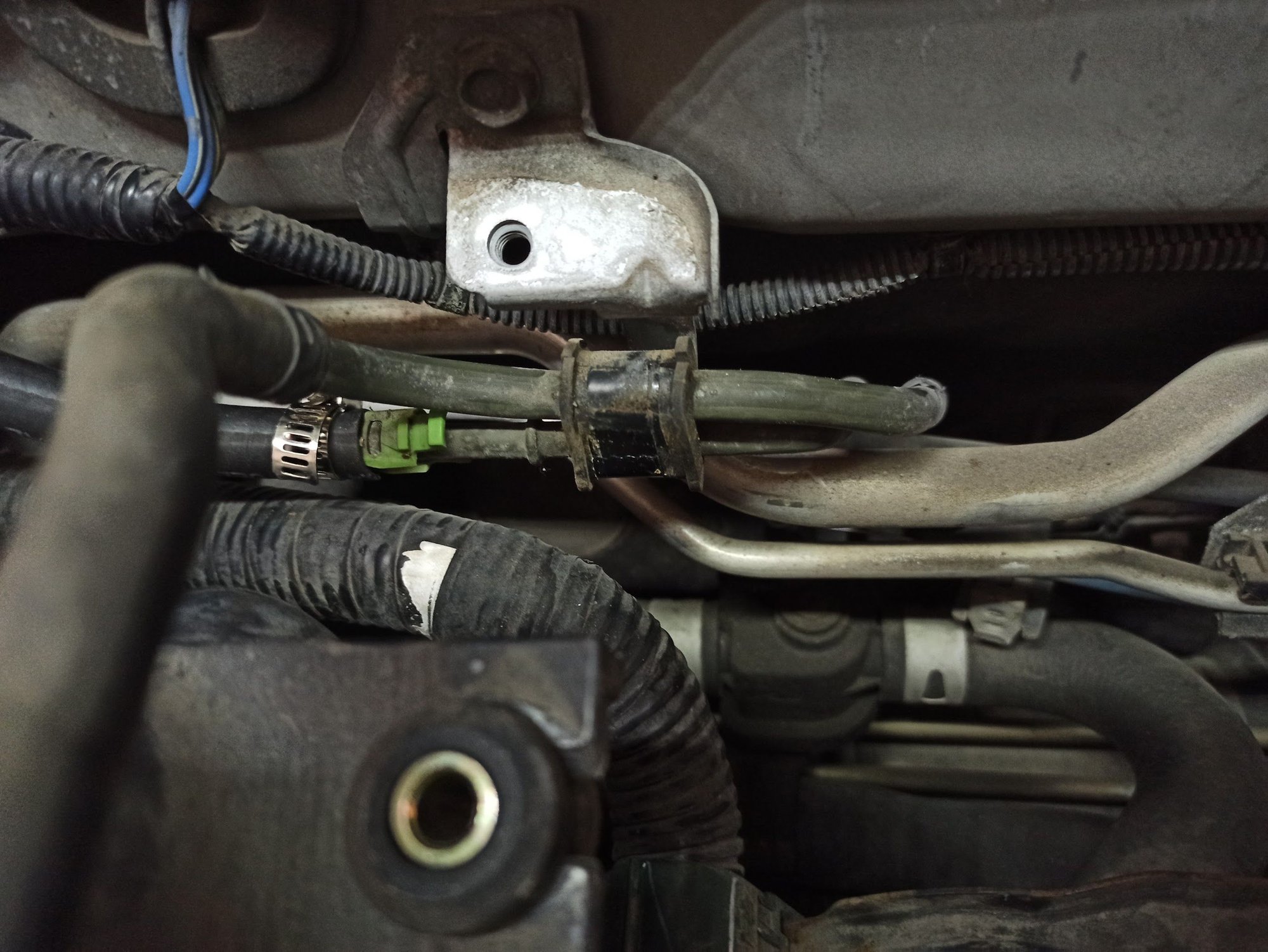

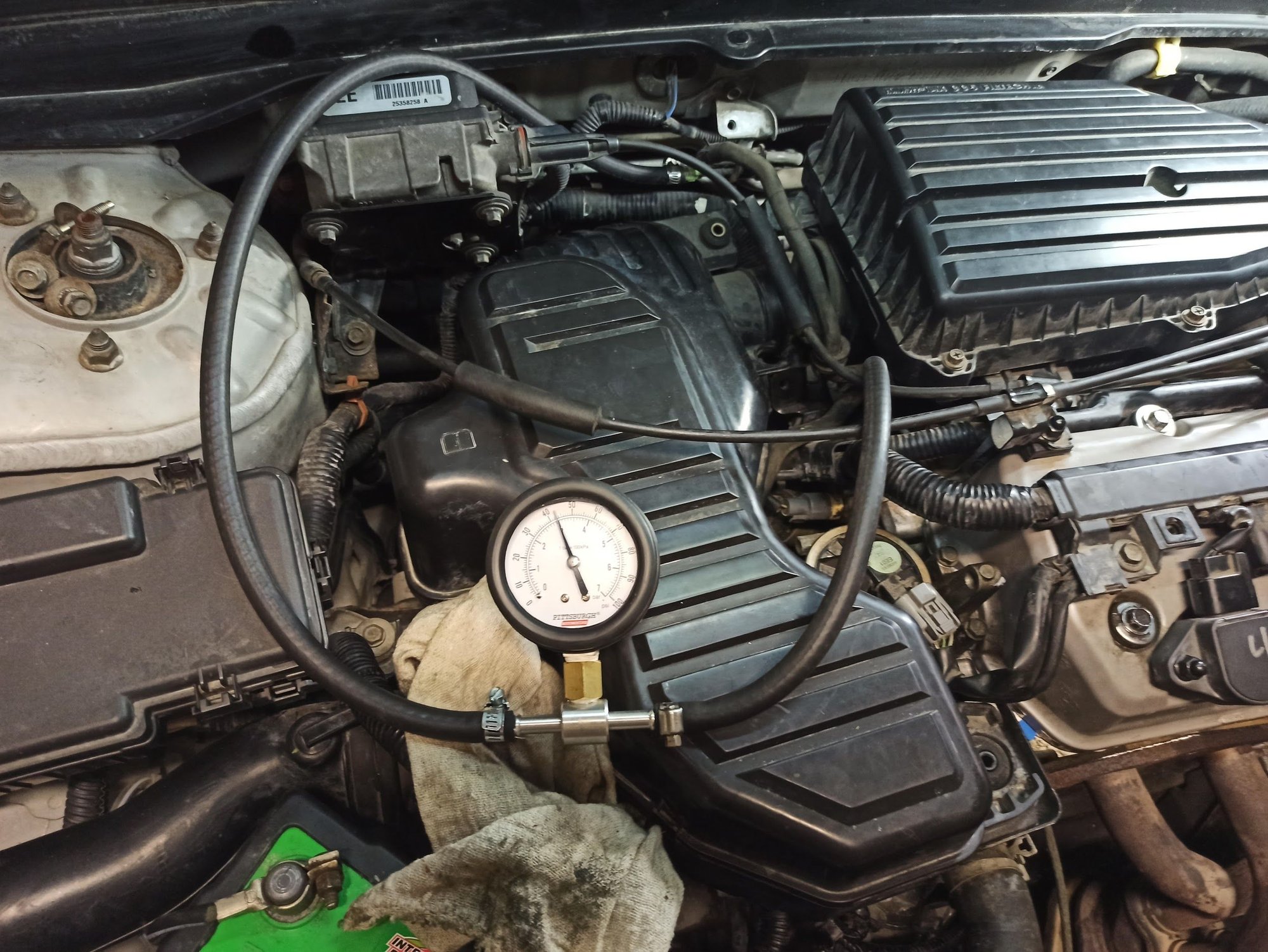

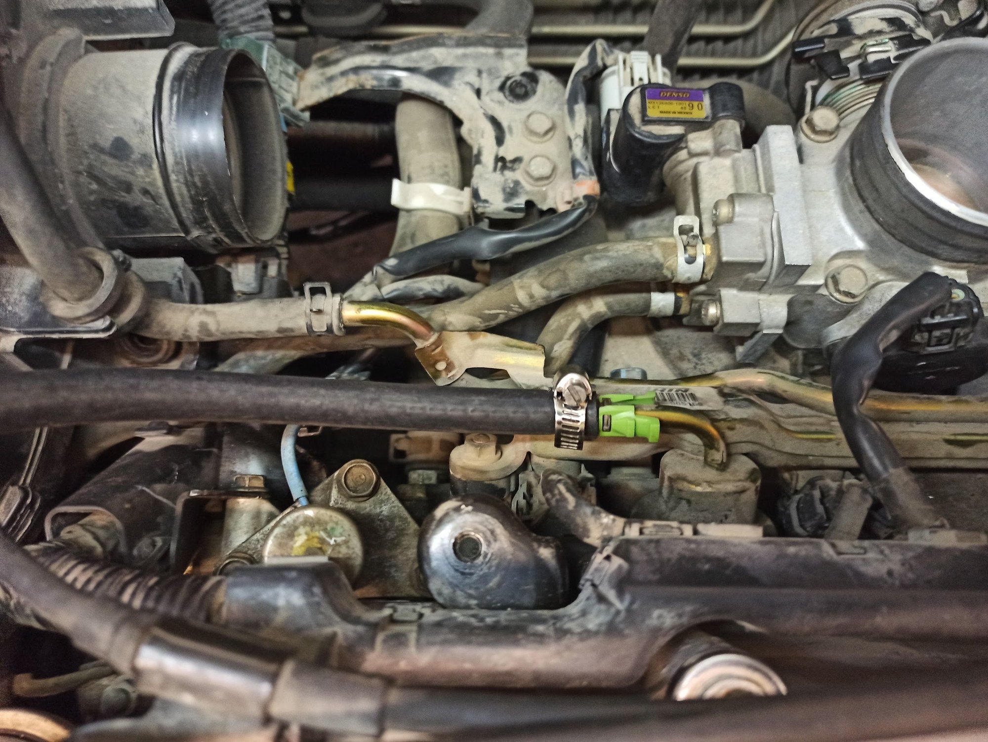

To test my fuel rail/pump pressure, I used a harbor freight fuel pressure tester kit I already had on hand. I removed the quick connects from both ends of the incoming fuel line to bypass the flexible factory hose, then used a couple sections of fuel line to splice in and clamped them to the fuel rail. the factory pump that was in there was fluctuating 5-6 psi and was jumping all over the place. The replacement is rock solid, no movement, and I gained 2-3 psi on the gauge. Car idles perfectly now.
