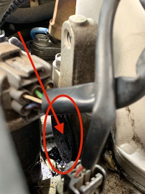

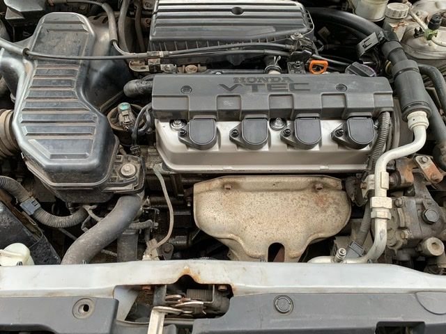

Replaced the valve cover gasket but I’m still losing oil. Can anyone tell where the problem might be from these pics?
Zooming in
on the area
so you know where this is.
Transmission
Oil pan

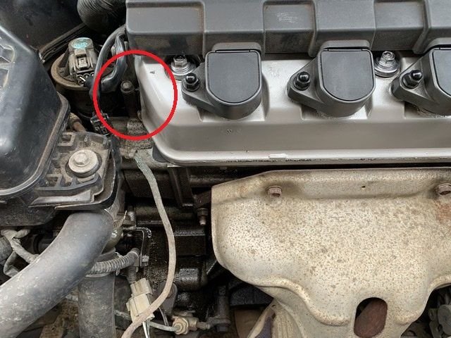

The camshaft end plug is a common oil leak and is located on the side of the head near the EGR valve. Red circle in attached is the location.
Also, minor detail but you are missing a bumper/grille clip near the hood latch and you could use a new ground strap (quite noticeable in your 3rd photo).

Re: Oil Leak
As stated prior most likely an end cap. Could also be valve cover too. Personally, I use rtv sealant as little as possible but I've found that applying rtv to the end cap o-ring tends to help compared to it not being applied when installing a new end-cap. I have even reused an end-cap with rtv applied and it sealed it completely... that was 15k miles ago. Just have to be careful and apply only a thin coat of black rtv or Hondabond on the end-cap o-ring and do not glob it on. The goal is to avoid any overage of rtv from getting into valves or camshaft.
Also, personally I prefer to replace the end-cap with the valve cover off to ensure the two tabs (legs) of the end cap don't break off during removal, or if they do I will be able to find them before starting the engine. It's a bit of work to remove all items theout of the way to eventually remove the valve cover but once the valve cover is removed it's a good time to replace the valve cover seal, check intake and exhaust valves clearances, replace spark plug hole o-gaskets.

Thanks! Looks like you were spot on. I assume you're referring to this:
Last edited by devinkkperry; Jan 11, 2020 at 07:26 PM. Reason: Forgot to attach photo

Originally Posted by devinkkperry
@NDNV @HR Puffinblunts
That's it. A common oil leak source for these engines.

Yes, that's the source of your leak.
