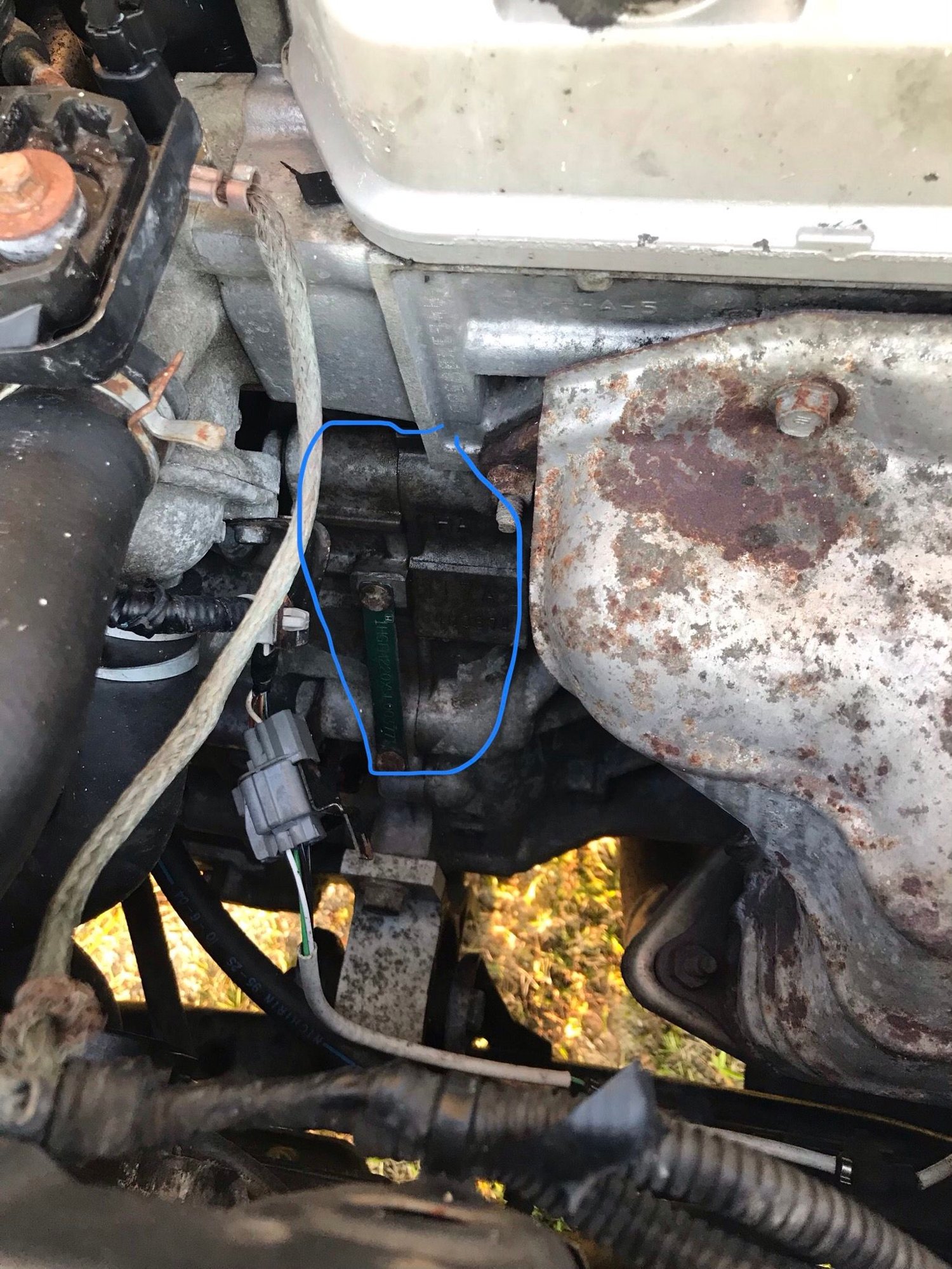

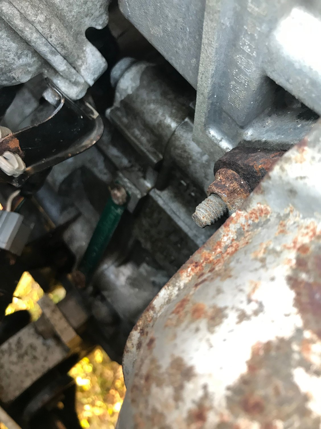

I have an oil leave comming from the upper between the motor and the trans where they meet. I have changed and re checked the plug and it’s dry as can be behind or in the vicinity of the Egr. Not overheating. Has 175k. Could the rear main seep from the upper location not sure. Please point me in the right direction.

That’s way too clean to be a active leak above the joint.
The only time I have seen “oil” seep out of the top of the bell housing was when a torque converter cracked and just sprayed all the transmission fluid out coating the cracks so much they looked similar to that except all the way around and transmission fluid was dripping out bottom.
Pretty easy to pull the starter out and find out if it’s covered in something. Technically bottom access plate is easier, but pulling all stuff off to get to starter will help your field of view of everything it’s more likely to be.

It’s motor oil not trans fluid though

Exactly, I don’t expect your going to find the rear main seal capable of leaking in manner that results in the oil flinging around.

It has a new head gasket, cam seal and cam plug. Still very slowly seeping oil out of the same part of bellhousing as in the pic.
