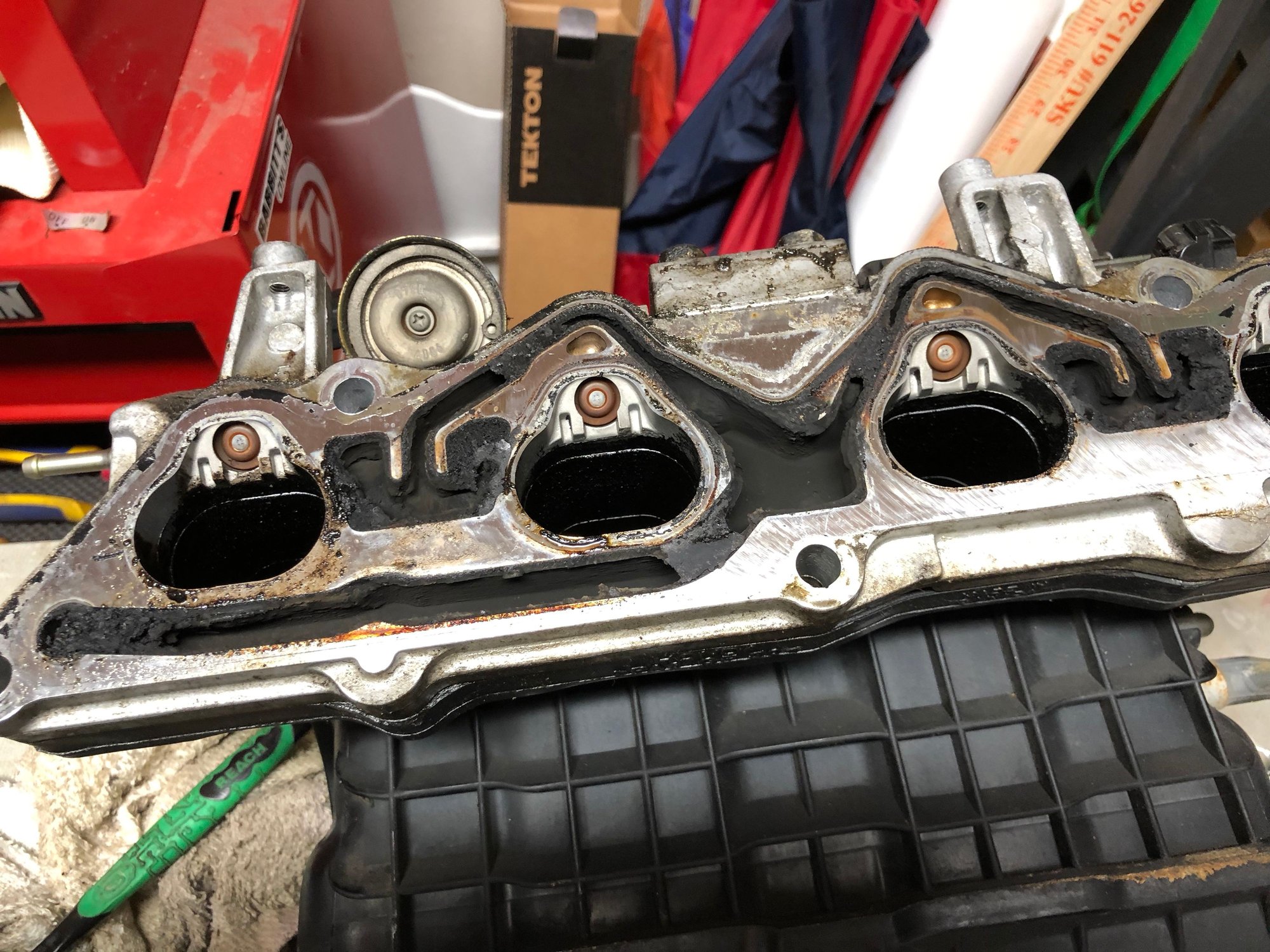

HOLY COW, LOOK AT THE CARBON CRAP!! Ok, I am doing a head gasket and this is what my intake looked like. 198K miles and this is obviously the first time the head has ever been off. I am cleaning up this mess, but HOW DO I GET THE CARBON OFF THE BLOCK??? That stuff is crazy stubborn. I can't get the stuff around the pistons off. the outer part of the block is awesome and clean, but not the Audi symbol in the middle. How do I clean it? Carb cleaner, nope - brake cleaner, nope - gas, nope.... HELP!

Scrape it.
No point in trying to get it spotless. It just has to be able to flow EGR gases.

Thanks for the reply, I've got the intake cleaned up. My concern is cleaning up the block before I install the new head gasket and head. How do I clean the carbon from the block without damaging it?

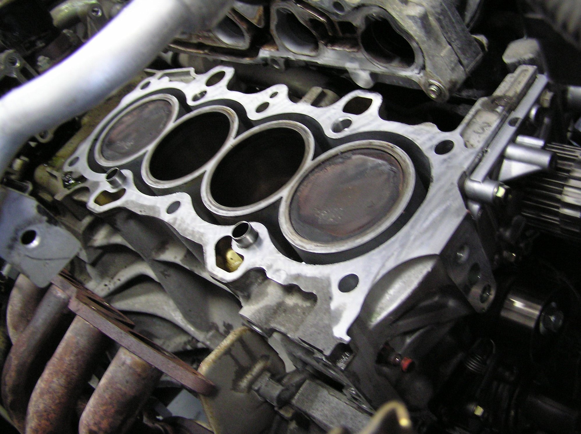

Smooth and flat are most important. Not shiny.
The condition and finish of the machined surfaces are critical to a long lasting repair

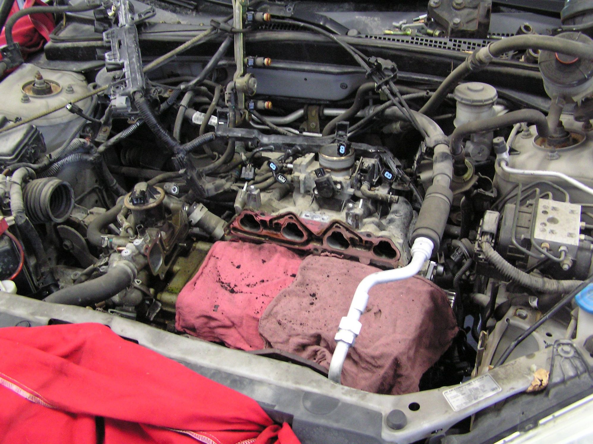

I simply scrape the lumps off with some single edge razor blades, then wipe/scrub it with spray carb/throttle cleaner and a shop towel (see last pic above)
Forget removing all the dark color, you'll probably damage the machined finish of the deck surface before you get it shiny by scraping or grinding.
Same for the head.

Make sure to use a material that is softer than steel if you use a grinder/dremel.

late to the game, but last time I had to do that, I soaked it in marvel's mystery oil overnight and scrubbed with a nylon brush. Cleaned it up a bit with brake cleaner after that and got it to the "good enough for government work" point.
