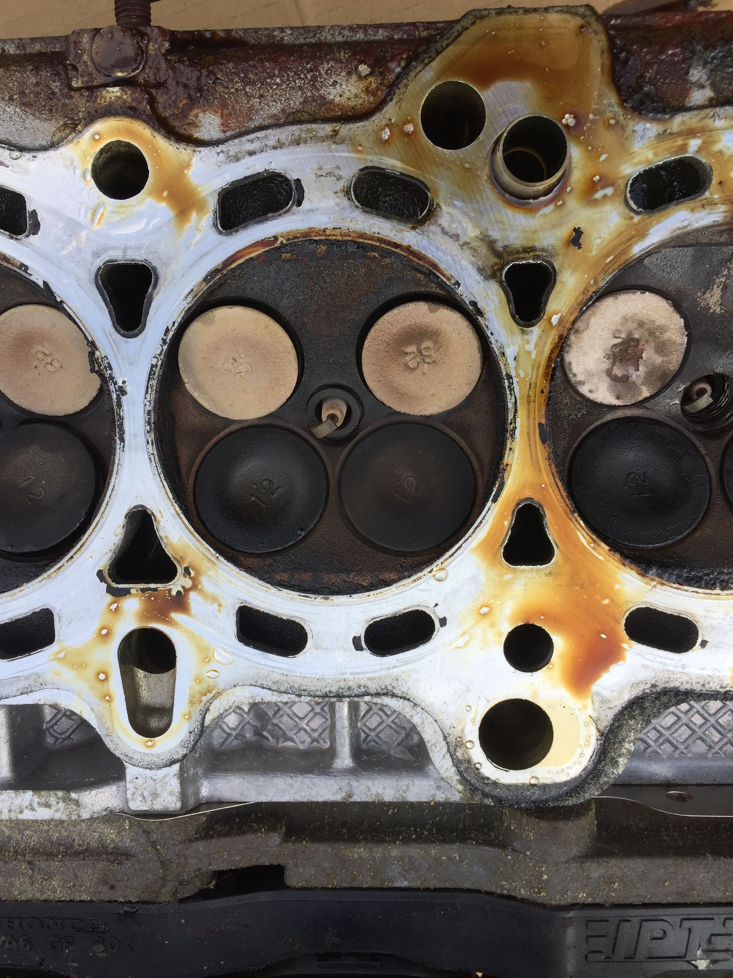

Hi folks,
I think I see the failure but you all have seen tons more of these than I have. It seems like a much cleaner area on #1 exhaust side with a matching cleaner spot on the head. Engine failed pressure test on #1 pushing the radiator level up when pressure was applied at TDC.

You probably already know but check to make sure both the block and head are level. Usually a warped head causes the failure/results from failure.
New head gasket wont do sh$$ if the head is not true.

You can clearly see the baked on head gasket coating extending from combustion area towards the water jacket holes on #1.
in your case I suspect the leak was happening inbetween the layers of the head gasket.
Afer getting that much antifreeze everywhere, take great care to clean all electrical plug with contact cleaner.

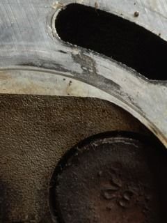

Yup. After cleaning up the head here is the problem area.

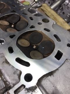

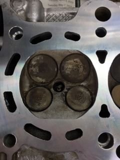

Found a decent machinist not too far away. It's a treat to watch a pro at work. He said it's never been surfaced. Stock Honda steel plate gasket on the car. You think it's the original at 220,000 miles ? Hope the next one lasts that long.
