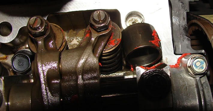

huh, if you had kept the original head, you could have simply installed it and gone around the ECU asking for a VTEC (in case your current one is not a VTEC head).
this below is VTEC rocker arms
Attachment 100366

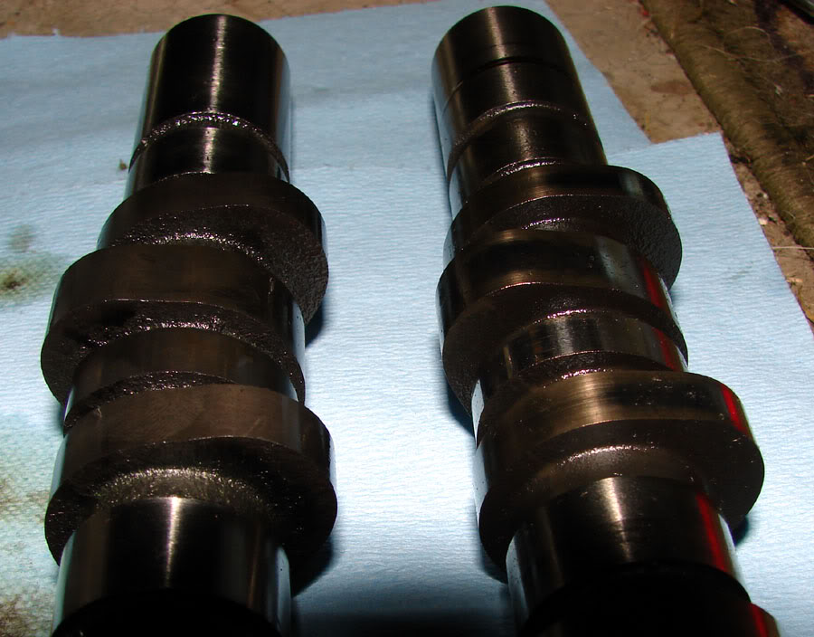

the ones below are the lobes for one cyclinder - there will be 4 of them in a VTEC camshaft.
If yours have only 2 lobes, it's a non-VTEC camshaft. If it have 3 lobes per cylinder, it's a VTEC camshaft.
Attachment 100774

i dont remember seeing one... i think the po of the donor car put the plastic cover on it just to screw with a dumb dumb like me. It worked! Im thinking of starting over. Pull out the a1 (after i determine it has a bad hg) and put in a A2 egr engine. I have my eye on one at my supplier i can get for dirt cheap/free. Chalk this up as an expensive lesson.

yep, even better, if i still had the original motor, i would b replacing the hg, mill head, swap back in!
i guess i could pull this A1 head, replace with a reman A2 head, get a EGR thermostat housing and im gasket, plug everything in and go with it. That way, i dont have to pull 2 engines.
