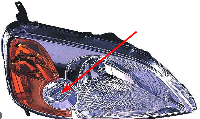

2003 Civic EX just failed for burnt out “marker” lights. The headlight work and the blinkers (the ones on the far outside) work. The silly little round one is burnt. But how is this a marker? It’s in the middle of the bezel. What is this small lamp? And what kind of bulb goes in there?
or do I have it all set up wrong?

Assuming they're talking about this light,
It's the parking/running light. size 168 bulb. Those are the lights that turn on with the first "stop" on the headlight stalk when you go to turn your headlights on.

Got it thanks. I couldn’t find this info anywhere else.

To reach to replace those you probably want to pull the front inter fender panels out, or drop the bumper. unless you have thinner and much more nimble hands than myself. I would put LEDs in so you don't have to change again for many years (what I did at least).
