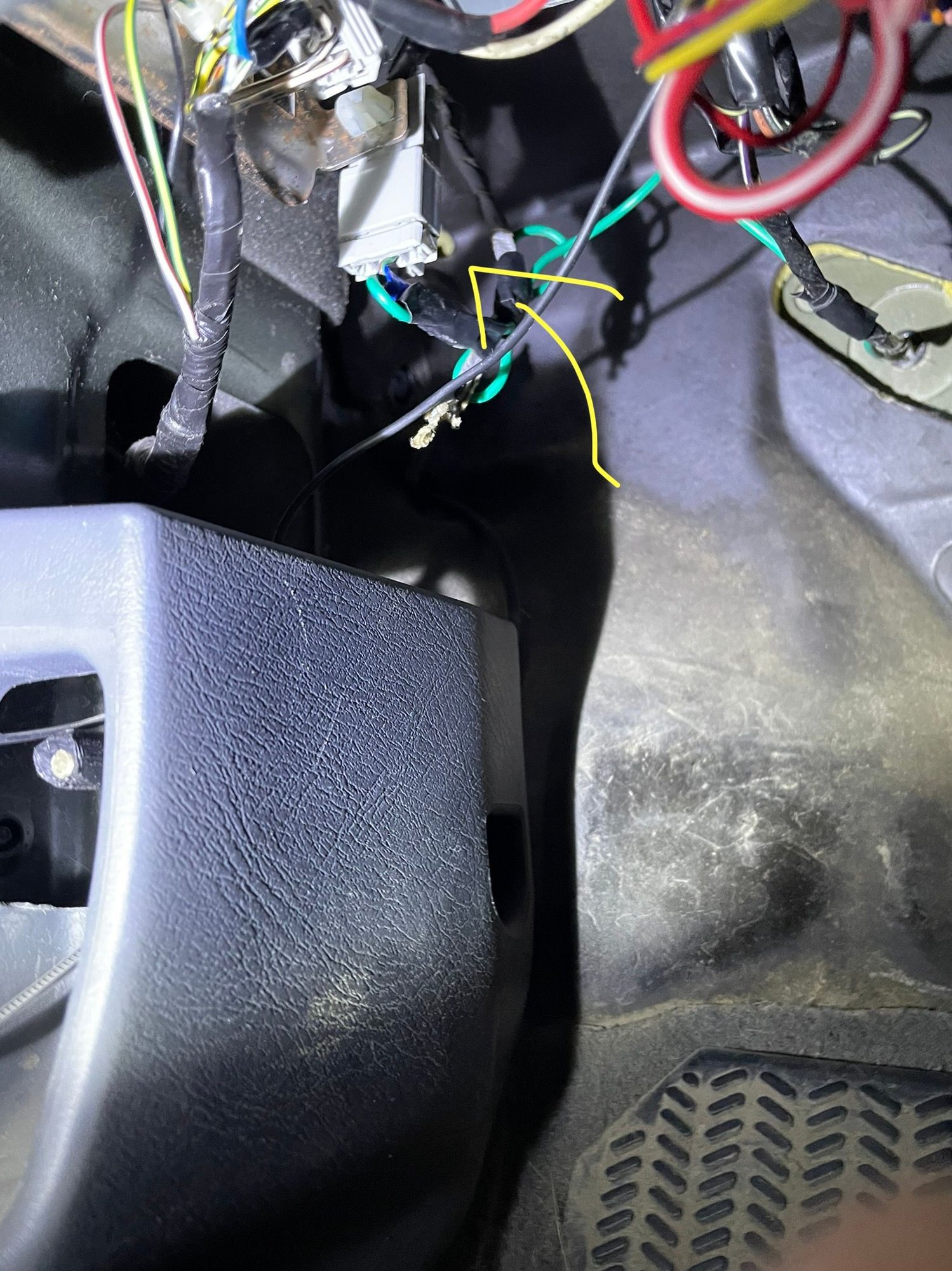

Sorry for the delay responding. I couldn't remember exactly which wire I tapped to get power from the dome light. Just had a chance to look at what I did today.
I tapped into the green/red wire from this grey connector and used that to trigger a relay in the engine bay
Old Sep 9, 2022
Likkleskip's Avatar
Joined: Aug 2022
Posts: 5
Likkleskip is an unknown quantity at this point
Re: Wire Headlights to turn on when doors unlock [solved]
Thank you, imma get this started tomorrow.. respect!
