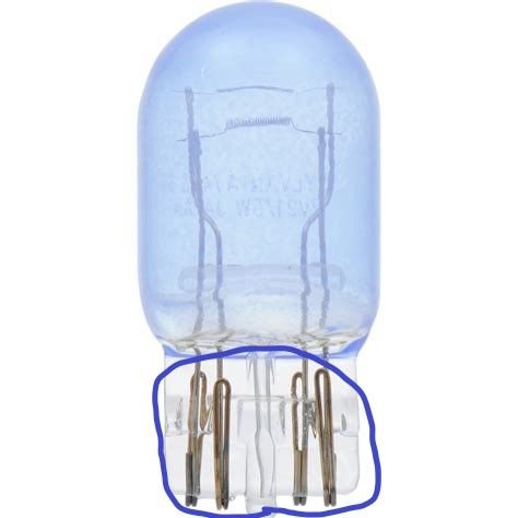

SUCCESS!
This was easier than almost anything I've done in my car. No wire cutting involved. All I needed was a tiny bit of plastic tape - covered the parking light wire (in the bulb) that touches the metal part in the socket.
Old Aug 17, 2016
Rep Power: 518
Re: Disable the parking light feature from the front turn signals?
Originally Posted by gregd
SUCCESS!
That tape may become ineffective after the bulb has been hot several times. Good luck though.

I'm thinking if that ever happens I will simply trim the parking light wires in the bulb (Btw, these bulbs are $2 a pair here at the local thrift store I just don't want to cut the wires connecting the socket so I don't have to repair or replace it later when selling the car.

Three wires running to the connector. One is ground, one is battery voltage (cycling on/off) for the turn signal, third is constant battery voltage for the parking lights. According to my service manual, these are black, green/red (left) or green/yellow (right), and red/yellow respectively. Inside the connector or on the bulb, find a way to prevent the red wire/terminal from touching the appropriate contacts on the bulb. Would work the same with LEDs.

Either pinpoint and cut the correct wire, or as the Orignial Postered did: put a little strip of tape on the correct bulb contact (easy trial and error to make sure you have the correct one), also very easy reversal in future if need or want arises. I haven't tried it, but my suggestion would be once you do determine the correct contact, snip the bulb's contact wire (so the bulb is permanently altered but car is not) and tape doesn't gum up or wear through in time. If they are LEDs that directly plug to standard wiring it should work fine.
