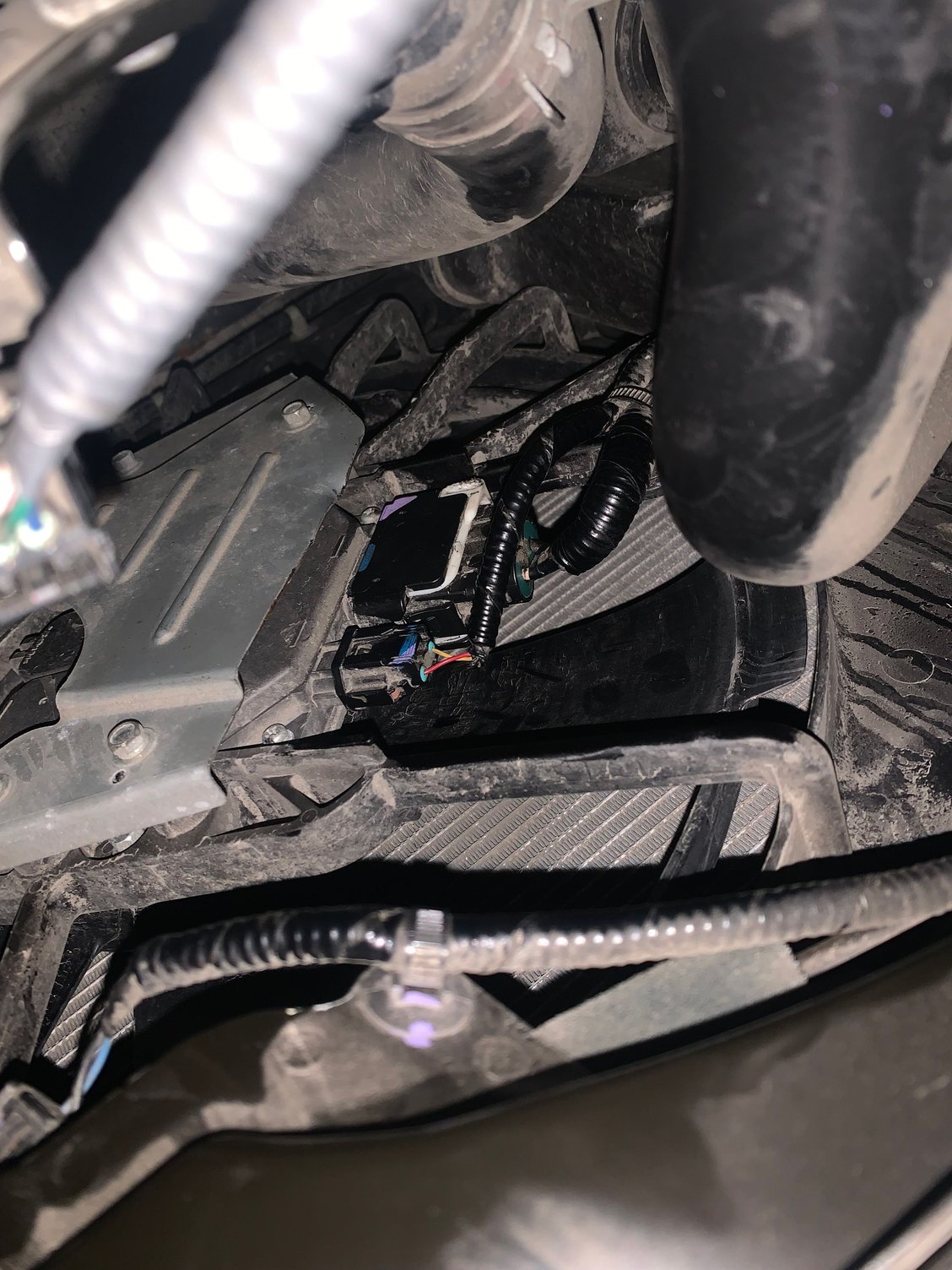

I was trying to run these cables directly to the battery to see if the fan is at fault or if its there switch, but I can't seem to get that plug with the white removed. Is there a trick to remove it? it has two push buttons on each side but even squeezing those it doesn't budge.

Electric plugs are usually a pain to remove - sometimes i just did not push enough
It's better for them to not fall off, actually.
