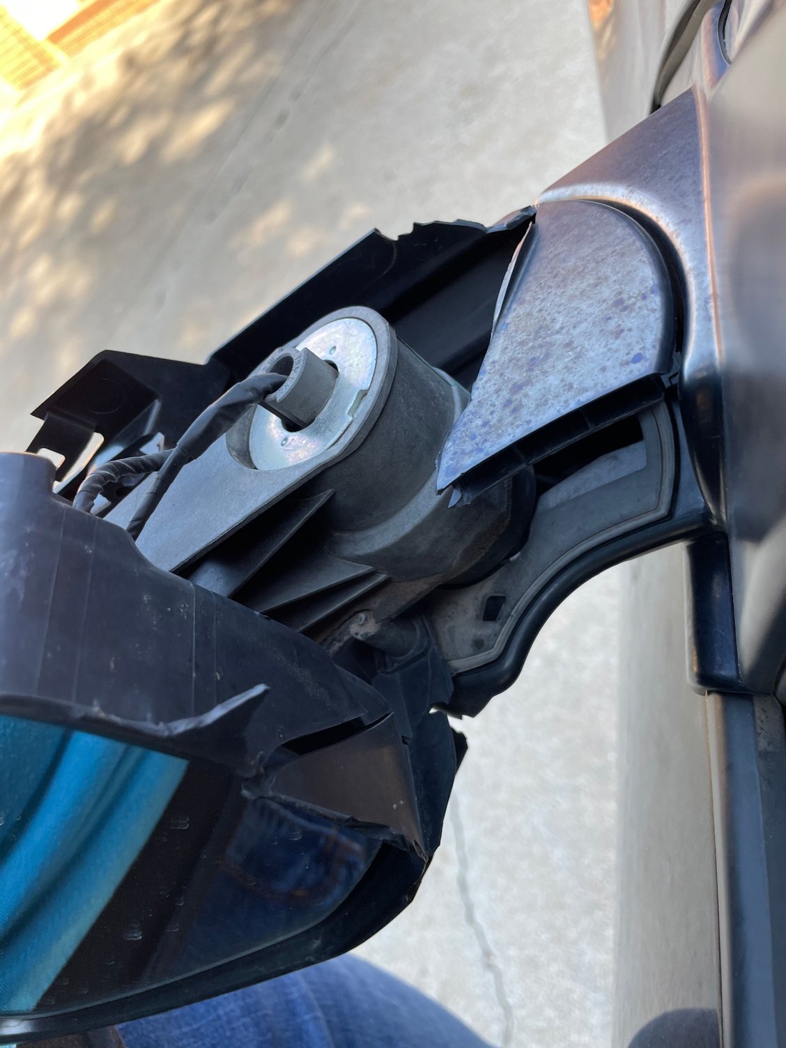

So I woke up to this. I don’t know much about cars. Any advice or suggestions on a fix?

The skull or cap was broken off of my left side mirror.

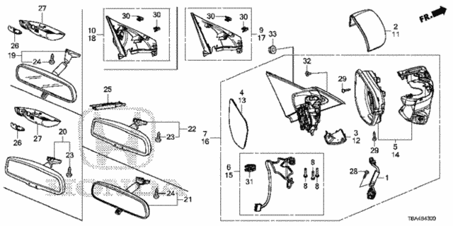

Part numbers below for OEM color matched mirror caps (#11 on the diagram -- left/driver's side)

Figured I'd add right/passenger side part numbers, just in case (#2 on the above diagram)

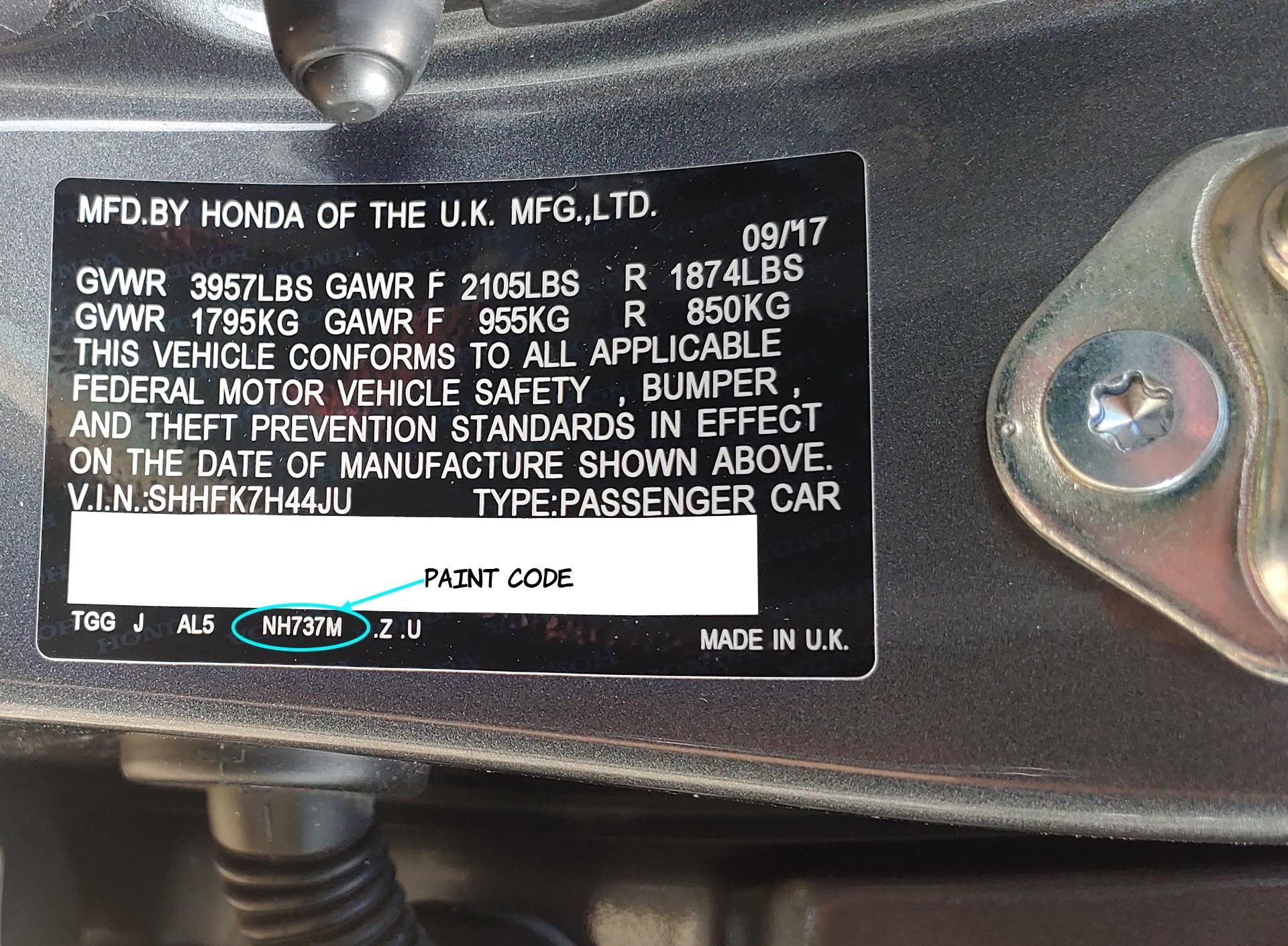

VIN won't decode color. Check the door jamb. There should be a label that tells you what the paint code is. Chances are, it's not Brilliant Sporty Blue. That's a Type-R specific color. I just realized Aegean blue isn't on my list of mirror caps. I'll add it here shortly

Driver's side door jamb, the sticker with the VIN and a buncha other stuff most people pay no mind to. Yeah, I censored the last 6 of my VIN and the barcode on the sticker.
Match that code to the list I have above to find the applicable part number

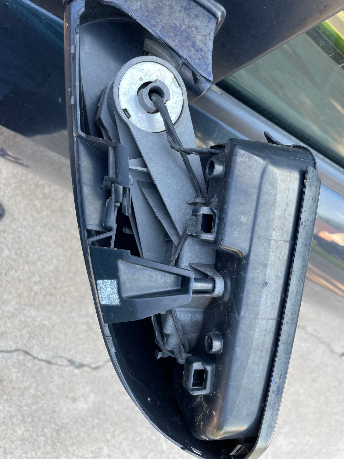

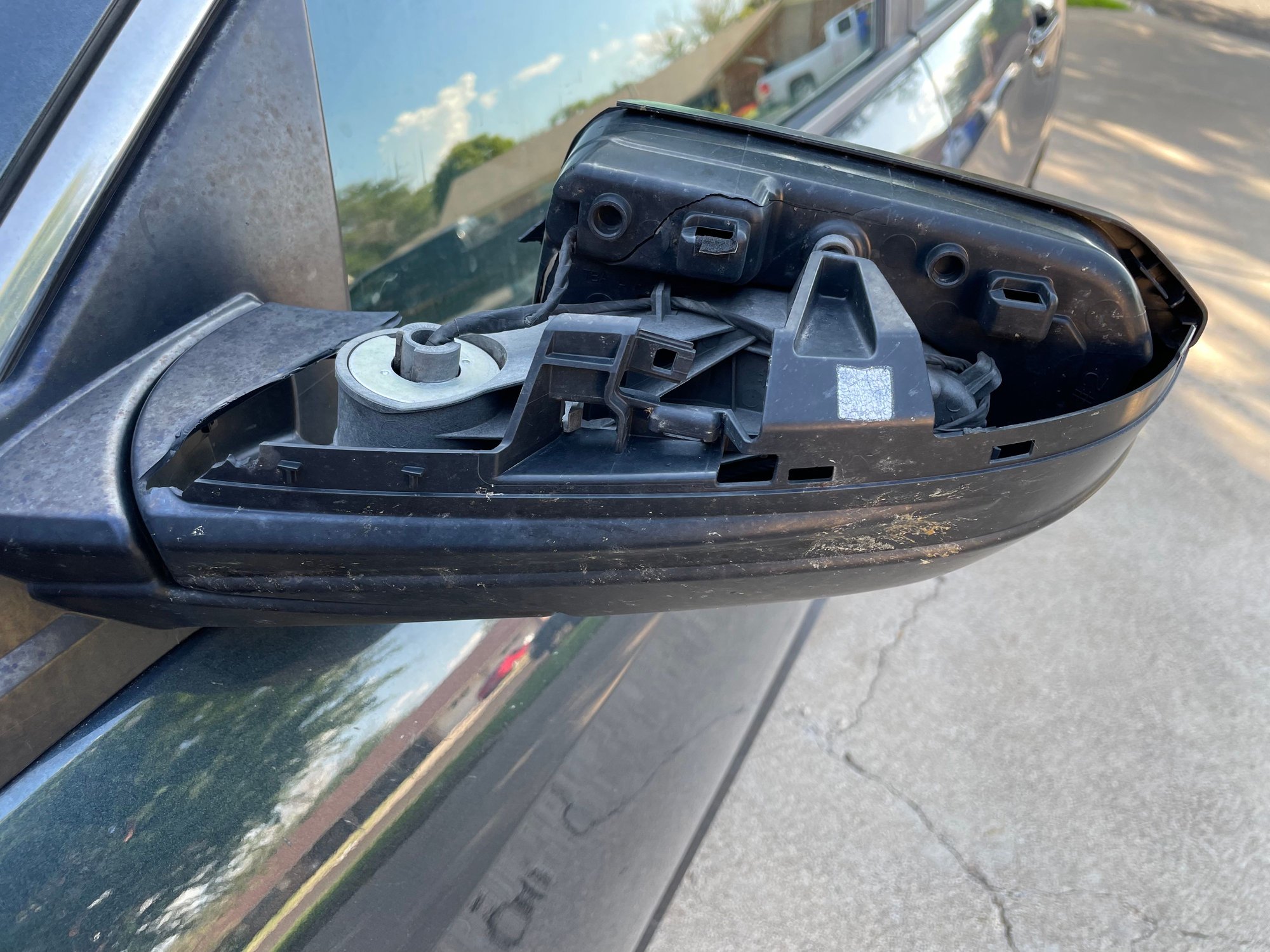

Upon closer inspection, I believe my daughter's Civic (confirmed to be Cosmic Blue Metallic, thanks to you guys!) is gonna need both the mirror cap and the bottom piece(s) that it connects to (see attached photos) since that/those appears to have been broken too. I'm unclear what the part number(s) would be for that lower portion - could y'all point me in the right direction on that too?
And does anyone know just how involved replacing that will be?

So, here's the entire mirror diagram
Number 5/14 on the diagram (P/N 76255-TBA-A02ZA for the driver's side) I think is all that's also broken, but it's hard to tell from the diagram. Assuming that's all you have to replace, it'd be a $70-ish (plus shipping and tax) replacement for factory OEM stuff (that's using the site I linked -- there are many more out there that have the same stuff at similar pricing, but Majestic Honda has been my go-to). The entire mirror assembly is like $240 + shipping and tax. Looking back and forth at the pics you took and the diagram, it really does look like that's all that's broken.
