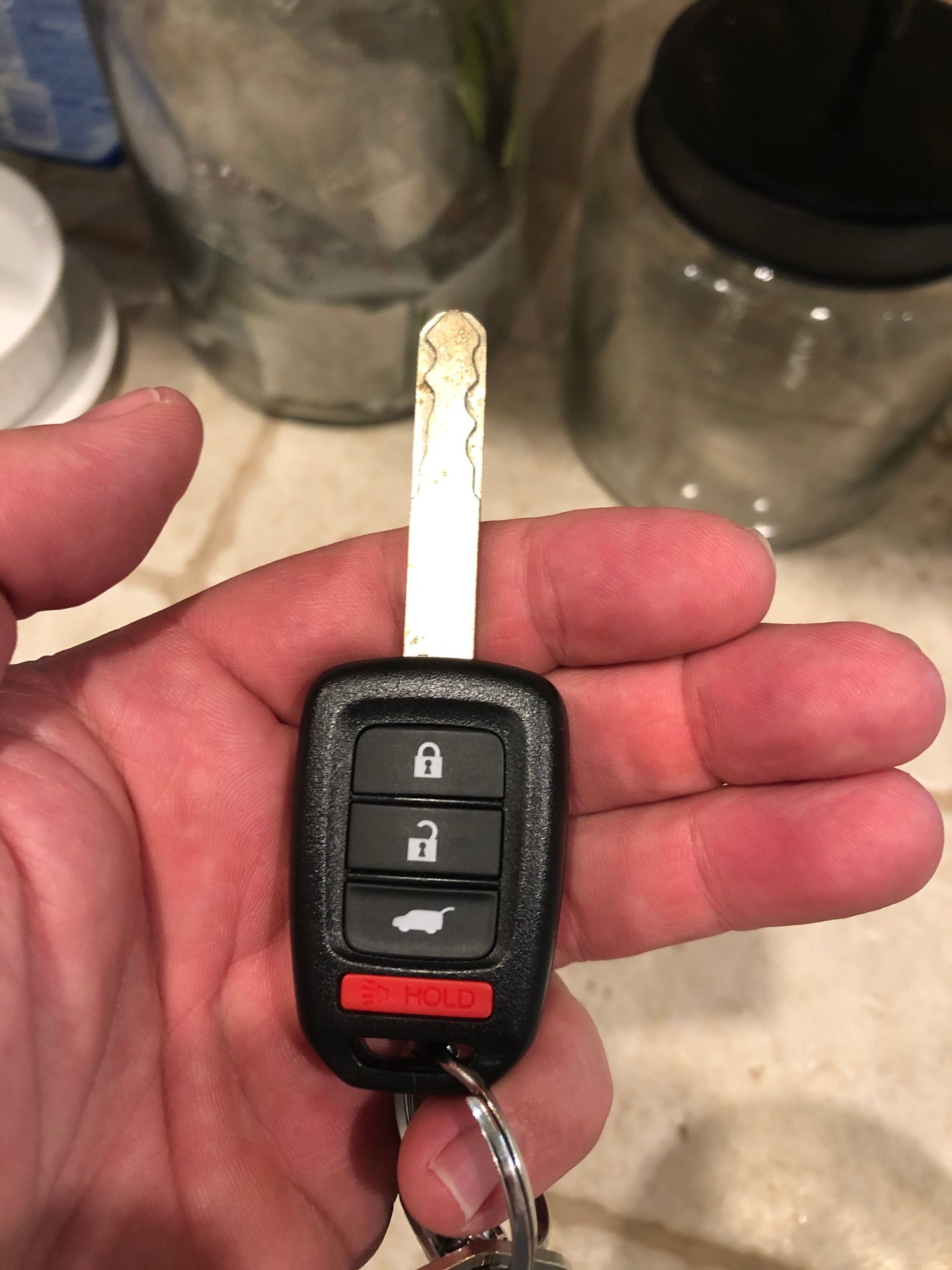

I have a 2017 LX Hatch with a key start and remote is on the key. Yesterday late afternoon, suddenly for the first time and after working fine all day, the remote would not lock or make the horn beep. When I noticed I tried again and all the windows went down. When I went back to the car I could hear the gas-cap-cover lock or unlock. And the red light on the remote stayed on for a bit.
I added a pic of my key/remote below (btw... is there a way to insert a smaller pic?)
I changed the battery on the old remote/key and no better.

So, last night I bought a new battery and replaced it on the old key I had been using the past 3.8 years. Did not make a difference. All the same things happened.
BUT, when I replaced the battery in the spare key that I had never used before, the spare key works fine. (still does not roll the windows down)
So, this process of elimination tells me that my old key suddenly went from working fine to being a mess. Any ideas on that? Or has it now become just an old fashioned key?
Pull the battery out of that remote, maybe check for signs of water entry (some fobs actually have a moisture indicator inside). Reinstall battery, see what happens.
I've seen enough weird electronic symptoms, I might still try the 12v car battery disconnect anyway. It's free.
Use the key that works correctly.
