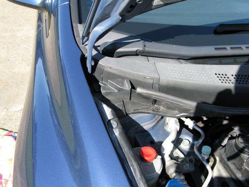

My 2007 Civic Coupe EX front strut boots have bitten the dust. Think I can do this? Jack the car and jackstand both sides. Remove the wheels with the spring pulled down, it opening the gap between coils. Place another jack on the brake rotor and raise slightly so it cannot drop any further down. Removing the cover around the wipers to access the center strut shaft and remove the shaft nut. Push the shaft down. With it down, I was going to take the boot bellow after it sat in the hot sun and slide it between the coil spring and over the shaft. Zip tie it to the stop bushing and attach the strut top nut. Anyone done this and lived thru it?

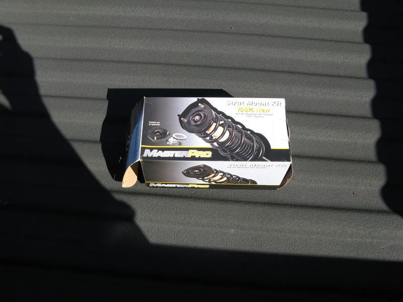

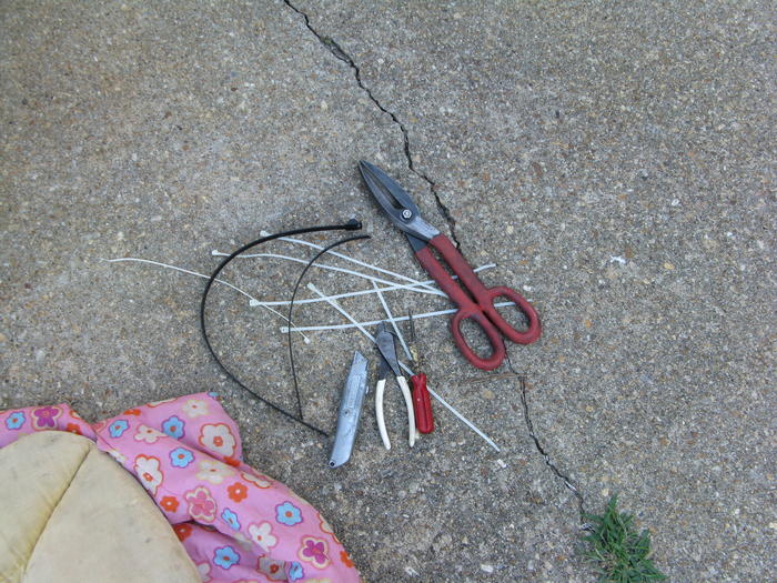

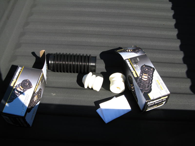

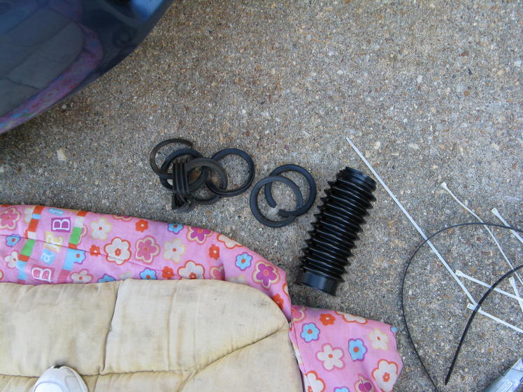

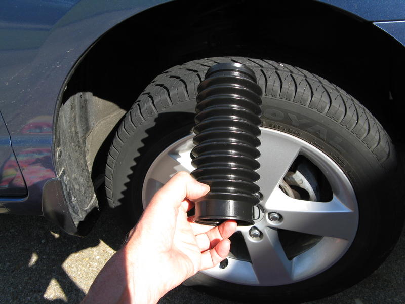

OK..all fixed and the lowdown. After regarding ezone's post. He is correct. Unlike my old Civic with the modified strut that had the spring separate, when you drop the shaft out, the lower end can pivot around. I have the draw clamps for the spring but since I was alone and figured the shock was probably gas and would want to stay up, I just fixed it like a 300Z that I worked on not too long ago. I simply took the $12.00 boot and split it. The I used a wide ziptie at the bottom and three more ever few inches up the noot pulled up so the V overlapped. Took all of 30 minutes. Not even necessary to remove wheel.. Just jack it up and set the stands. However, I pulled wheels to check everything anyway. Now I do not need to hear the dealer tell me I need to replace struts when he does free oil and state inspection. Thanks all, even lowlife whatever he means.
