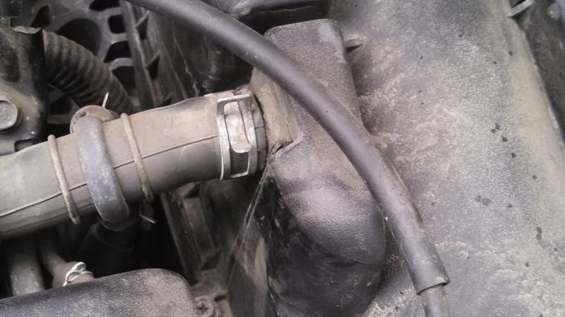

Welllll, when I went to pick up my car (just got an estimate, no work done) the mechanic said, "by the way, I noticed that the cover for your air filter is cracked". The part where the (?) air flow tube attaches to the cover is sheared off. You can't see it in this photo because I didn't want to displace it again, but the break is just to the right of the clamp. He said it shouldn't be a problem at all. I don't know when this happened, but I do know that he checked the air filter (even though what I had requested was an estimate on the struts/bushings), so would have had to lift the cover off. Maybe he did it, maybe the last person to check under there did it, but that isn't something I would have seen until after I picked up a new air filter. D'oh. So, is this a problem or simply cosmetic? It looks like a new housing will run around $90 plus shipping.

I've seen several of those nipples snapped out of the breather box over the years.
I think it probably happens when someone gets aggressive and doesn't remove the hose before opening up the box to check the air filter.
Anyone could have done it, so don't immediately blame the one that reported it.

Do I need to replace the housing? Can I "gorilla-glue" or duct-tape it back in place? Can I leave it as is? (it's butted up pretty tightly)
At the very least I'd want to seal it up somehow so it can't leak unfiltered air.
Silicone RTV gasket goo is usually the handiest stuff on the workbench LOL
Plasti-weld?
