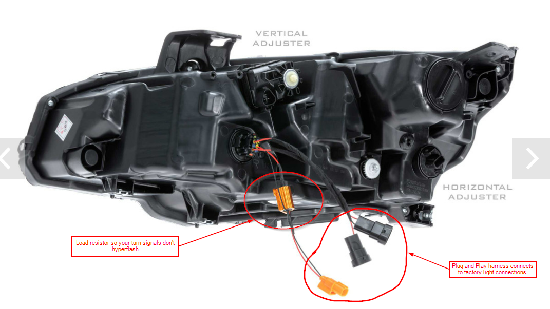

If you want to swap in the Touring model LED headlights, you'll have to get a conversion harness, then install load resistors so your turn signals don't hyperflash. Here's a conversion harness I found. Don't know how good they are, but gives you an idea of what you have to buy in addition to the headlights themselves, if you opt for the OEM route.
with regards to @sdaidoji and his recommendation for a retrofit, theretrofitsource does have a retrofit kit for the 10thgen, and I have a DIY guide laid out if you want to go that route. The light output for a retrofit blows halogens and OEM LEDs out of the water.
If you're set on the LED assemblies, TRS also makes a PnP set for WAAAAAYYYY cheaper than OEM assemblies, complete with PnP harness and load resistors installed. I mean, they'll still run you $615+shipping, but it's an option

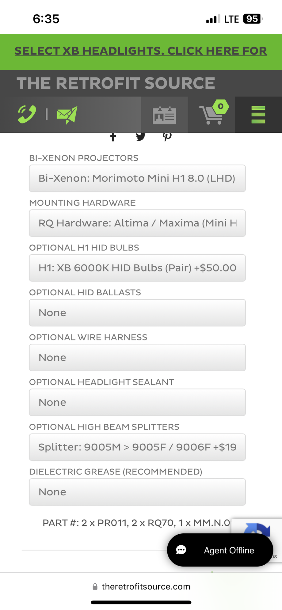

Thanks for all the info 😲 I ordered these. Would these be compatible with those lights, or were those meant to upgrade my current stock housing?
Old May 18, 2023
Rep Power: 511
Re: 2016 Civic EX: Converting from Halogen Headlights to LED
Those will be straight up plug and play with your stock setup. Nothing extra needed other than aiming them.

Would the selections I’ve made be enough, or will I need the other optional ones as well? And if I order the lights, will it come with both the high beam bulbs as well as the low beam bulbs. I’m not exactly sure what HID are. Sorry for all the questions, I just wanna make sure I get everything I need.
Old May 18, 2023
Posts: 15,176
Likes: 1,605
Rep Power: 367
I would recommend emailing or calling them, they are quite fast to respond, a day or 3...
I had not even bought from them and they answered my questions
So I bought stuff for my other cars as well as thank you
