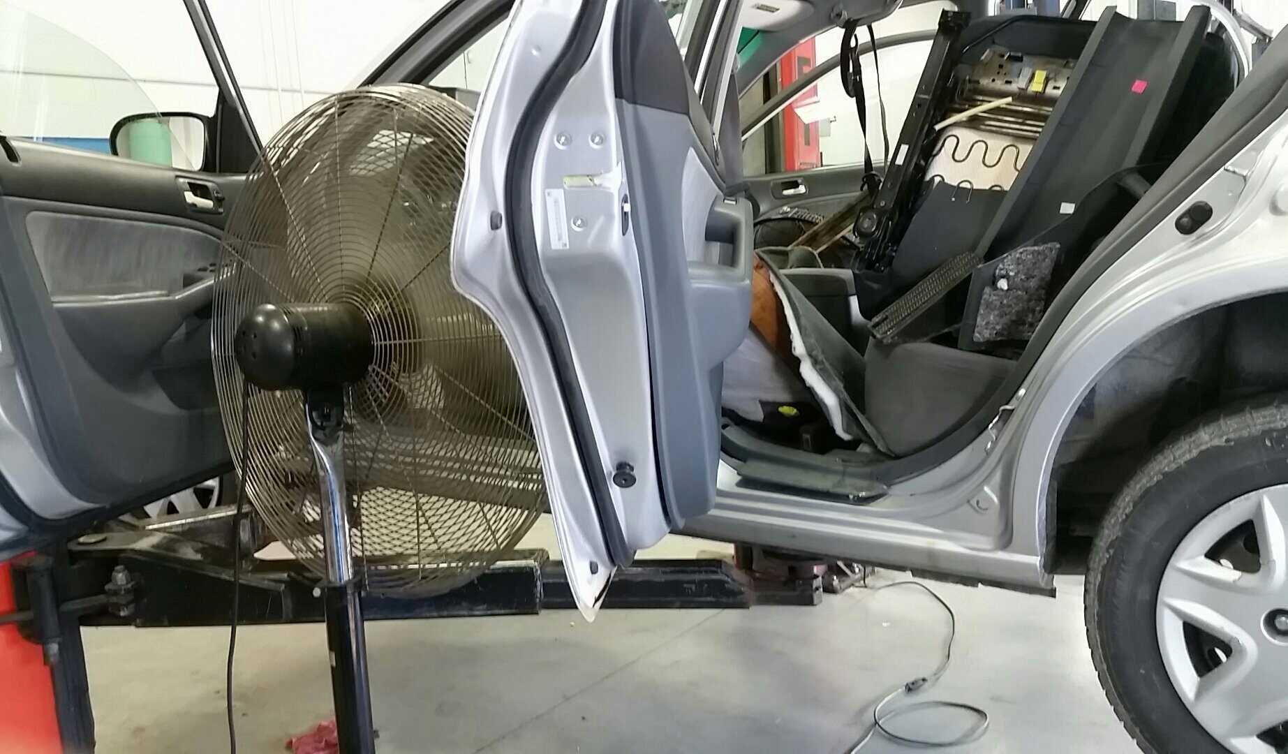

Remove all of it, lay it up on sawhorses or hang it over something like a long board or a pipe so it can dry,
Lay flat on pavement then hit it with a pressure washer?
It's gonna be one heavy **** once it's wet.
This is one way of getting it dried out when it hasn't had a chance to grow blue fuzzies, lots of lumber propping it up off the floor so air can circulate:

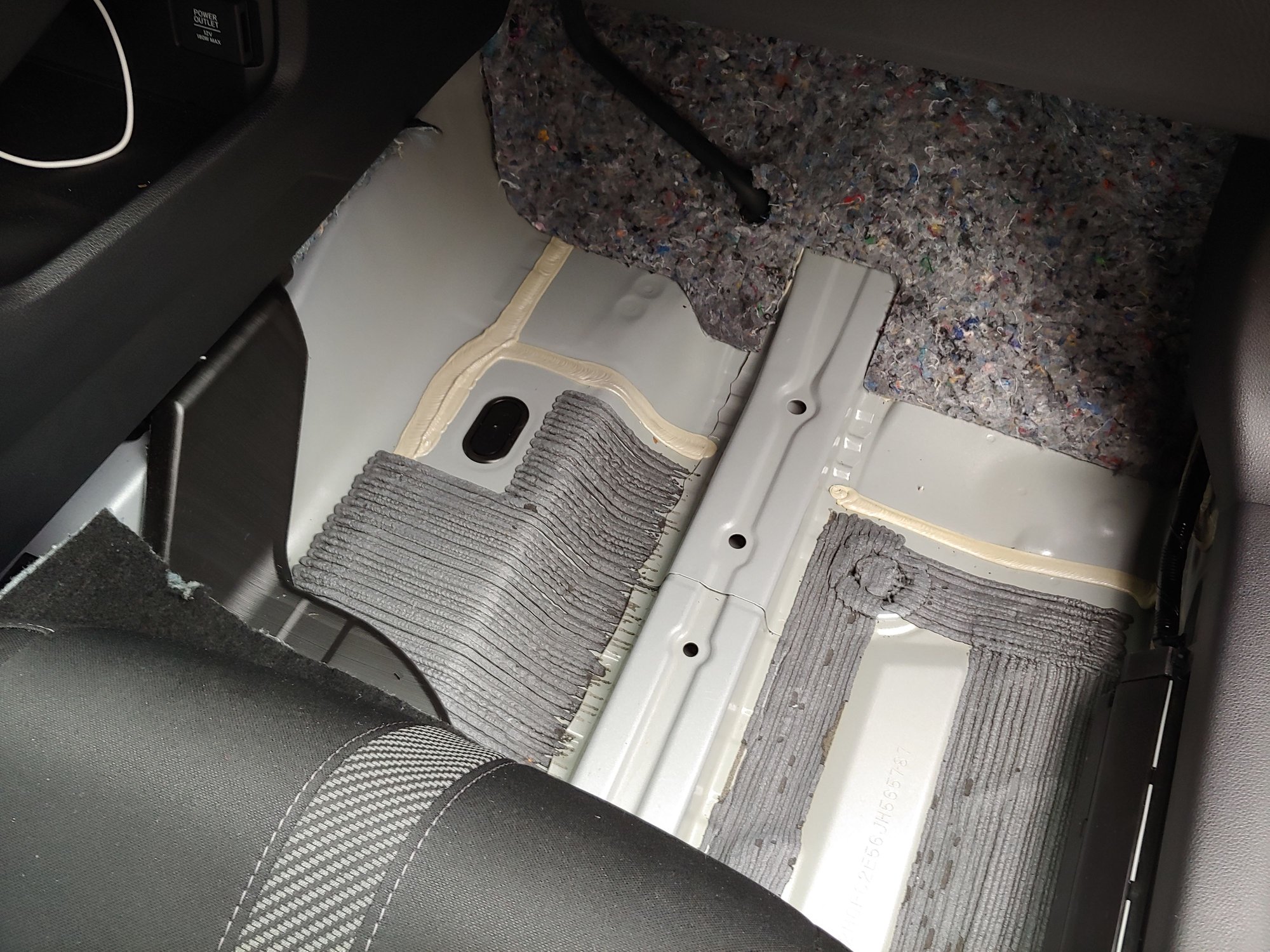

Well I ripped out the entire carpeting and noticed that the metal flooring design has what appears to be floor like beams with holes in them, all one piece. So it's truly impossible to clean.

Steam cleaner, antimold/mildew spray and compressed air, the metal is the easy part.
For the carpet take it to a carwash and spray the hell out of it with the pressure washer with the soap, front and back. And then hang it on a fence in the sun for a week to dry. Or use fans to speed it up.

The carpet is done, it's torn up. I don't even care about that. I've done several cleaning sessions and was convinced I got it cleaned up, only to catch an annoying wiff of mold again later on.
​​​​​​Fortunately, the water does drain out of those hole inserts, if you park the car on a hill. But thoroughly drying it is another story.

When water gets into those holes, it sloshes around and you can drain it by parking the car on hills but drying it will be a bitch.
Like I said, ridiculous design!

That's what the compressed air is for
