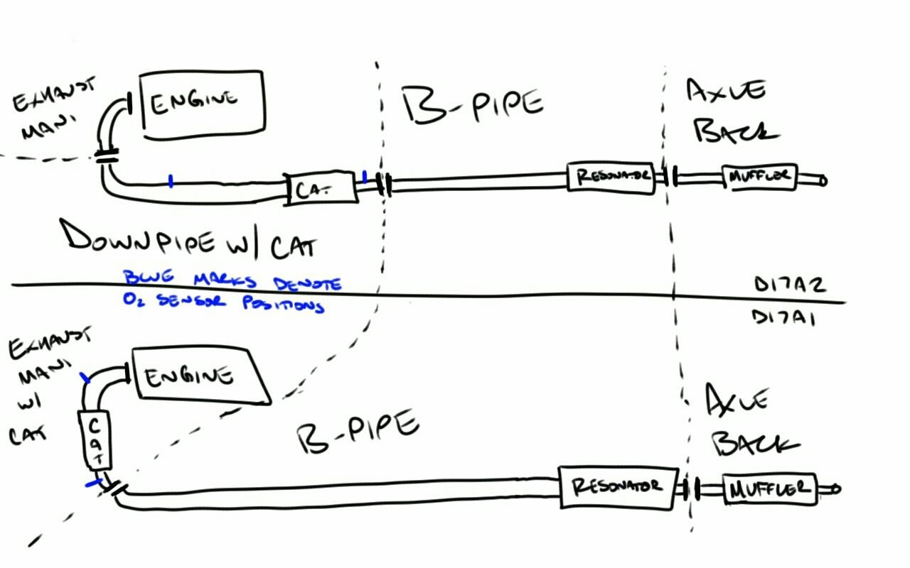

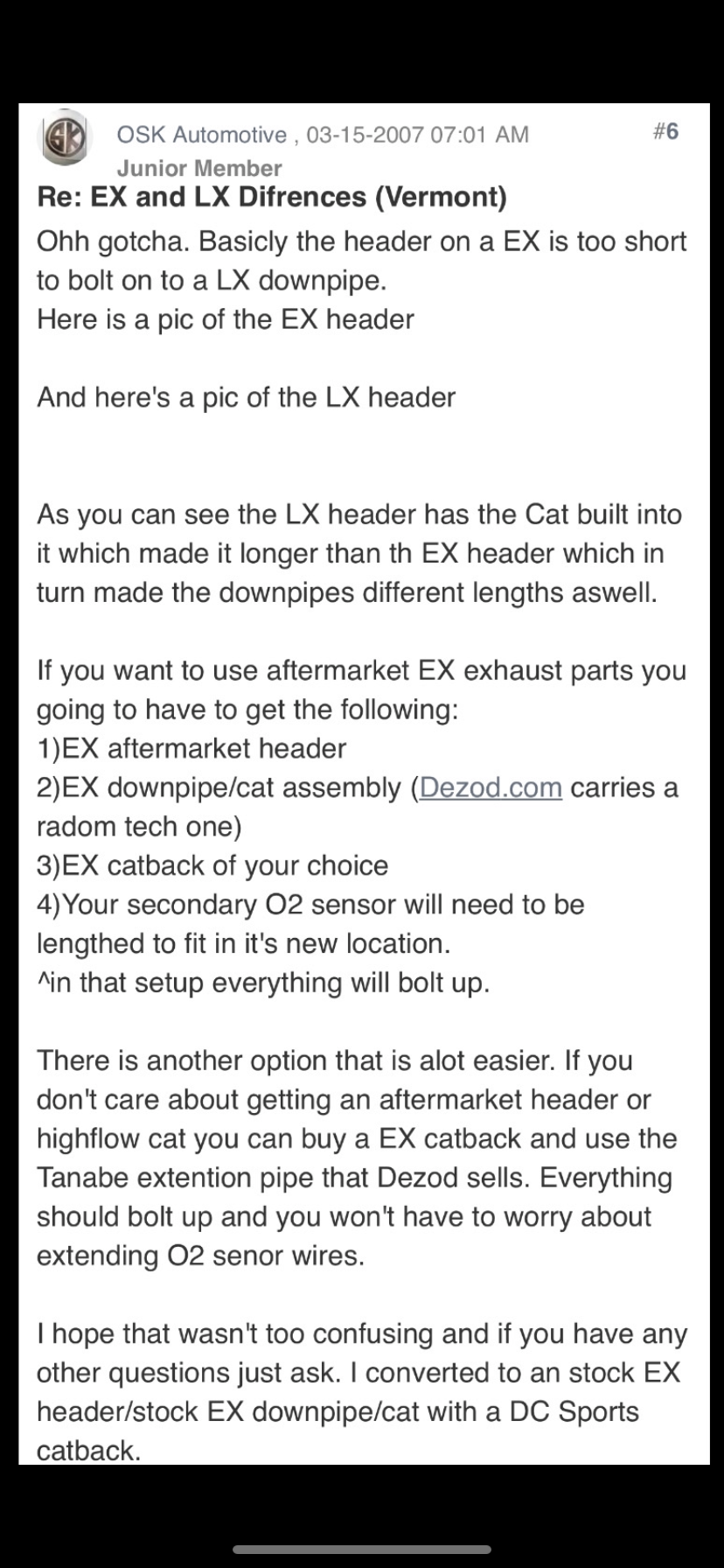

essentially, yeah. Here's a post of mine from another thread about the same thing
Converting to an ex setup basically just moves the 2 existing sensors further down the pipe. The LX/DX have the pre-cat and post-cat sensors forward of the engine bay. The EX has those same two sensors underneath the car, the pre-cat right around the 90-degree bend of the downpipe, and the post-cat right before the downpipe/midpipe flange connection
found an illustration I made a while ago about the LX/DX (D17A1) exhaust vs EX (D17A2) exhaust. Hopefully it sheds some light
link to said post: https://www.civicforums.com/forums/2...ml#post4785494
To add to that, the only thing that will bolt right up between DX/LX and EX exhausts is the axle-back. If you wanna change, you'll need the whole shebang
