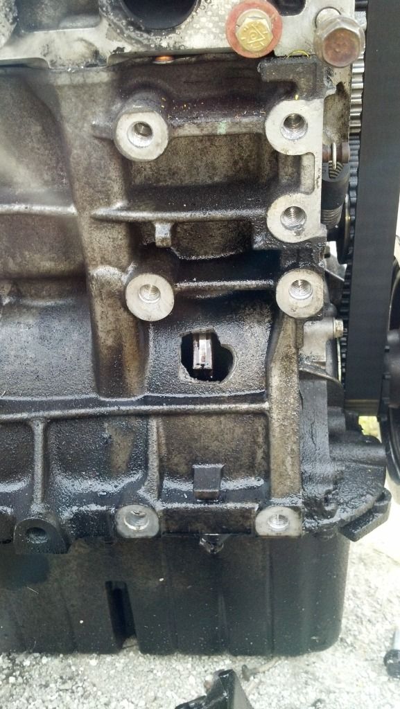

Alright well blew my motor up like when i say blown up i do it the right way it aint done till it wont start back up or things are fling out of it. Anyways theres a 2" hole in the side of the block right behind the a/c compressor braket so blocks no good.
The question is can i take a non-v-tech bloch and remove the head and put my v-tech head on the top an still have v-tech or is it one of the i need to run an oil line. The difference is 400$ and im sure i can buy some very nice looking oil line with 400$ to spare. So if theres some one who can point me in the right area give me pictures anything at the moment i need my 40mpg back. Haha.
This is the hole and snapped rod haha
I thought the oil was supposed to be on the inside of the engine.
Old Oct 6, 2012
Re: Non v-tech to v-tech ?????
It's only a little hole. I bet there is some oil left inside.
