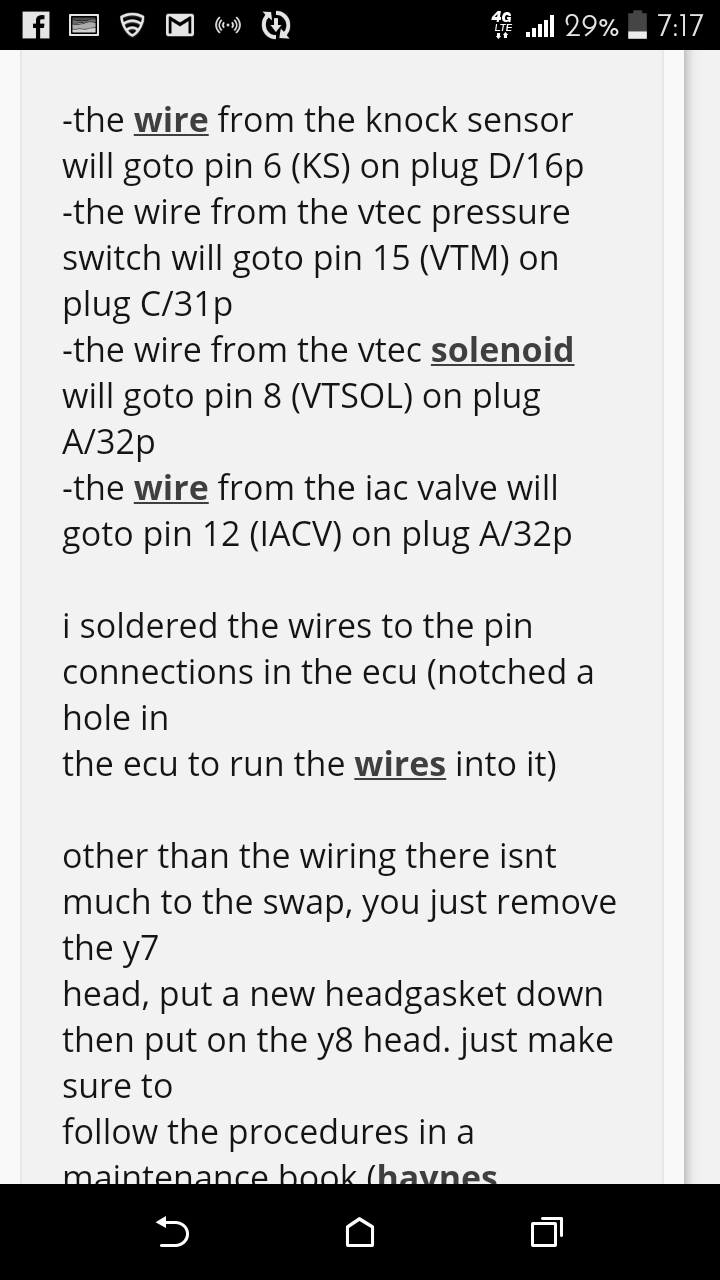

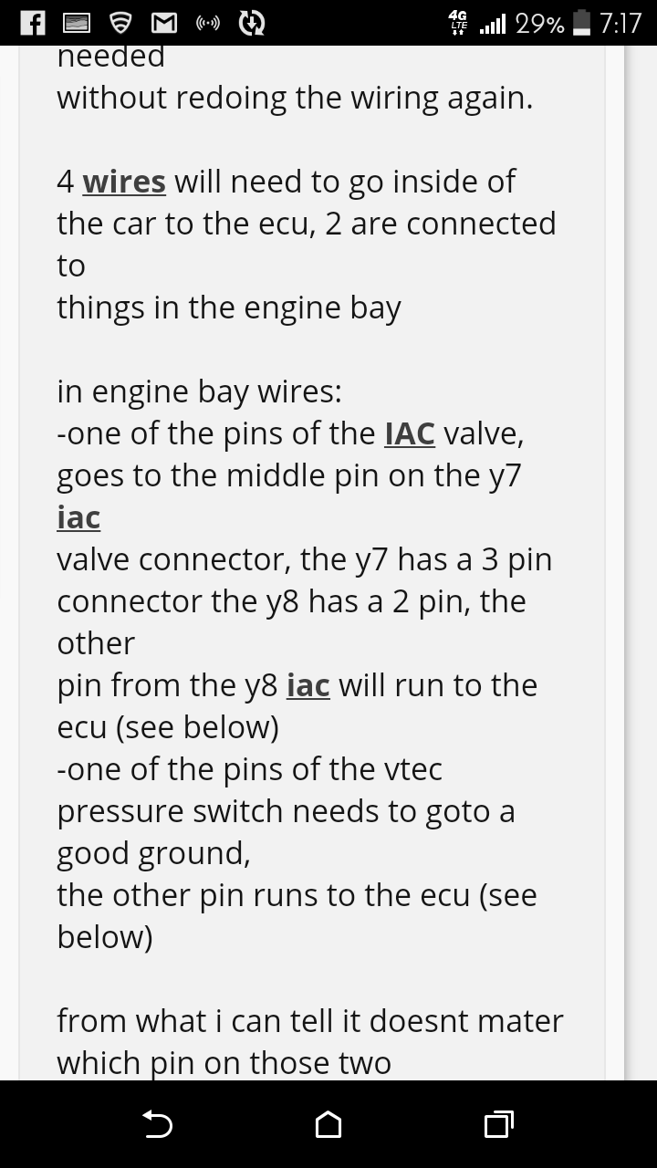

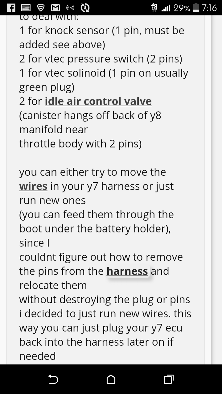

I'm doing the same with my dx, these photos might help you.
