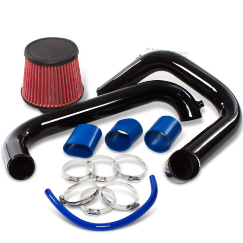

Finished making my CAI. I ordered one of these $50 kits off ebay:
PROS: it's cheap and you get a lot of pipe to play with. I was planning on doing just a shorty intake and leave the filter in next to the engine so I figured I would have enough to work with.
CONS: Fitment sucks, with using the blue coupler and intake tube the hood would hit the CAI. The holes for the air sensor and vacuum hose suck and don't hold the sensor. Also the vacuum hose that comes with the kit is too small to fit onto the port on the engine (not sure of the appropriate term)
So I also ordered a 3" 90 degree hose coupler and a 1/2" vacuum hose tube to complete my plans.

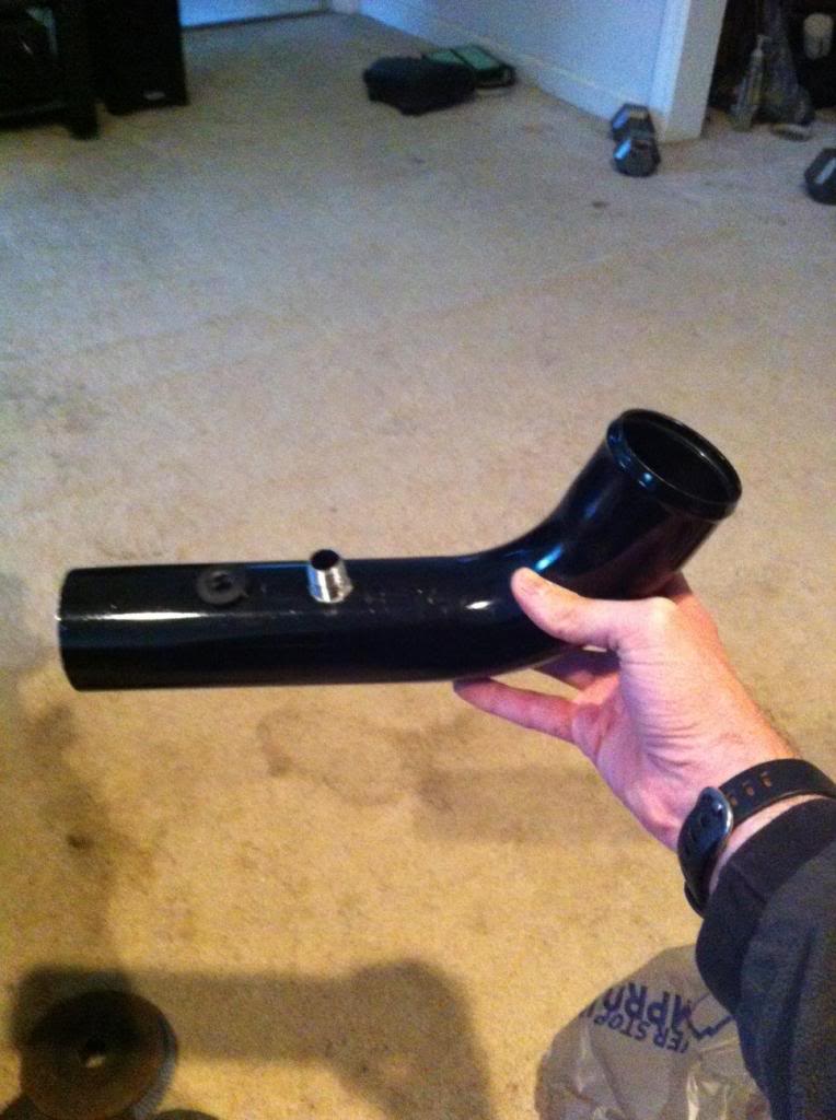

I cut down the original tube and used a unibit (step bit) to drill 2 holes in the tube. One for the air sensor gasket and one for the vacuum tube, just be careful not to make it so big that the gasket doesn't fit snug. I removed the original air rubber gasket from the factory air box and pressed it in the tube. I also got a 3/8" galvanized pipe nipple from Lowe's and was able to thread it into the hole. Then I thread it some more with a wrench and it felt pretty darn snug but I added some JB Weld to it for good measure.

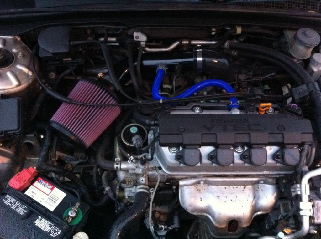

Then just installed the new tube, cute my vacuum hose to length, and extended the wires for the air sensor. I put a K&N RU-4860 on it and took it for a spin. Trimmed the vacuum hose a little cause it had a little kink in it and it's all set.

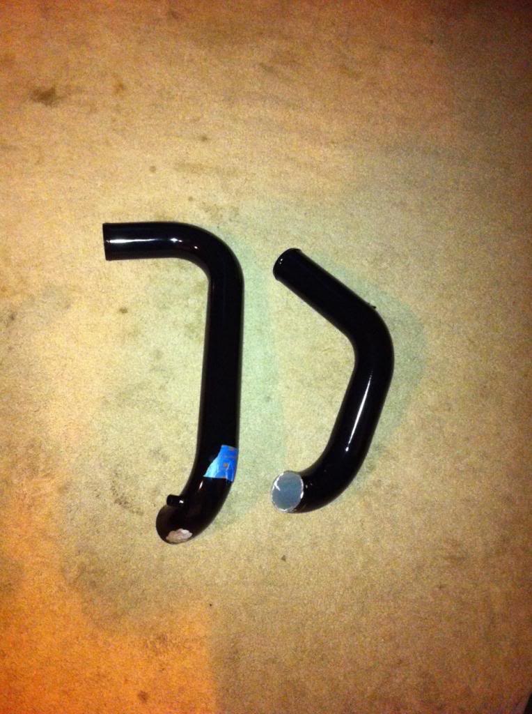

Here's the left over parts from the piping, such a waste:

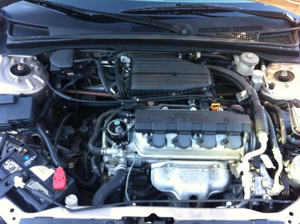

But overall the car runs good and sounds pretty good, a little louder from the 3k - 4k RPM range but not terrible. Sounds about the same at 60mph. I had originally just taken the resinator box off the engine and it droned like crazy around 3500RPM but wasn't terrible at speed.

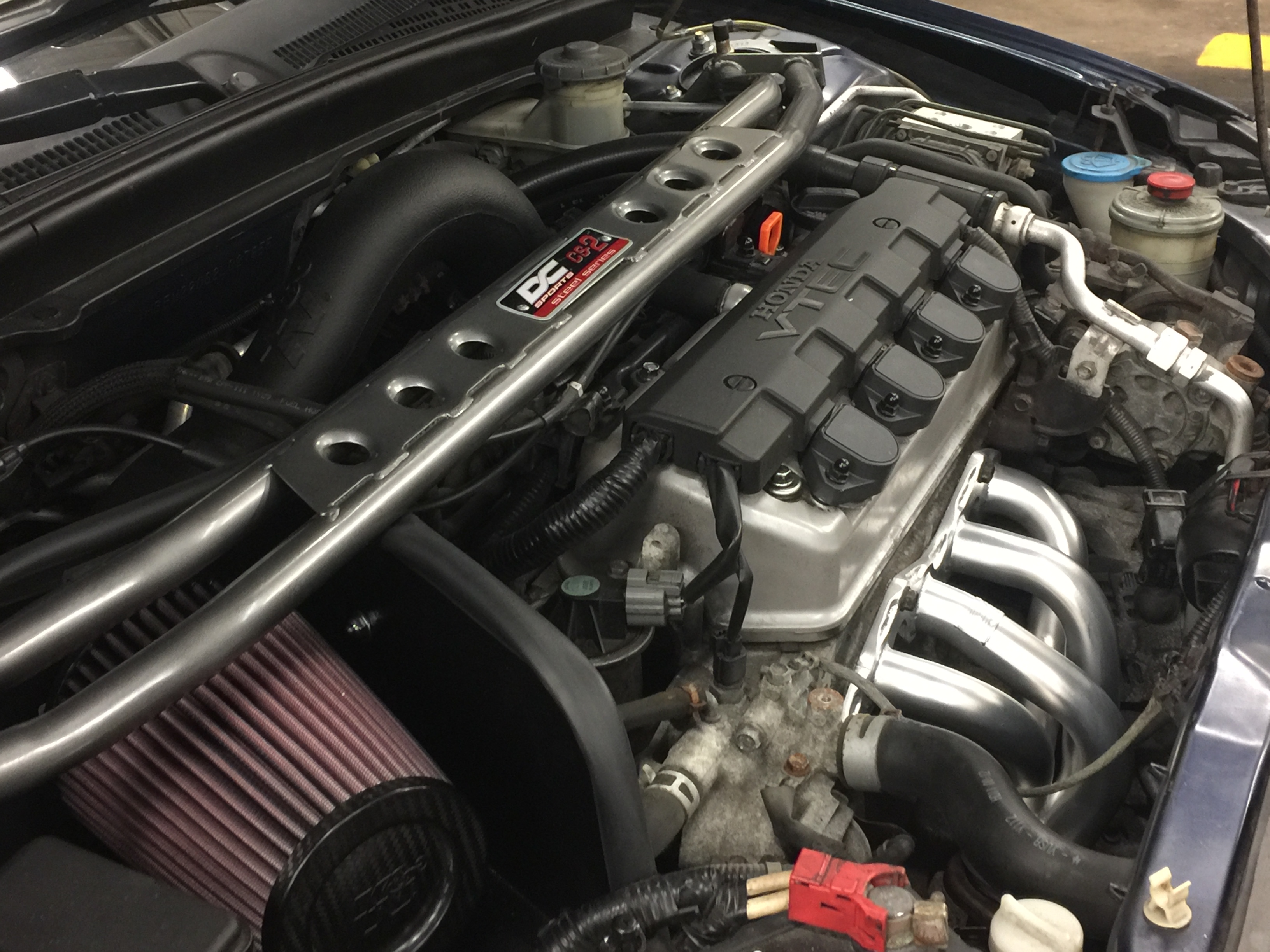

K&N Short Ram Air with Heat Shield.
Installation/Fit 5
Power 2
Sound 2
