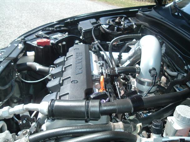

AEM V2
Fit : 3, touches my battery, bracket broke, rubs against clutch line, clamps dont all fit.
Power : 4, you'll know it's there after 3000 or so RPM...
Loudness : 5, It's loud! Makes my ear ring if I keep it above 5500 RPM with the windows closed.
AEM V2, it's a SRI NOT CAI.
This is a SRI, not CAI. The length is just slightly longer than a stardard AEM SRI.

some ebay SRI
Fit 1 to 5: How well does it fit the car without or with modifications
2.5 it was to tall and hit the hood so i had to cut about 1/2 an inch off the pipe where it meets the engine
Power 1 to 5: 2-3 didnt notice any change for low end.. it makes a nice noise from about 2500rpm-4000rpm.. feels like i can accelerate better between 65mph and 75mph but that could just be all in my head
Loudness 1 to 5: 4 between 2500rpm and 4000rpm other than that it sounds the same
After the name is the type and material: SRI, AS
it came missing a clamp but well.. thats no big deal cuz i noticed before i started taking things apart.. after i noticed that it was rubbing and i cut the pipe and then repainted it.. the few extra coats of paint and clearcoat changed the sound a bit.. it had been a lil "tinny" sounding but the paint thickend it up just enough that now i think it has a nice sounds.. the filter also came dry but i hit it with the k&n recharge kit and now i feel that it works just fine
http://img.photobucket.com/albums/v2...r/PC040031.jpg
i have an auto.. so for whatever "gains" id get off the best intake ever.. its just not worth the money (to me anyway).. it looks nice.. makes a nice sound.. good enough
