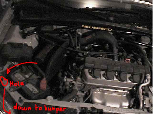

Alright look at the pic, there is a hole where an intake tube can be run through to go to the front right bumper(or atleast in older civcs this is what that hole is for), if you open up this hole the ram air tube can fit through there and run to the front bumper. The way i have mine right now is going under the battery and through a long hole where (if youve seen SF's turbo kit its where the tubes are running through to the front bumper) then it goes to the front bumper. Also you will need to mount the scoop pretty far out on the bumper to avoid such a huge bend, its pretty much level with the licence plate.

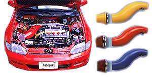

Oh yea this is a super inlet intake haha like it? its unique!!

Ok, in the picture marked 1, that's how the Ram Air tube attaches to the Weapon R intake. I guess in this case, it not only brings colder air up to it, but it also forces the air into the intake (the purpose of Ram Air) and therefore creates more power.
But I wonder if you could modify it to fit with an intake filter that doesn't bring in air from the front, such as a K&N filter (picture marked 2). In this case, it looks like the tube would just bring up colder air that the intake would suck in, but it would lose the "Ram" effect.
What do you think?
IronFist

Hey, I checked out that hole that you pointed out... I don't think a 3" diameter pipe could fit through it. It looked kind of small. You mean the hole that's in the frame behind the right front headlight, right?

yea that hole needs to be opened up, im doing that today.
