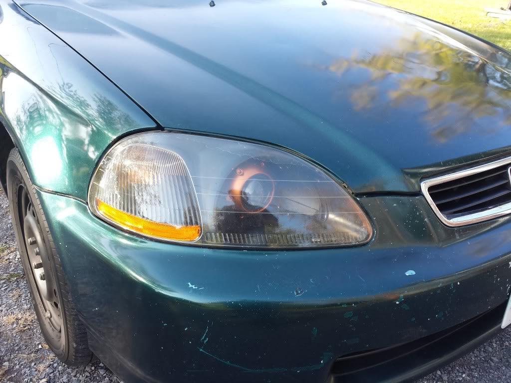

97 Civic EX. bougt a set of stock replacement headlights from Ebay for 60 bucks. already had a set of Morimoto Mini D2S projectors from retrofitsource.com, so I baked the new lights and puled them apart. the projectors slid right in like they were made to fit in there.... Granted they pretty much were, but oh well. Dont judge me. Finally got around to ordering my bulbs and relay harness last week. parts arrived today and they are finally IN!!
I used GTI shrouds, and since the chrome was all donked up on them I painted them... Copper.... Now that they are on the car Im not sure that was such a good choice. Oh well. I will run them like this for a while and if I cant get used to the color I will order a set of new shrouds and leave them chrome.
I had taken pics of the assembly, but my phone crashed and I lost them, so all I have are my installed pics from today. assembly was really simple. I mean Geico caveman simple. If anyone is trying to do this and needs help I can easily rip one apart again and take pics of it all.
Now without further ado, here they are...

Crappy pic, but Ill get a better one later once the sun is cooperating with me...

Looks kinda wonky compared to the TRS shrouds.
But still cool nonetheless

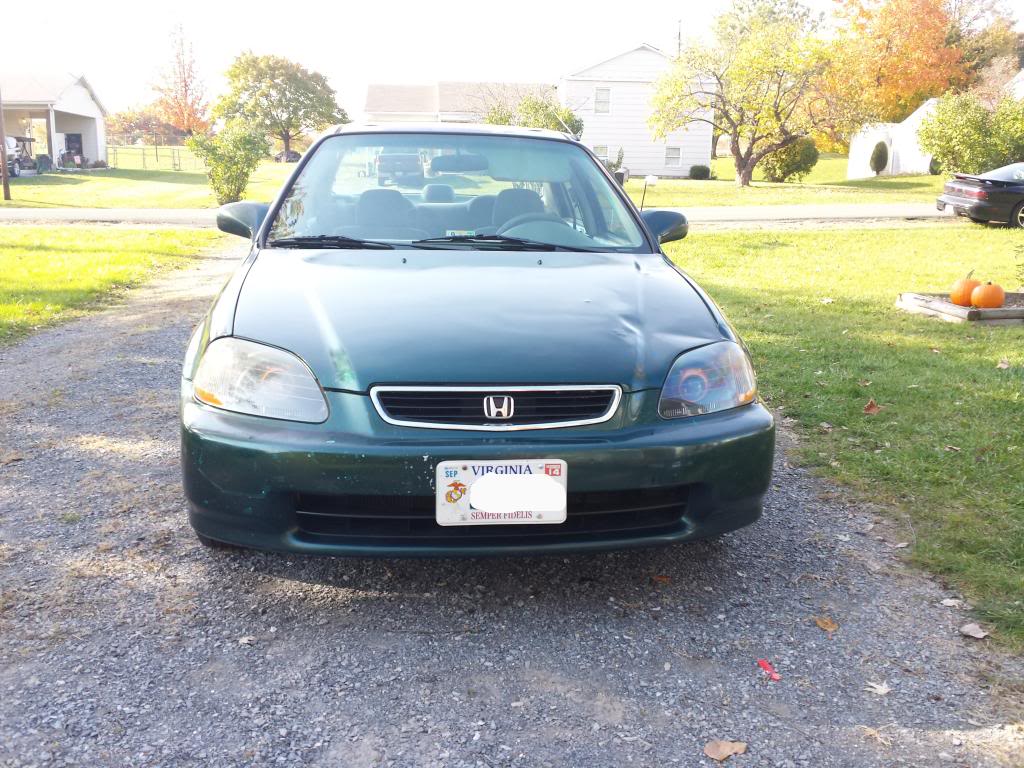

and last night I went out and found a blank wall to aim these on... Guess the alignment is a little off. Oh well. I tried to use the CNC cut alignment plates that came with the projectors. guessing they are off. headlights are in the oven now baking so I can tear them apart again and remove the plates. I will align them by hand. And I might respray the shrouds.....

Yea, they are a little wonky!
Might be a good time to paint your cutoff shields if you wanted to do that. Will add a cool color look when you look into the projector!
I do like the copper color, but not with your color car. Would look better on a black car.

yea, shrouds are black now.... Paint the cutoff shield? I have never heard of that... I have put a small LED inside the projectors before on a guys bike I retrofitted, but never heard of painting the shields.
Just went out and aligned them. no they are baking again so I can press them back together. Ill get better output pics later tonight. I'm running 55w ballasts with 4500K bulbs... I like being able to see at night....

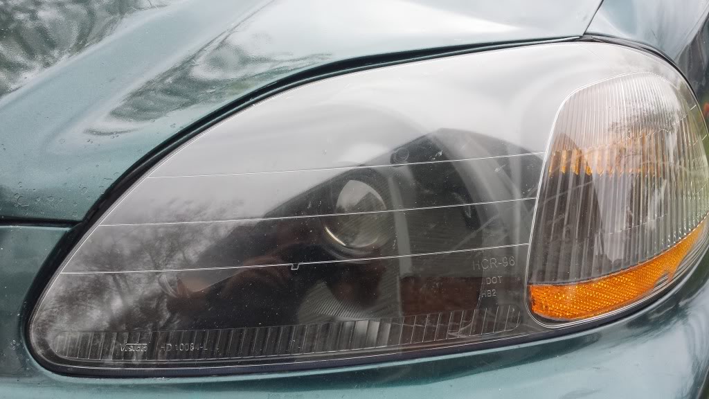

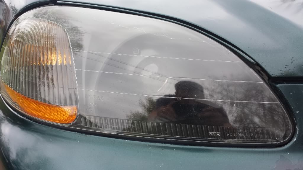

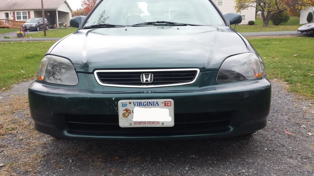

OK, got them back assembled and in the car. all blacked out. looks a lot better. The green and copper just wasn't working on this little Honda. years ago I had a Mustang that was green with copperish gt stripes. guess this car just cant pull it off. Oh well.

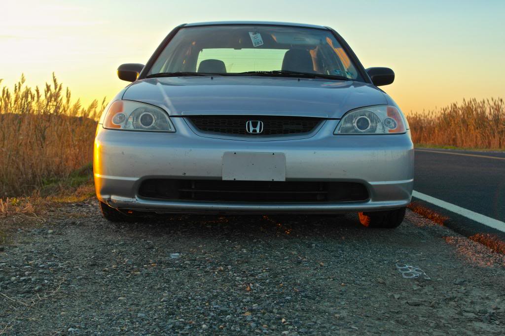

If you paint the back of the cutoff shield, it will make it appear like your projector glass is colored. There is a thread somewhere on hidplanet that shows different colors. I painted mine black.
Here is the thread:
http://www.hidplanet.com/forums/show...hield-painting
