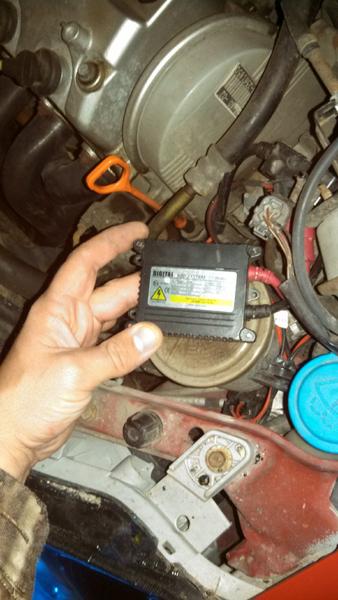

I just bought an 97 civic and I'm a noobie to the civic world. The guy I got it from said he put hid lights in it. It is wired up and has electronic boxes in the wires that say it takes a 35 Watt bulb. The low beams light up blue and could stand to be a bit brighter. The high beans shine a yellowish light and are awful. I need to do something here. I can't be driving without at least better high beams.

The boxes are the ballasts for the HID kit. How many boxes are there total? Sounds like he put two seperate sets in if you are getting two very different colors when they are low vs high.The color is nothing more than the "temperature" of the bulb, so when you look at bulbs you want, 4000k will be in the Yellow range while 7000-12000k will go from white/blue to blue to purple.
Ideally for best visibility you want to go with a 5000-6000k bulb. Should be able to figure out what bulb(s) it has by removing one (dont touch the glass, skin oils+bulb=bad). I get my HID stuff from TheRetrofitSource or DDM tuning.

There are two ballasts, one on each headlight. And I did take the bulb out on the passenger side. Looks like both bulbs are made as one unit.

Sounds like a crappy aftermarket system. +1 to TheRetrofitSource. I'm waiting for mine to come in the mail. I agree with everything else BRBRT03 said except 4300k is technically the brightest (sunlight-colored). Not the WHITEST, but it has the most usable light. What brand is your system? Can you get a picture of the setup and lights/pattern?

Two distinct tubes or is it just one single tube? I just had to look up dual HID bulbs, never seen that before. What brand are the Ballasts?

Sounds like a crappy aftermarket system. What brand is your system? Can you get a picture of the setup and lights/pattern?.
Please do. Im pretty curious as to what those are

Two tubes hooked as one unit to plug in.. The ballast says digital hid system.

Well from what I see from search Google, this system doesn't have high beams. Most other people that have it say when they switch to high beams the lights go out. Why the heck would someone install these!? Lol
Because Cheap
Because "cool"
Because Racecar(a=i).
I highly recommend getting a real HID system from either DDM tuning or The Retrofit Source. DDM is the cheaper option but is a good quality system for the price. The ideal way to go would be retrofitting projectors in but that gets pricey.
Or go back to stock, either way. Hopefully the PO didn't cob up the wiring when he put those in. My kit piggybacks off the factory bulb sockets to control hi/low and just has a power wire that links to the battery. Easy to remove
You want a Bi-Xenon system with the relay built into the harness.

This kit is plug and play. Doesn't look like anything was cut, just plugs into the factory harness. So if I unplug this kit I should be able to just simply buy the standard bulbs and plug them in? Also will the factory lights be bright enough? I would put a good kit in it but with Christmas ice not got the money right now. I'm not a tuner I just got the car for mpg for work. Thanks for the help guys
Should be able to. If your going stock bulbs I would go with Sylvania Silverstars. A few bucks more, but worth it for Halogens. As good as you get without going HID/projector.
