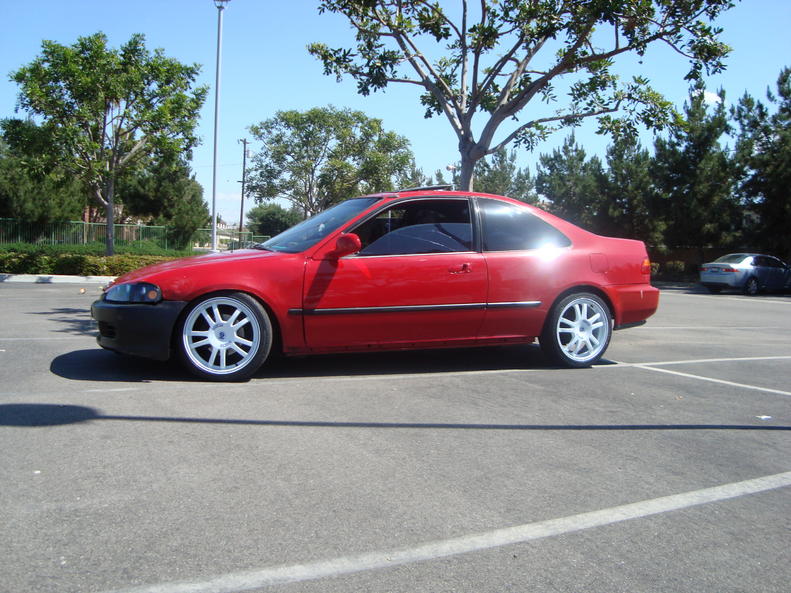

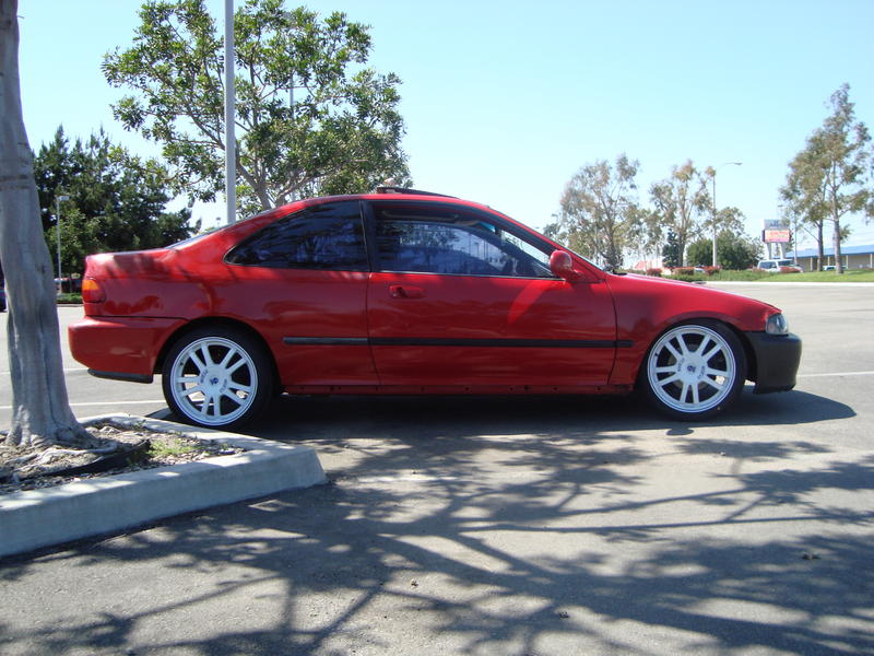

my '95 civic is slightly higher on one side and the rear is slightly higher than the front....how can I get both sides and front/rear to be all equally level?
on top of that....my tires still rub my fender, even after getting the fender rolled,it started denting my fender and chipping the paint off.

if you have coilovers then adjust them accordingly. If not you need to understand that if you have the same spring rates all around then that is normal after the seating and break in. The motor is heavy, thus front end droop. Driver side prolly sits lower cuz you weigh 100+ lbs, and that compresses those springs more. Unless you are running stupid wide or tall wheels, you shouldn't rub at all, especially with GOOD fender rolling.

yeah the weight of the car is not perfectly centered from right to left. if youre rubbing, wheels are too big or you lowered too much, or both.

what suspension mods do you have for starters?

I have skunk2 sport shocks....blox competition lowering springs and 17' sparco rally rims(off set 43) with 205/40 tires

And you could install adjustable sleeves to compensate for the springs - you are too low.
And wheels could need more off-set, but i am not sure.
