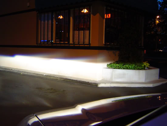

that guy is the man, tons of great info over there altho he is pretty set in his ways and doesnt like a lot of the newer tech coming out. i guess i dont either tho lol. too much flash and bling over function. i went the illegal (but technically like legal) way of stuffing in an older audi a4 hid projector into tyc projection housings. been holding up fine for over 2 yrs now. no glare, nice bright beam but not too bright. nice colors too. from above the cutoff it looks like park lights.
