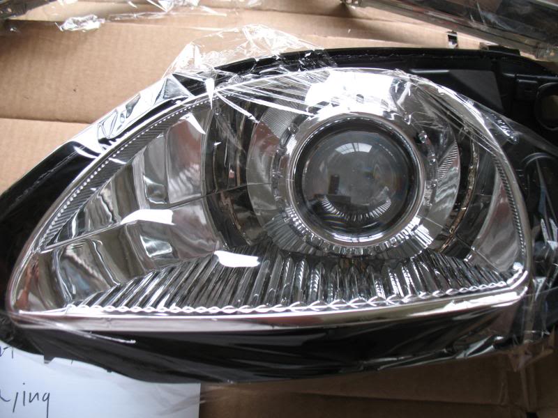

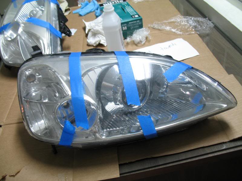

hello boys n girls.
i just finished it....so ill share it. there are some other DIY on here so there is no need to make another one.
it is literally a plug and play projector
this retrofit took me about 2hrs (from baking it open to sealing it shut)....yes thats right TWO HOURS total for both headlights.

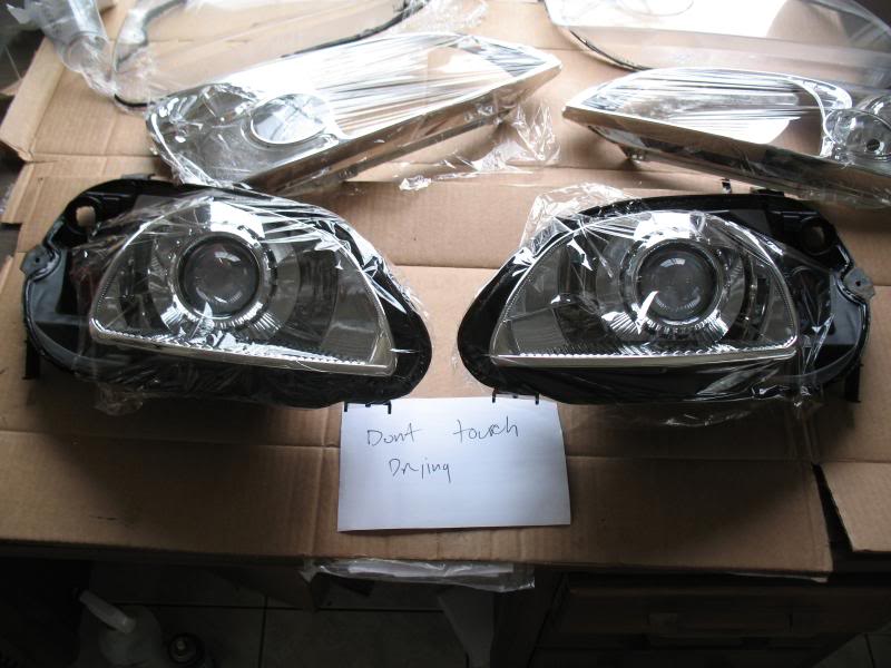

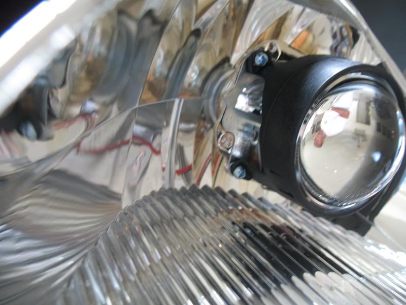

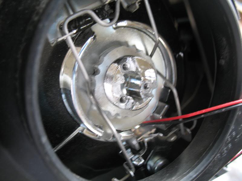

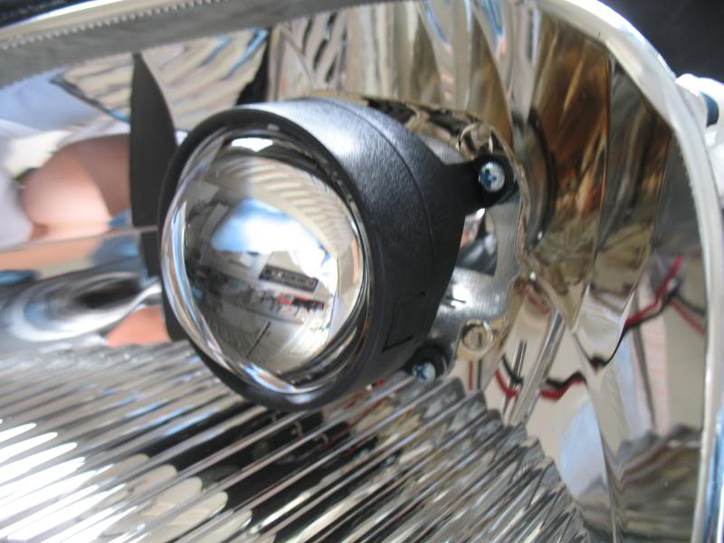

rear of the projector when everything is plugged in.

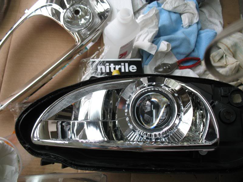

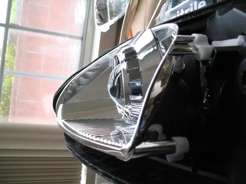

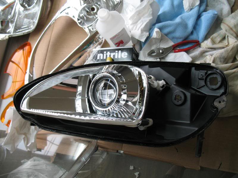

i used an E46 shroud instead of the one provided. i like the E46 look better.

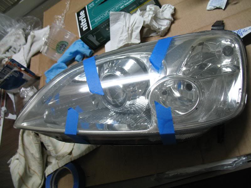

suran wrapped it so dust wont get it while i cleaned the housing

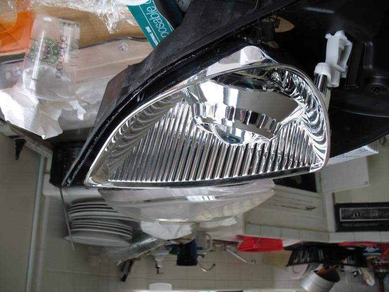

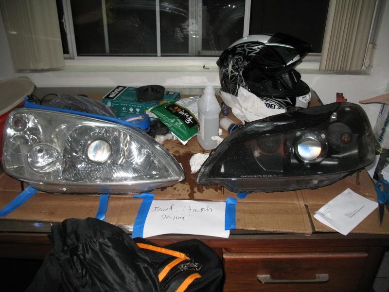

reheat it in the oven and put the lens back in. take it up shut n leave it for 24hrs

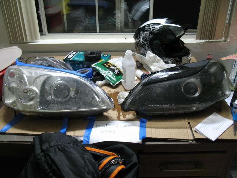

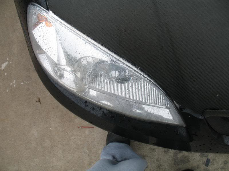

new retrofit on the left, old temporary retrofit on the right

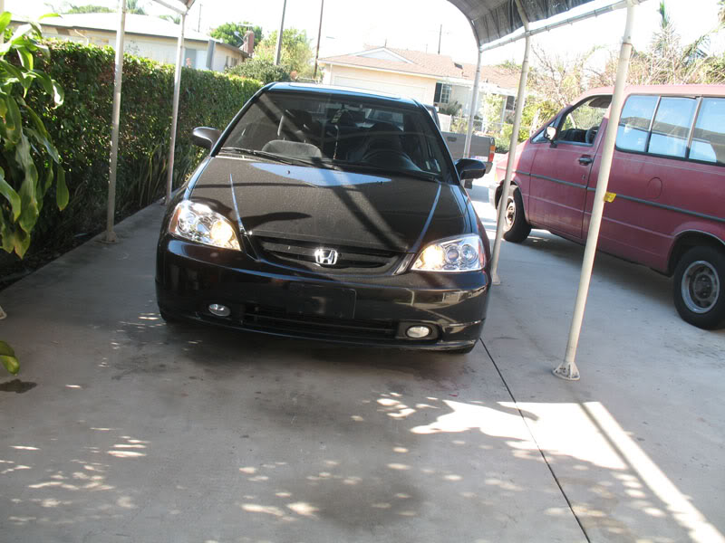

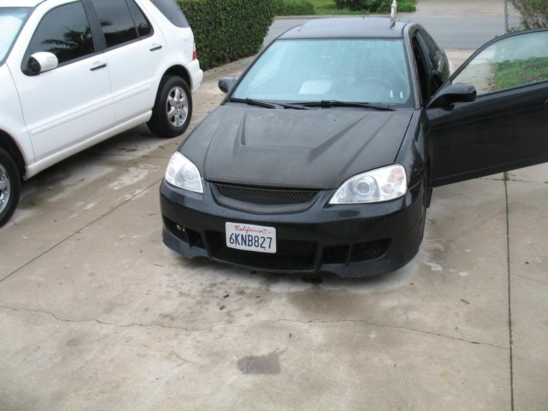

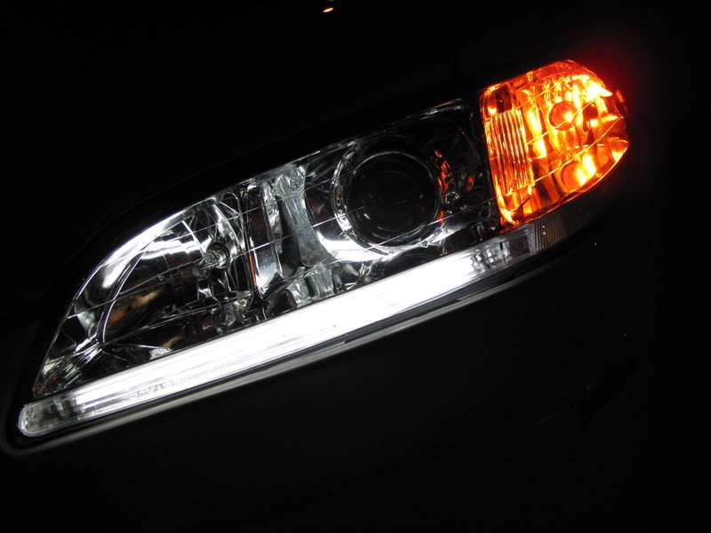

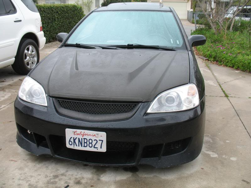

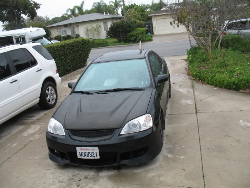

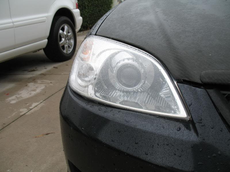

on the car. sorry it was raining outside

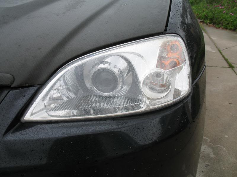

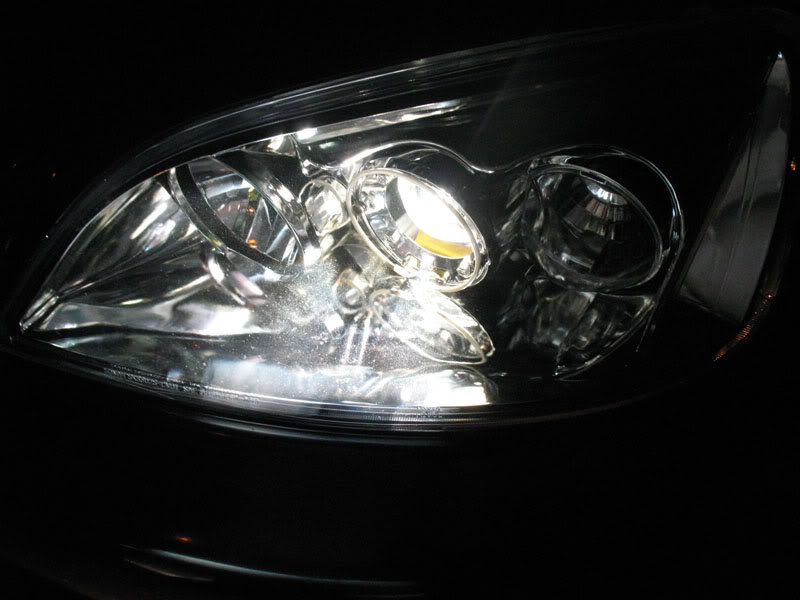

left:
right:
top view
all good/bad comments are welcome.

my thoughts bout these projector:
if you are an experience retrofitter and have experienced a variety of projectors like the: TSX, TL, e46, FX, LS, IS or s2k projectors (ive done retros on all these), then you will be disappointed with these. especially if you are aiming for the BRIGHTEST output possible.
the output is decent. if on a scale, TL projectors would score a 9. stock headlights would score a 4. the morimito H1 will score a 7.
ok, let me set something straight. these morimito projectors are WAYYYYYYYYYYY better than stock halogen or HIDs in stock reflector. WAYY BETTER. NO COMPARISON. PERIOD.
with that said, what good are these projectors?
1. they are SUPER AND HELLA easy to install. and for a beginner, that new retrofiter, that should be the selling point. cannot go wrong.
2. you dont have to calibrate strightness of the cut off lines. everything is pre-done. ur retrofit cut off line will look as good or almost as good at stock. they're not crooked.
3. damnnnn good output compared to stock. more than you'll every need (people like me excluded who have experienced such projectors like the TL or s2k...but those are 2x-3x more expensive.)
4. cheap (price wise). they are 120+shipping. shipping was like 8 dollars and they came within 3 days. good shipping time.
http://www.theretrofitsource.com/pro...b0c35ca45495f5
5. fast turn around time. i finished in 2hrs. i understand most people arnt experienced as i am, but i could imagine these taking no longer than 4-6hrs to finish from start to finish.
6. bi-xenon. yes they are. the highbeam is one of the best ive seen. good amount of light throw.
7. very very small foam factor. they are also super light so the stock reflector will hold them easily.

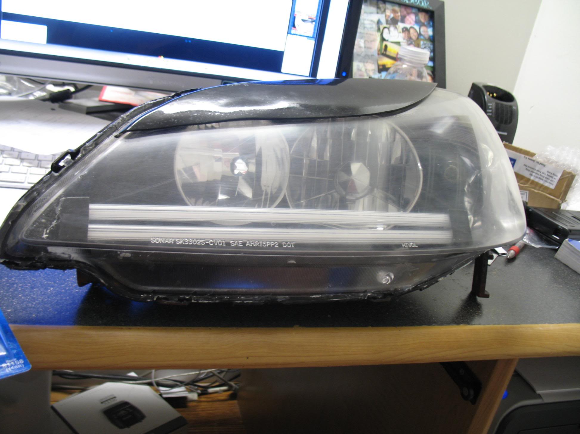

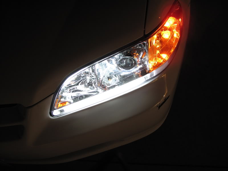

and for the hell of it, here are some of my other retros
first retro on my civic. tsx in egay headlights
G35 HID reflector in some housing for fun + wanna be audi eye lids (when this fad was in)
girlfriends accord TSX retro:
