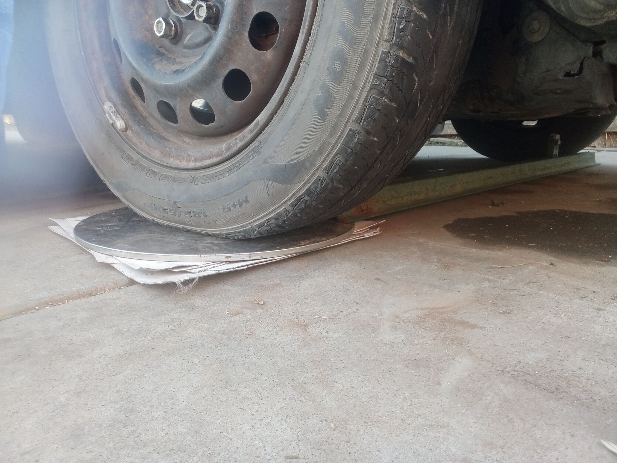

  1. Run a straight piece of metal along the length of the car with a bubble level in the center
  2. Add spacers underneath passenger side tire until the bubble level showed level

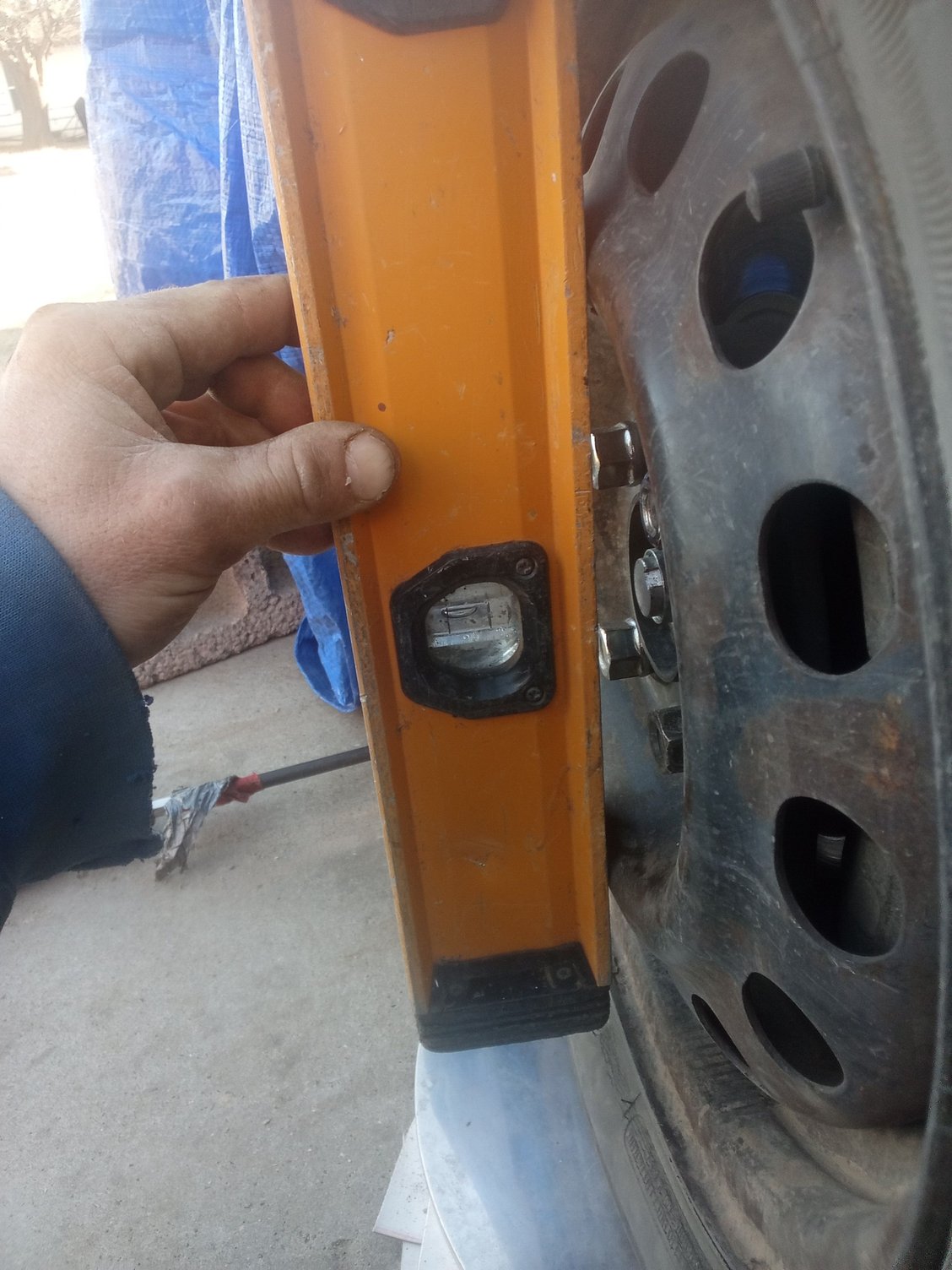

  3. Put a bubble level along the wheel to check camber
    Driver side
    Driver side (I was in a wreck)
    Passenger side
    Passenger side (I was in a wreck)
I only added spacers to the passenger side since my driveway is slanting down that direction. I did not check if the rear tires were level, and did not add any spacers to the back tires. IS THIS A PROBLEM? I didn't think I needed to level the rear tires since I'm only checking camber on the front tires, am I wrong?
Did I do this correctly?
