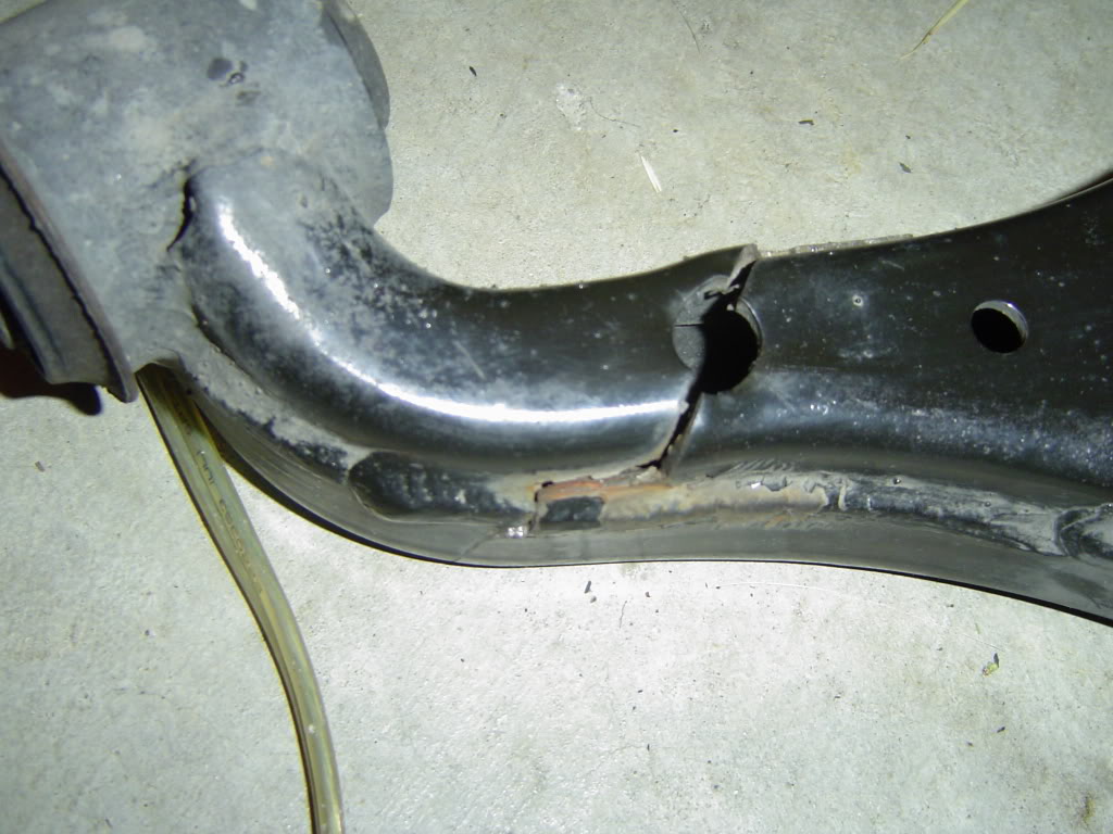

the bolts on the miata are just examples. civic case could be worn bushings (likely) or other stuff worn or damaged, so recommend taking stuff apart once (not as much work as my miata, actually
) and inspecting them. Could even be bent arms. Mine arms i had one cracked
Yeah, i know, lazlong, here it goes for the 4th time!
Again, it could be anything wrong in the suspension.
so check the ball joints and other stuff too,even the top mounts... like i said, took some years until i found out the real culkprit, because i never took the arms out at this level before. I had more time since my tires were wearing normally, though.
