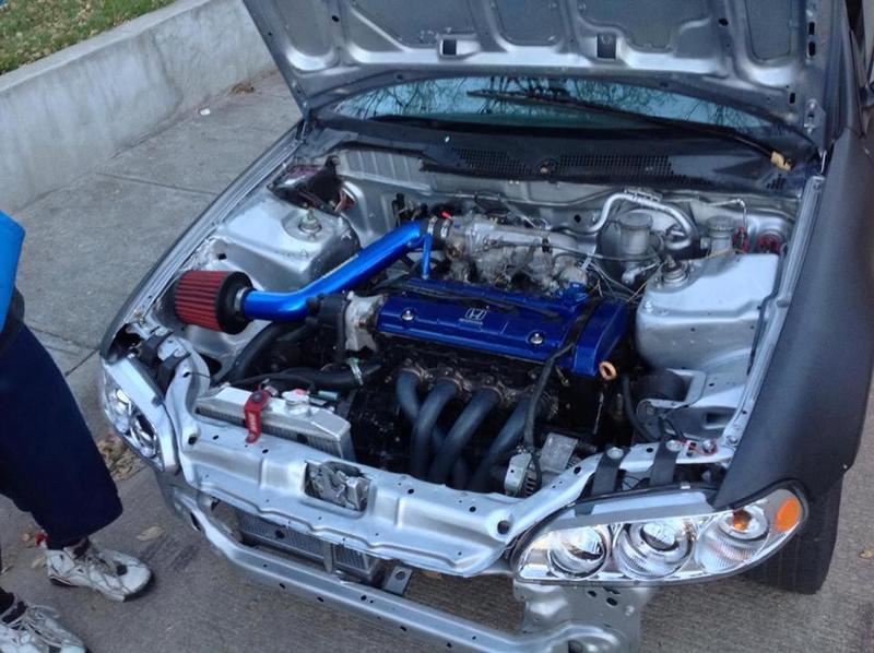

I drive a 94 honda civic hatchback with a swapped h23a1 from a prelude in it. The dash and most of the whole car shakes violentley when accelerating and less but still does when at idle. All the suspension checks out fine. Could this be bad engine mounts? Please help!

Since it is shaking at idle then it's engine related. Motor mounts would be a good place to start. It is possible that when the motor was swapped polyurethane bushings were used instead of rubber. This will make you feel more vibration. It's also possible they are worn.

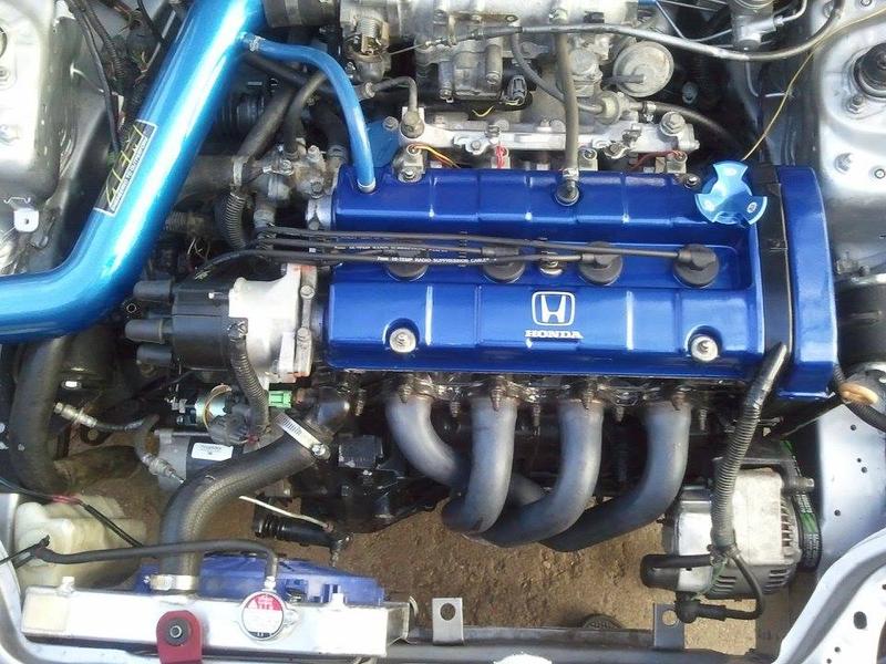

I believe they are polyurethane mounts but not sure. Here is an engine pic I have but you cant really see them.

Hard to tell from the picture
