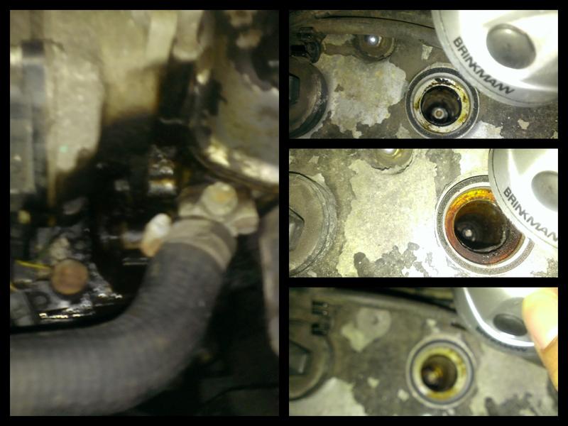

It was raining today so i didn't try the spark plug thing but i did switch out the starter and now there is a very weak wah wah wah when your turning over so at least moderate improvement. Sorta sounds like a dead battery in the way it's trying to start up but the battery is good. Attached some pictures. Would the starter make the temp guage go down? I'm thinking if the car was losing power maybe that caused everything to go haywire? I'm gonna try the ignition coil where i see the fluid but it definitely sounds electrical. If not what else should i be looking for?

Scattered thoughts:
If it's been overheated and losing lots of coolant, then the coolant has gotta be going somewhere. You have to figure out where it's going.
Blown head gasket is always suspect when overheated simply because that's one of the first things that suffers major damage during an overheat.
If it's still losing coolant, it's either leaking externally (out, to the ground), or leaking internally and going into the engine (crankcase oil OR cylinders).
Or is it not losing at the moment?
If you got it to crank but it sounds weak, is it spinning too fast or too slow?
Did it lose compression? (flooded)
Are the spark plugs wet? What are they wet with? Fuel? Antifreeze?
What did the compression test numbers tell you?
Does it have spark? Strong spark?
IS the battery dead? Is it any good? Weak/dead/fully charged?
I thought it wouldn't crank at all, like the engine was locked up. That's why I said to pull the plugs.
Pulling the plugs out and cranking it over to see if any of the cylinders had antifreeze in them would prove major problem, blown head gasket letting antifreeze into the cylinder(s)
But you probably should do a compression test and the other normal stuff to figure out why it won't run.
Pressure test the cooling system with the plugs out, see if it is putting coolant into the cylinders.
