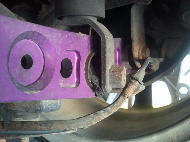

huge, it's tear out territory.
Back to LCAs.
Bushings are difficult to figure out for some reason, don't ask me why. Skunk2 had a terrible reputation for control arms up until they switched to subcontracting out bushings to ES.
This is a 1 year old Blox LCA, just an example, they're basically all the same as bwr.

ouch...that bushing is demolished.
looks like im about to drop another 500 on the car.
at least i wont have to worry about those bushings. so all skunk 2 control arms have es bushings?

Re: my suspension setup
Yeah, all skunk2 and function 7 do.
Skunk2 also has free lifetime replacement if the bushings ever go bad, since failing control arm bushings seriously contributed to the junk2 nickname.
