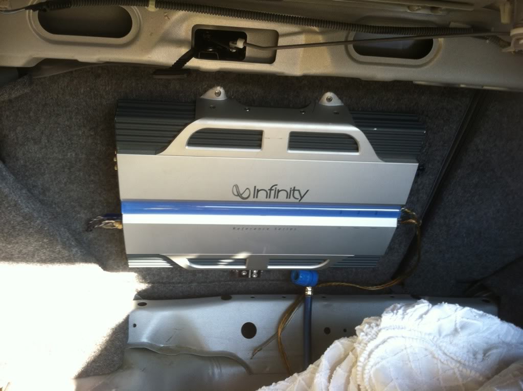

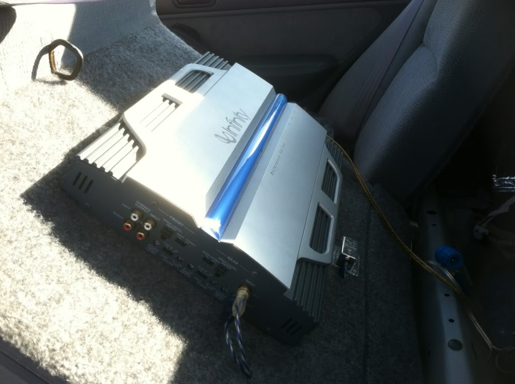

Most people mount them in the trunk on the back seat. If the amp is small you can mount it under the front seats but that is usually more difficult. You could mount it on the floor of the trunk but then you will loose cargo space.
Here is how mine is mounted:

Yea that's how the back of my seat is. You have to use self tapping sheet metal screws and secure it on the brace where you can. It's on there really well, its not going anywhere. It's also sits flat as it takes up enough room to go over the ridges.
